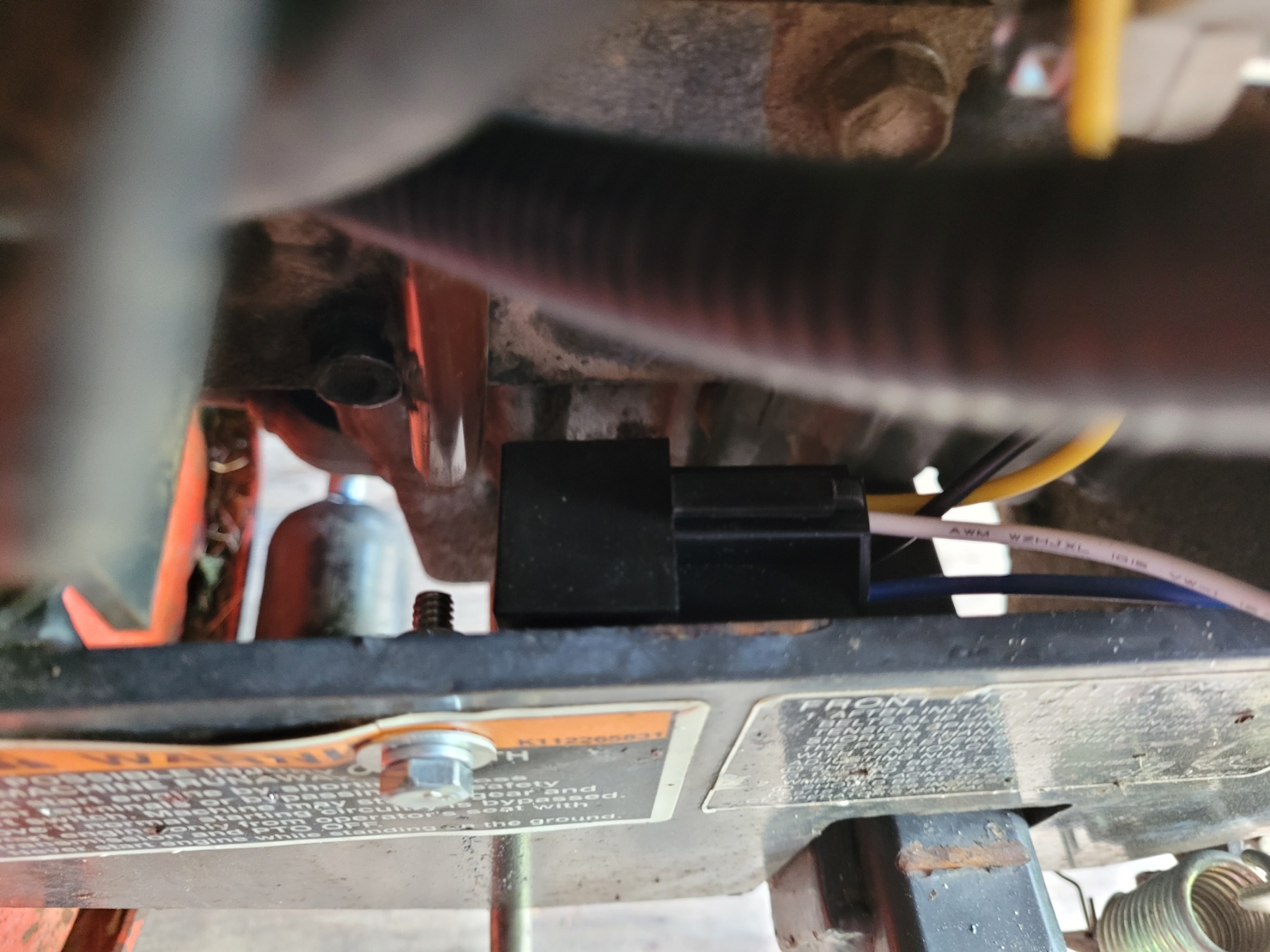

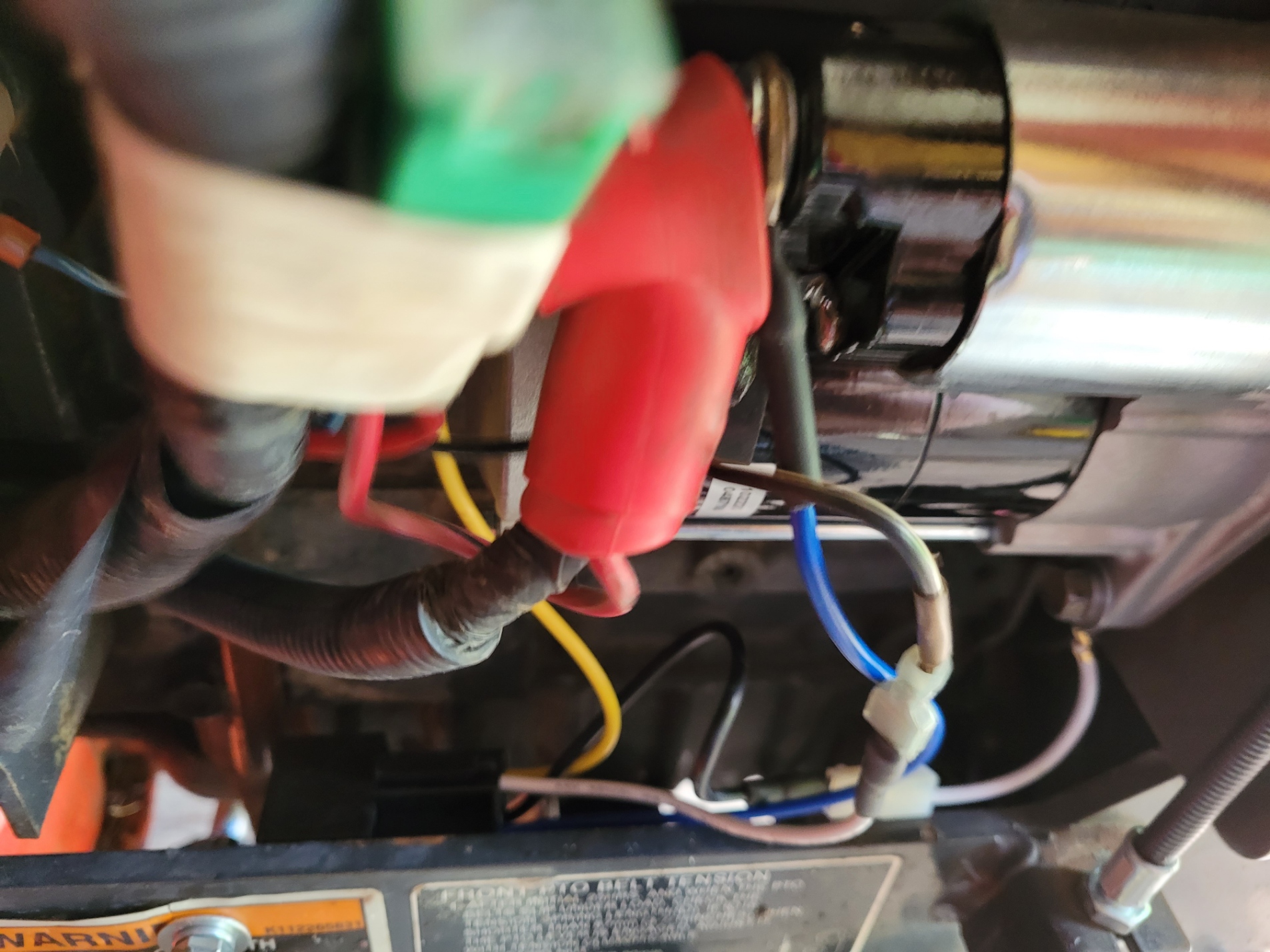

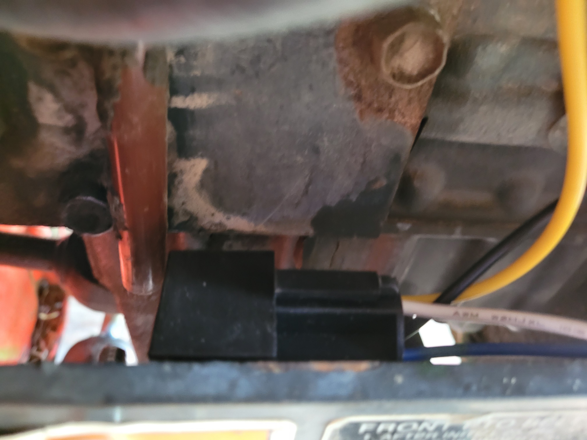

Look at my write up of the same issue on the same tractor. A "helper" relay solved all the issues and keeps all the safety gear intact and operational. Big question I have is why was a rebuild on the pump needed at such low hours?!

Thanks to our gummint trying to protect us from ourselves there are more switches in there than are needed (frankly if it were up to me there would be none). Honestly up until about 5 years ago I had an ooooolllllld Allis Chalmers B10 from the very early 60's. There wasn't a safety switch on it. And I taught both my girls from the time they could tiptoe to the clutch pedal how to operate it safely. No one ever once did anything wrong with it. And it never once "failed".
Every time you introduce another set of contacts into the circuit it's just another place voltage and current can disappear. Trying to track all that foolishness down will give you gray hair.
I simply added in a 30 amp relay (got a whole box of them on Amazon WITH wire harnesses and plugs) for $12 IIRC. I am going to install a new fuse block and add in auxiliary circuits as well and do it with the relays to reduce switching loads.
Even when the solenoid was getting full or very close to full voltage not enough current to fully engage the starter motor. A side benefit is the starter will work far more positively and less likely to cause partial gear engagement.

I'm sorry that is really sloppy work and totally amateurish. I didn't make a YouTube but if you looked at mine and didn't know, you would never know it wasn't factory OEM. Plus there is no "if it doesn't work" and it does not bypass safety stuff either. You turn the key it works. Every time. No guess work

Looks great on you setup, lmichael!
I found an old relay, and rigged the same harness. Will put it on the tractor this weekend.
The relay I found is: Panasonic ca1a-dc12v-n aca1213. I don't have a voltage generator, so I put a 9V battery on it, and it clicked. With 4 AA battery (6.45V), it clicked as well. Since my G2160 generates 7.7V when fails to start, this should fix the problem.

You either are not even getting the EXTEMEMELY small amount of voltage/current to trip the relay, and it that case I would do some SERIOUS trouble shooting, or you bought the wrong type of relay. The ones I bought can trip with VERY little voltage/current. Try with the ones I bought

So I got the new setup installed on my G2160 today. Works like a charm! No more issues of starting :cool:
