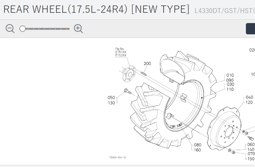

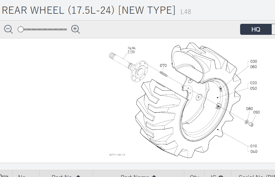

You also don't even have the right rims for Ag use.
These are you what you have:
These are what you should have:

Why even ask for help if you not going to believe it? :rolleyes:
You're going to break parts if you get it wrong, period!

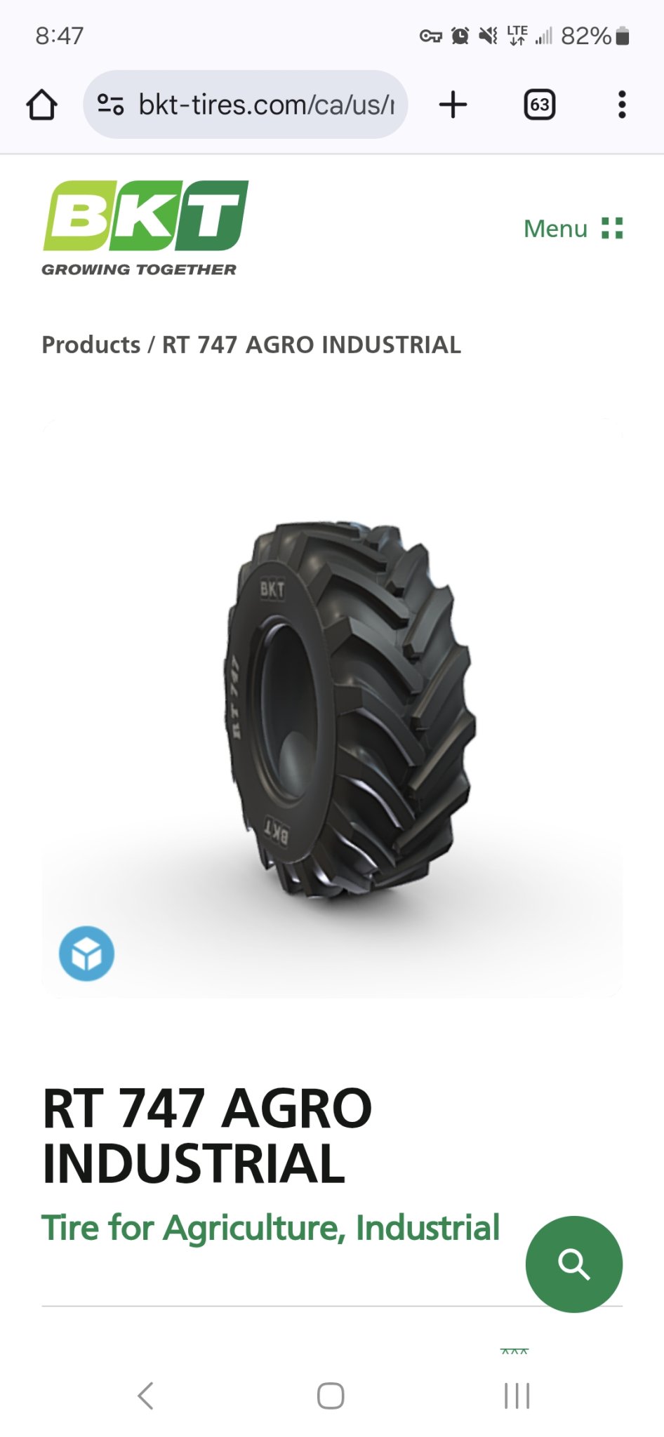

Okay after doing a bit more research, I found an oem spec r1 ag tire.
Goodyear Road Crew R1. Comes in oem spec with the proper load capacity.
As for use case, I was originally looking for a basic loader tractor for farm ag work. Happened to win the L48 at auction for a steal. Didn't plan on getting a backhoe but why not! The back hoe will be off the machine 99% of the time. I was hoping to run an ag tire.
Thanks for looking up the parts. I'm hoping there is an r1 that will fit the original rims.
