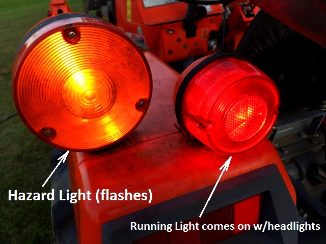

IF you have an Open Station version (no cab) then it should have fender mounted hazard lights.
They will be big, yellow, round lights. IF you don't have those mounted on each fender then look on the fender for indications of where they should have been (holes for mounting, wiring under each fender).
It sounds to me as if you are expecting your 'tail-lights' to operate as hazard lights....when in reality you have no hazard lights.
Fender mounted hazard lights will look similar to below (example is from my tractor, but the same across the board).
