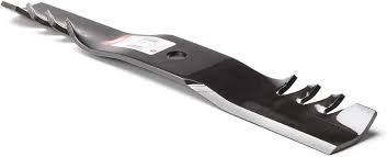

Has anyone tried the Kubota mulching kit on there mmm?
Yes. I put them on my RCK60 deck.
First attempt was with the Q'doba mulching blades. Unsatisfactory.
Second attempt was with the G6 blades. Better but it spit the fines out in front of the deck. I had clibbins infesting the rad screen and collecting between the muffler and the grille.
Mulching baffles now occupy one corner of the shop.
I can now cut grass at 2500rpm as opposed to 3200rpm.
