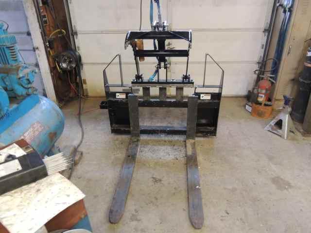

Has anyone used one of these grapples with Pallet Forks? Is the guard on the forks going to properly support one of these thumbs?

I started a thread about this here: https://www.tractorbynet.com/forums/attachments/408114-thumb.html
I am going to modify/reinforce the top guard on my forks to accept the grapple mount.

I got a Greens Machine 36" grapple thumb on the way and I just completed install of my diverter valve (what greens suggested for budget)
Well electrics not hooked up yet but working on that today.
I tapped into my curl circuit.
Hoses on right are from valve body, got the right fittings so I didnt have to alter the hoses.
Hoses on left are new and connect to the metal pipes on the boom arm
Hoses coming out middle are new and run to the front with quick connects to hook into thumb.
I got SAE8 to JIC8 fittings for diverter to match what was already on the tractor.
The diverter valve is mounted to a plate that I welded to the loader upright.

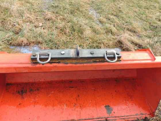

I got one and made mounts for my bucket and my forks. 4 bolts and two quick-connects and I can swap it between them.
I also made an adapter plate so when I'm not using the thumb, I have a set of chain/strap hooks for the bucket.
