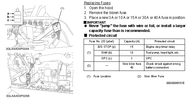

Likely the 15A stop timer relay fuse. Maybe the wire is broken or the contactsarecorroded. Or, you may have a shorted wire somewhere that is causing the fuse to blow. (At least I did when I had the same issue.)

Well I did notice the P.O. had installed a 20 amp in place of the 15 amp and a 5amp in place of the
of the 3 amp. everything was working Fine until a (elect) No start occurred. I replaced the Positive
and negative battery cables & that was cured. But now stop solenoid is inoperable.

UPDATE, This is Bizarre !! So, frustrated I pulled the wiring harness, every Module, Relay, Timer,
Fuse Block. Checked every Connection I could Find. Using a simple light tester. Probed anything
Electrical. Black and yellow wire that feeds the shut-off Solenoid (no power), then the Engine
Stop Timer (no power), then the Ignition switch. Finally the fuse Box. All the fuses had Higher value
than original. Off to parts store. Installed proper Amp. fuses. Then, the wiring to the fuse box. about 3 inches up the harness was a yellow taped red wire with a round burned terminal outside the loom. Tested but no power. I made a jumper wire to the stop solenoid w/12v it cycled. Checked the Timer Relay. The
black/yellow wire had power. The Kubota Cranked right up and SHUT OFF with the Key. Tried 6-8
Times. Worked like a Charm. Now, You Tell Me !! Proper Fuse Size ?? What was the Extra Red wire
with the round Terminal? A Diode?? Anyways, This Forum "ROCKS" !!! Thanks Again !
