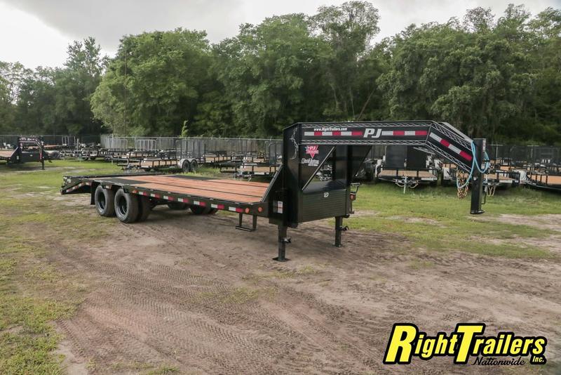

I've got a 20' equipment trailer (14k rated) - with the fenders. It's a pretty stout model made by a local company that I bought to carry my tractors and old trucks on.
Recently came across a situation that I needed to carry a larger tractor than could fit between the fenders (74" between fenders), so my only other option is to get a deckover. If I'm going deckover, might as well get a gooseneck model.
Any comments on owning/operating a gooseneck trailer? Will pull behind a GMC 2500HD Duramax crew cab single wheel 4x4.
Something like this is what I have in mind.

I have a gooseneck stock trailer and I much prefer it over a bumper pull, especially for heavy loads. They are easier to back and more stable on the highway because the pivot point is above the truck axles. You have the correct truck for a gooseneck, so go for it. The only downside I see is higher cost. Get a nice fold down hide a ball in your truck bed and you’re good to go.

GO FOR IT !
Once you have owned a gooseneck, you will NEVER go back to bumper pull!

I’ve loaded vehicles/equipment on trailers that were wider than the fenders. Just had some 2x6 or 2x8’s, whichever the height of the deck to top of the fender measurement is, the total length of the fender to support the weight. Assuming the fenders are fairly stout to begin with.
But it you have the cash a dual tandem hydraulic dovetail 32’ would be my pick.

Gooseneck is the only way to go for any significant load. There is no “tail wagging the dog” which bumper pulls can easily move your truck around if loaded wrong.

Once you have a gooseneck you won't want to go back to bumper pull. Make sure you get what some call the skid steer ramps. They are complete easy fold over ramp that makes the complete back of the trailer a ramp when folded down. Dual wheels are nice. That will be the last trailer you will buy. If you have big money those hyd beaver tail deck overs are nice.

Before you buy anything check with whom ever you have your auto insurance with to make sure there are no problems in the personal vs commercial aspect of your insurance.
Second take a look at the tow rating of your truck as it is built. Do not go by the BS on the internet and look up the rating in your Owner's Manual. What is the maximum weight of your truck (GVWR) minus the weight of your truck with fuel, toolbox, and people in it? The answer gives you the weight of the trailer and payload you can haul. Subtract the weight of the trailer from the total to check your payload capacity.
I would guess the trailer that you posted is too heavy for your truck with a load on it. When I started hauling freight I needed to stay under 26,001 pounds. I now run an 07 GMC 3500 with a GVWR of 11,400 pounds. The trailer is a Big Tex, which I hate, with a derated sticker of 14,500 pounds, the factory sticker is over 15,000 pounds.. This setup weighs right at 15,000 which gives me a pay load of 10,900 pounds.
All this to say your 2500 plus a 30 ft gooseneck with two 7,000 axles will make a good combination. You will be under 26,001 pounds and be under CDL weight.
The only drawback to a gooseneck is when you turn the trailer will cut the corner where a bumper pull will follow the tracks of the truck better.
