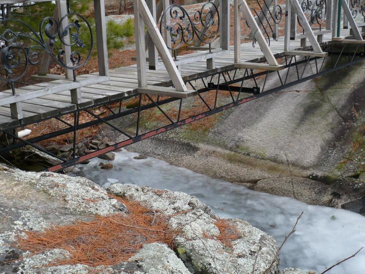

A number of yeas ago I wanted / needed to build a bridge over a deep gully.
I fussed a bit over the design, but I eventually found a manufacturer of steel roof trusses that are used in industrial buildings.
I needed what I thought was about a 30 ft span.
When I called the guy, he quoted $1100. - ouch.
But then he asked - does HAVE to be 30 ft? How about 27 1/2 ft?
He had supplied a customer a couple of years before with these trusses, but the customer over-ordered - told the guy he'd pay him - but PLEASE do NOT bring them to site - he'd have a devil of a time getting them out.
OK, I said - how much?
150 bucks - delivered !
These trusses will hold over 2 tons - they are 16 inches high. The abutments were square steel tubing bolted into the rock. In you case you may have to pour concrete.
The decking was 2x6 pressure treated bolted to the trusses - the width of the deck was 42 inches to prevent idiots on snow mobiles racing over the bridge in the winter.
So, my suggestion . think about your design, - look for some innovative way of doing it.
You'll have fun building it - we ( my wife and I) did all of the work.
Miro
