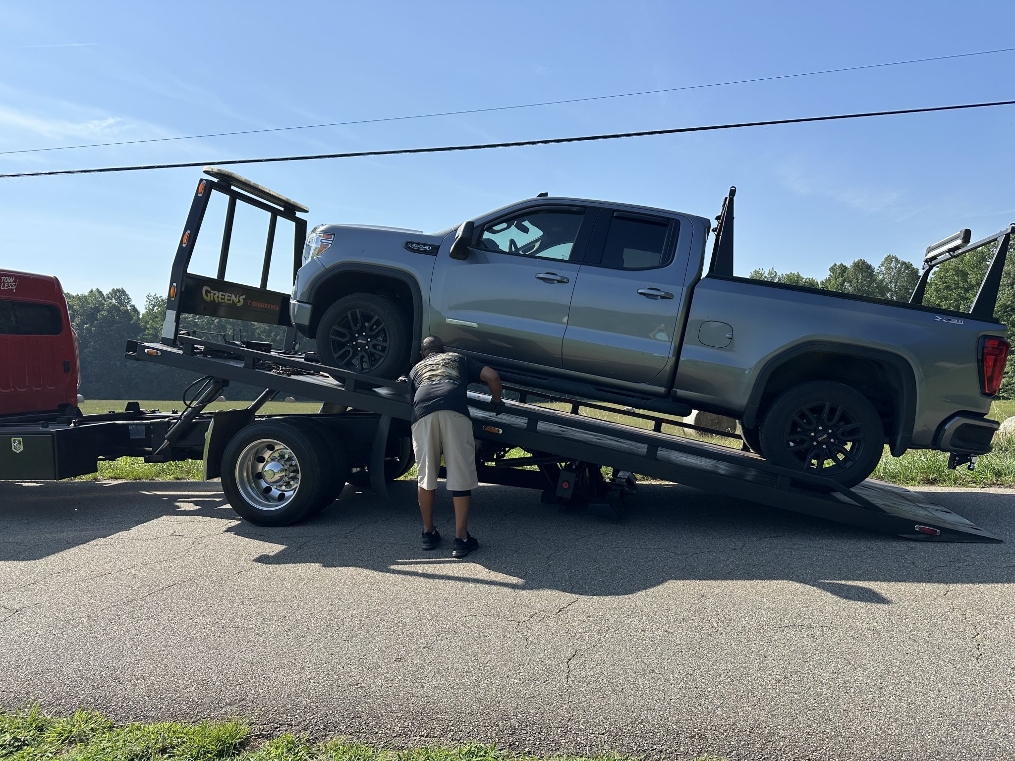

Any of you fellow OTT folks had the dreaded valve body/solenoid failure on your 10 speed transmissions? I was heading back from a week of vacation with family and dog with a truck full of gear and about 2hrs from home in a very busy place, the trannny went to hell and into limp mode. I finally got it to a safer place and then discovered I could limp home with no reverse by limiting it to 6th gear and staying at 50 or slower. Had it towed to the dealer Tuesday and they said it will be at least a week before they can get the parts but I am starting to think that was a canned answer as looking online this appears to be a significant issue for GM with people reporting weeks to months getting parts for both the regular and even the HD Allison transmissions. Three years old and only 45k miles so it will be covered under the powertrain warranty and they are still trying to get me a loaner/rental.
