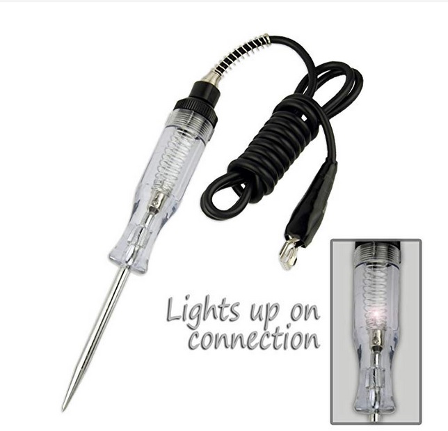

I am just surmising as the light is constantly on. It just as easily is the controller.
I was told by many to not worry about the light being on constantly. Nowhere in the manuals does it say to service the glow plugs themselves. I bought it used with 1750 hours.
You don't want to just ignore symptoms that may be telling you important info.
At the very least, verify the GP's are not being powered regardless of the light being on.
A 12 volt test light for $15 can easily tell you this.
Connect the test lamp alligator clip to the battery negative and touch each GP with the test light tip. If as you think all is well the test light will not turn on.
Your choice to repair the controller or relay.
Dave
