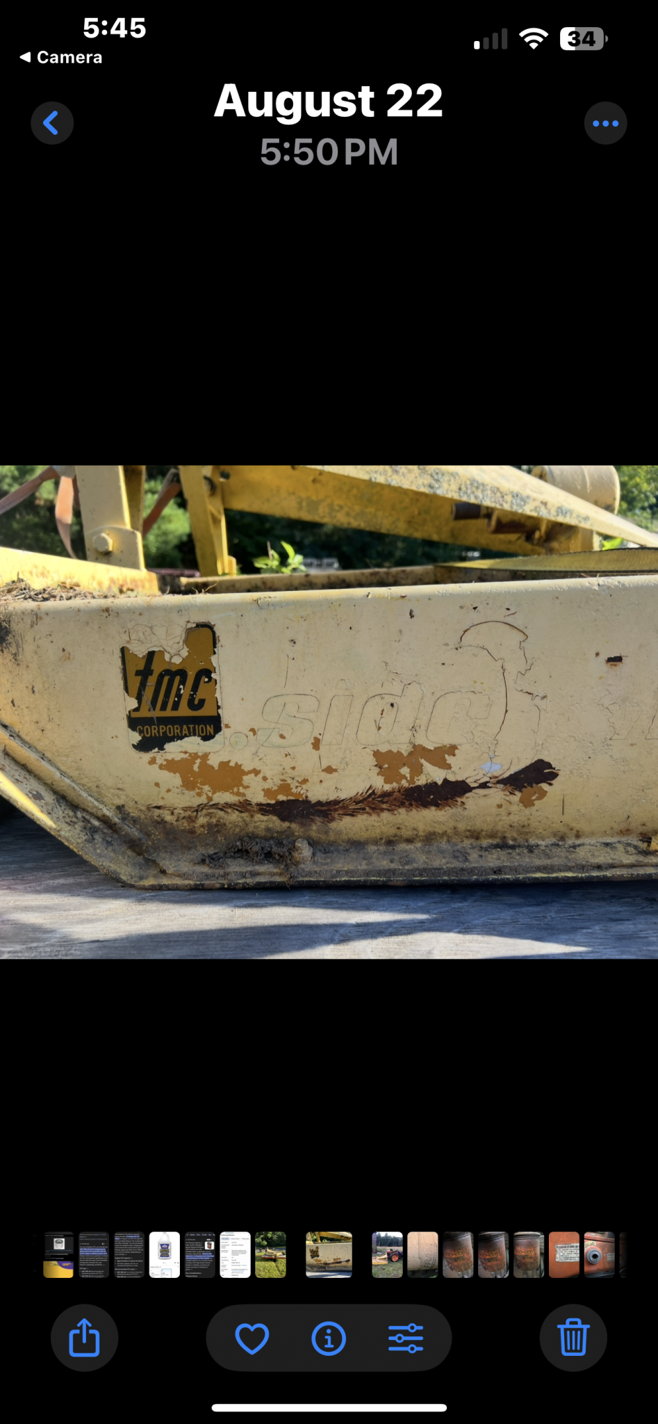

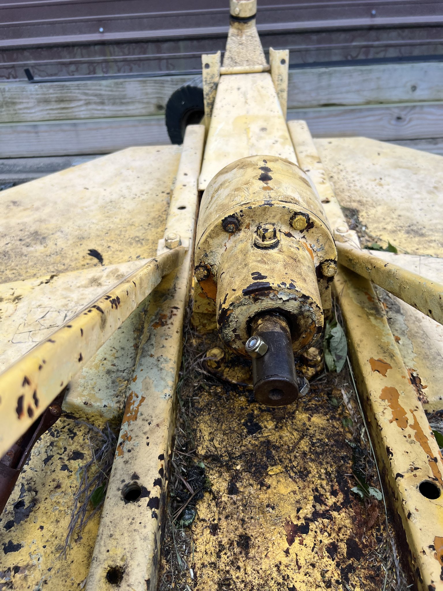

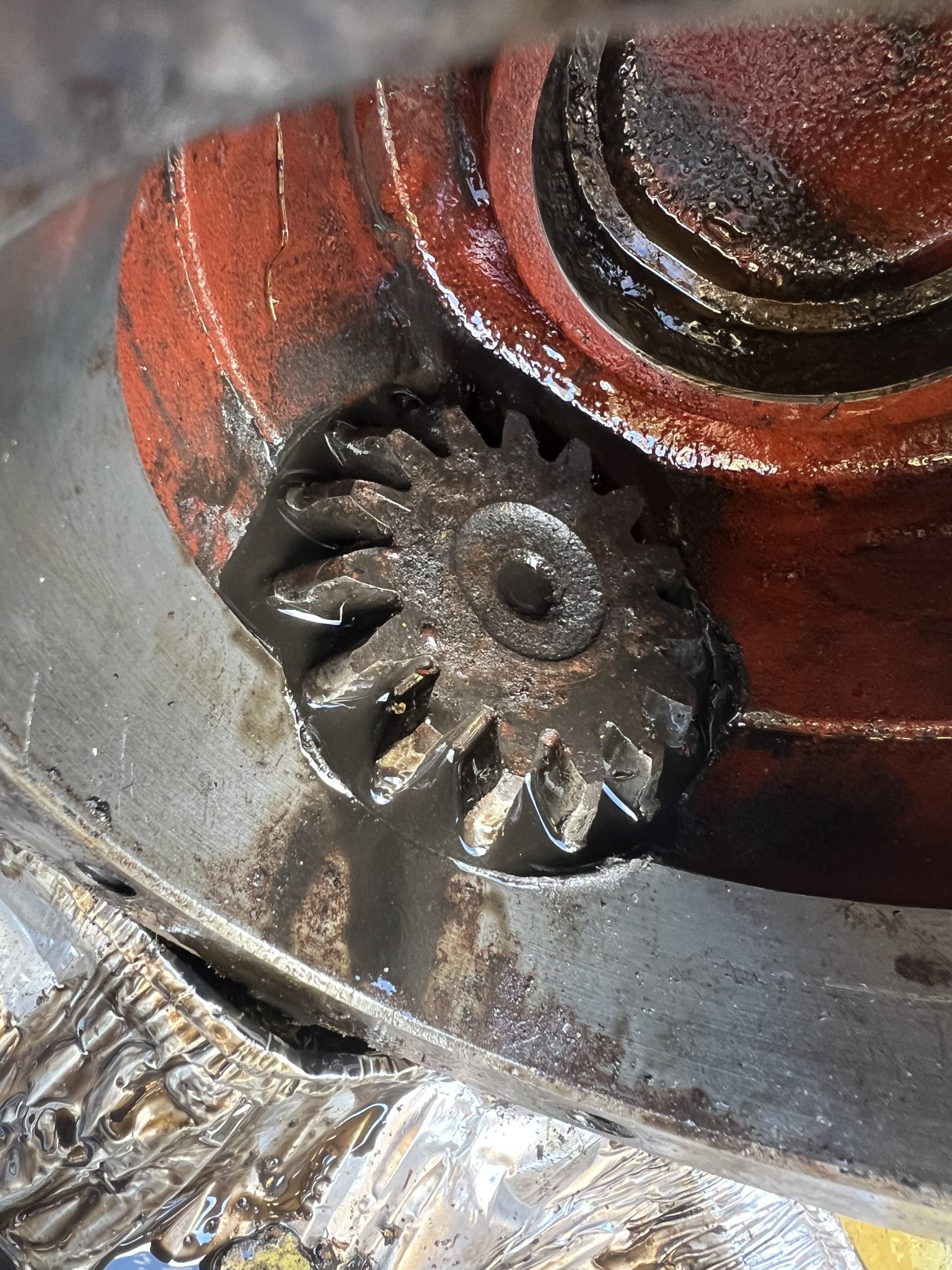

I’m looking for Parts to rebuild what I believe to be an FMC sidewinder.. i’ll attach some photos. I wish I took better ones when I had it apart.
what I found interesting is the horizontal shaft is just a shaft with a gear on it. It doesn’t look like the other ones I’ve seen on YouTube for rebuilds that has a shaft that goes all the way to the other side of the housing and goes in a bearing.
I got it for free and I didn’t make it very far before it failed. I didn’t hit anything. I put oil in it before I started. It appeared to have some grease in it but when I drained it, there wasn’t. My guess would be as they stopped using this tractor because their plow head broke and this brush hog was pretty much dead..
it raddled horribly on start up.. but then it’s moved out and I did start and stop a few times. Everything seemed fine.

I would say it's salvageable, but the gear teeth are a long way from "new condition". You can clean and dry the gears, then using a hand grinder knock the high spots off the edges of the teeth and they will probably survive a few more acres. Take the hog nose apart and see what the hidden parts of the shaft and the outer bearing race bores look like. Then try shaking the blade holder (stump jumper if it has one) and see how tight the bottom shaft is. If that's all sloppy loose too, then it's decision time and the hard part begins. If that feels solid enough you may be able to run it as is, just using a heavy grease/gear oil mix. At that point you're only into it the cost of bearings and seals, which will be standard, off the shelf, bearing house items.

I like that answer. Is there any way to shim the horizontal shaft further into the vertical shaft to gain more engagement? I’ve never worked on these. I’m not completely inexperienced with gears and hack jobs.

The current shaft on the gearbox has a 7/16 shear pin. Can I just buy this and drill out the 7/16 hole on my driveshaft to half inch? I’m worried about damaging my tractor.

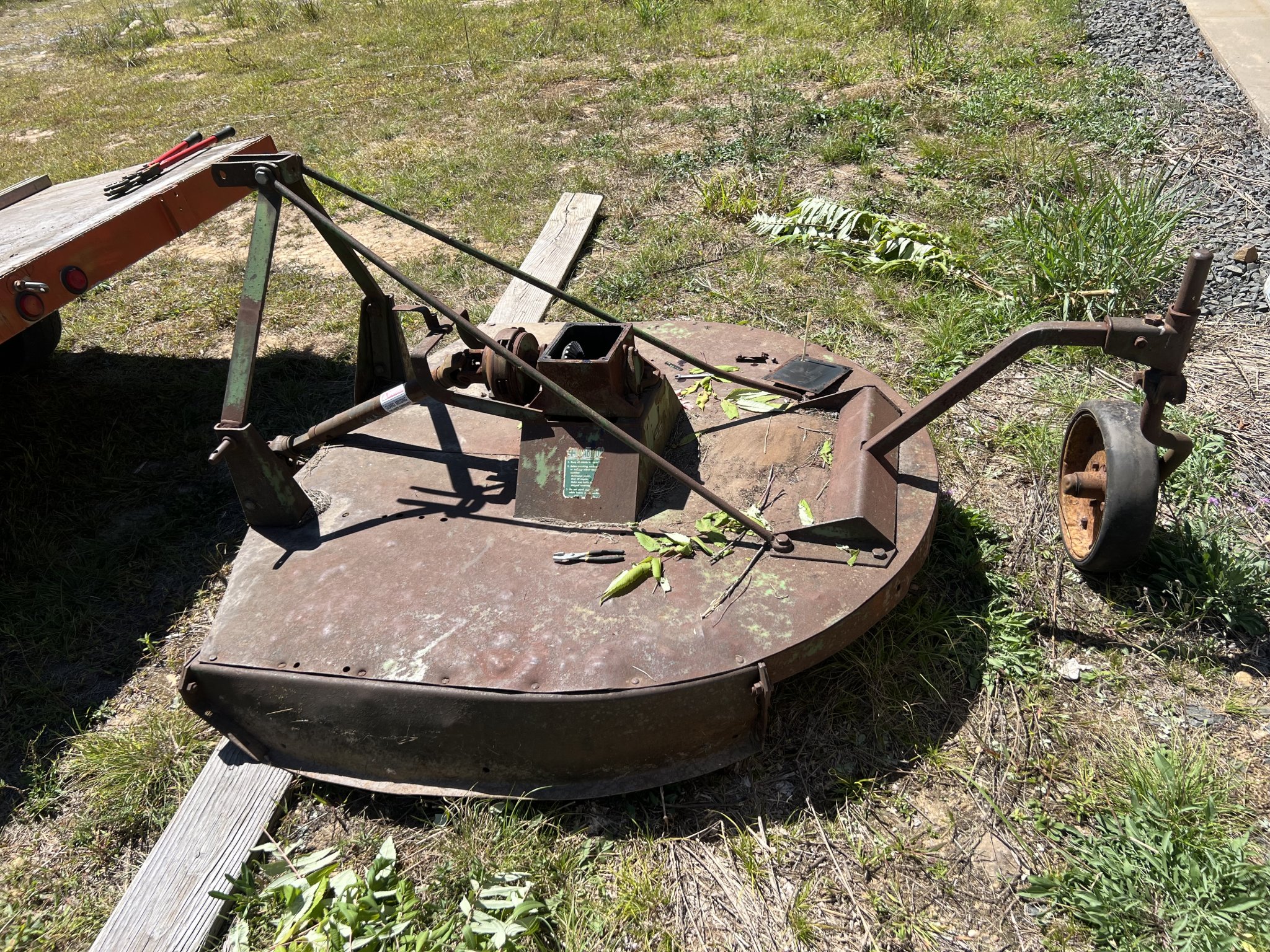

I picked up another free brush hog..it didn’t turn but everything looked promising.. I inspected everything and then got it freed up. It’s pretty much ready to go with the exception of now the driveline for that one I can’t get long enough it’s seized. I greased it up real good and sprayed it down and applied some heat try a few methods. It’s stuck pretty good. i’m gonna let it marinate for a little bit and try again if that doesn’t work I’m gonna locate an unmovable object pull on it with my 13,000 pound backhoe. i’m gonna have to remove it from the brush hog to do that. I hope it’s not stuck there too.
other than that, the gears and bearings in it looked great. I just need to locate a top gasket or some RTV to seal it back up after I change the oil and try to find some kind of replacement dipstick..: after that I have to loosen the clutch on this one until it slips and then re-tighten I guess.
It does have two cracks in the mounting holes for the gearbox, but it’s extremely thick I’ll weld it at some point before I do a mass painting of rusty stuff.
