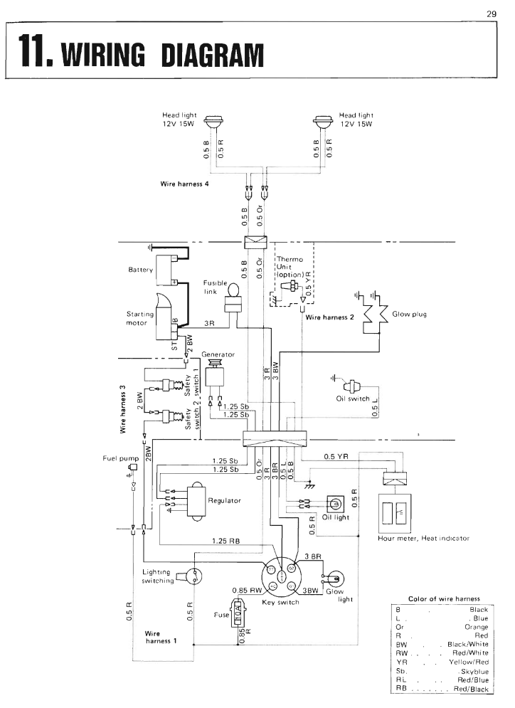

I'll look for the schematic, I think I saw it on line the other day.

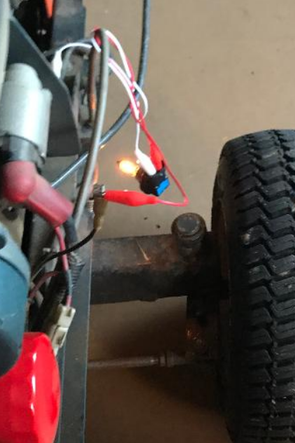

I'm wrong again, low power at the black/yellow.
This is a 12v headlamp, it just glows a bit with the key turned.
Also, jumped the the solenoid + to the smaller terminal, it cranks right over.

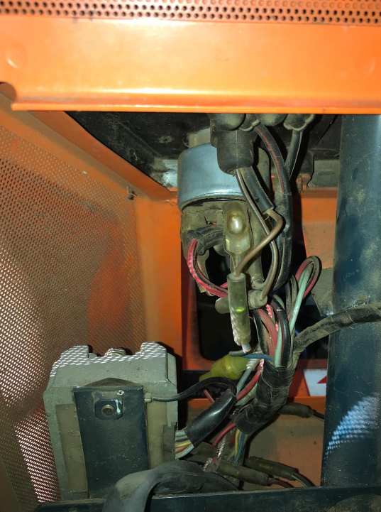

Popped off a cover and removed the battery to access the wiring.
It appears the key-switch is in the center of the these two low voltage problems: the glow plug heater/starter-solenoid.
I'd like to remove it and check it over but didn't get far with removing it, only the outer chrome ring.
Does anyone know how to remove the switch?
5,908
1,702
It looks like you have it ready to remove already. Is it possible to move the black plastic dash up away from the switch? I don’t think you have enough room to get the wiring off the back of the switch while it is in place. I think the wires are screwed to the switch, not slide on terminals.

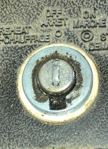

Yes so close to removing it, I just need to remove that ring, it will pull away and I can swap it out easily.
5,908
1,702
I believe that you will have to unscrew the ring on top from the switch. Use a pair of channel lock pliers to grab the OD of the ring. I think I can see threads on the switch in your picture.

No need to remove dash. Remove battery to access switch. A channel locks will work on the ring, but a spanner wrench is ideal. Alternatively screwdriver or punch with a few light taps of a hammer will do.
My switch has a dead spot on the solenoid contact. Its a sealed unit, so no repairing it. Replacing is on to-do list. I have been bypassing with push button on the solenoid terminal on starter.

The white Teflon ring is what is left holding your switch in the dash, a putty knife or small screwdriver will pop it off. That white ring is "Tougher than boiled owl!!"

Just FYI - My G5200 used to have some issues with starting. The starter-solenoid would 'click' but not engage the starter.
Long story short.... I determined that the two 'safety switches' (as seen in schematic in previous post) had resistance across them which was dropping the voltage. Hence, the voltage at the small terminal on starter-solenoid was insufficient when key was engaged.
I developed a PERMANENT fix for the problem by wiring in a a new relay. Now, the 'safety switches' only have to pick a small relay. This new relay is what supplies higher current which the starter-solenoid requires to work properly.
