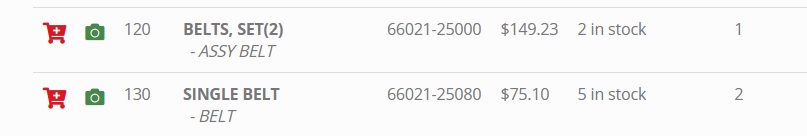

In looking up the Kubota belt(s) for the Owners tractor, Kubota sells individual and matched belts. Not certain how to interpret this re matched pairs issue.
