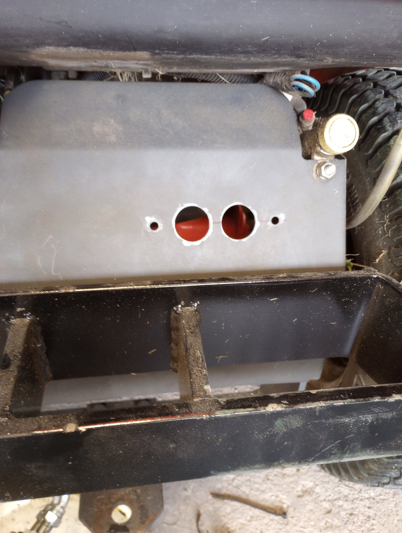

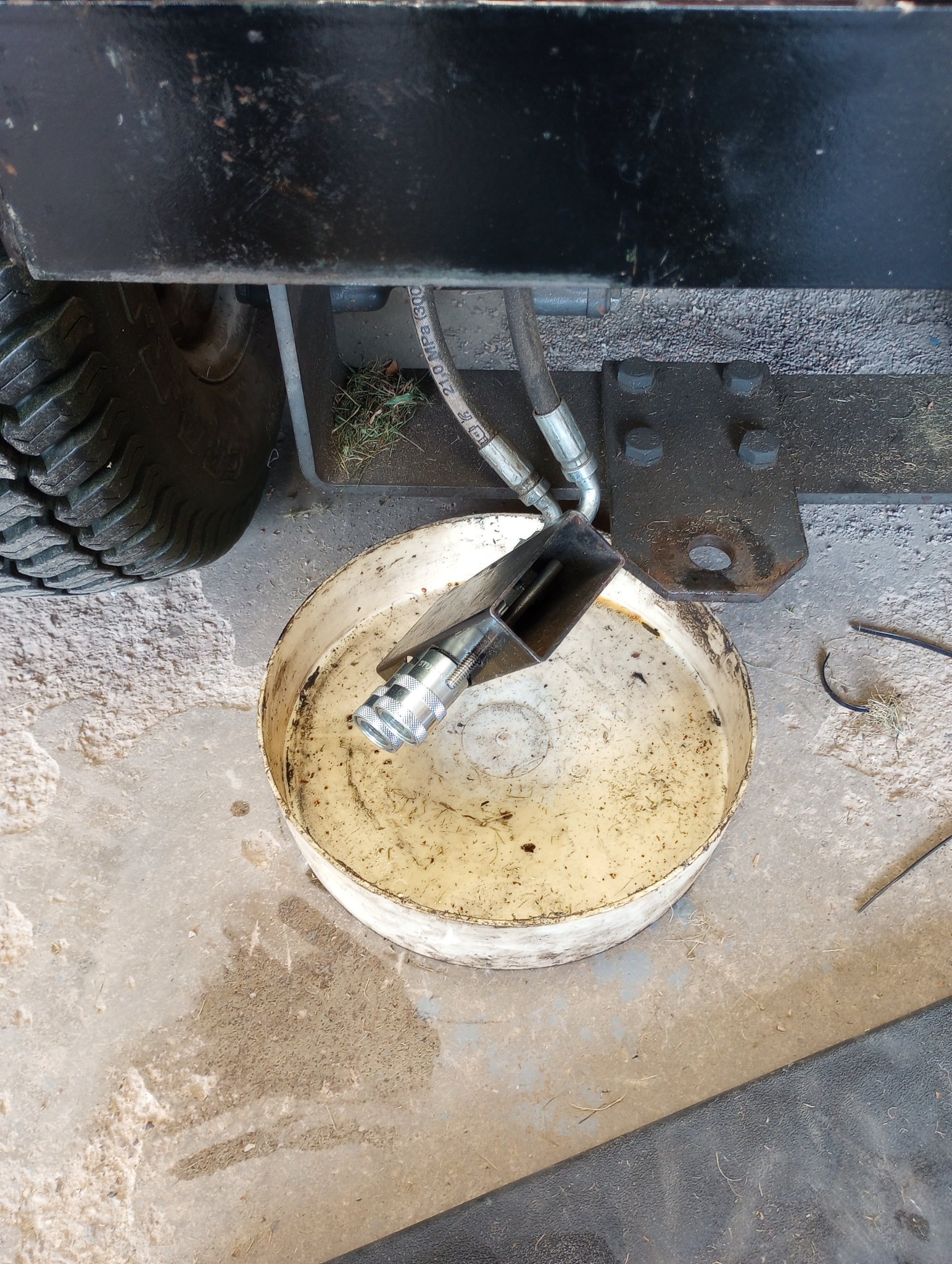

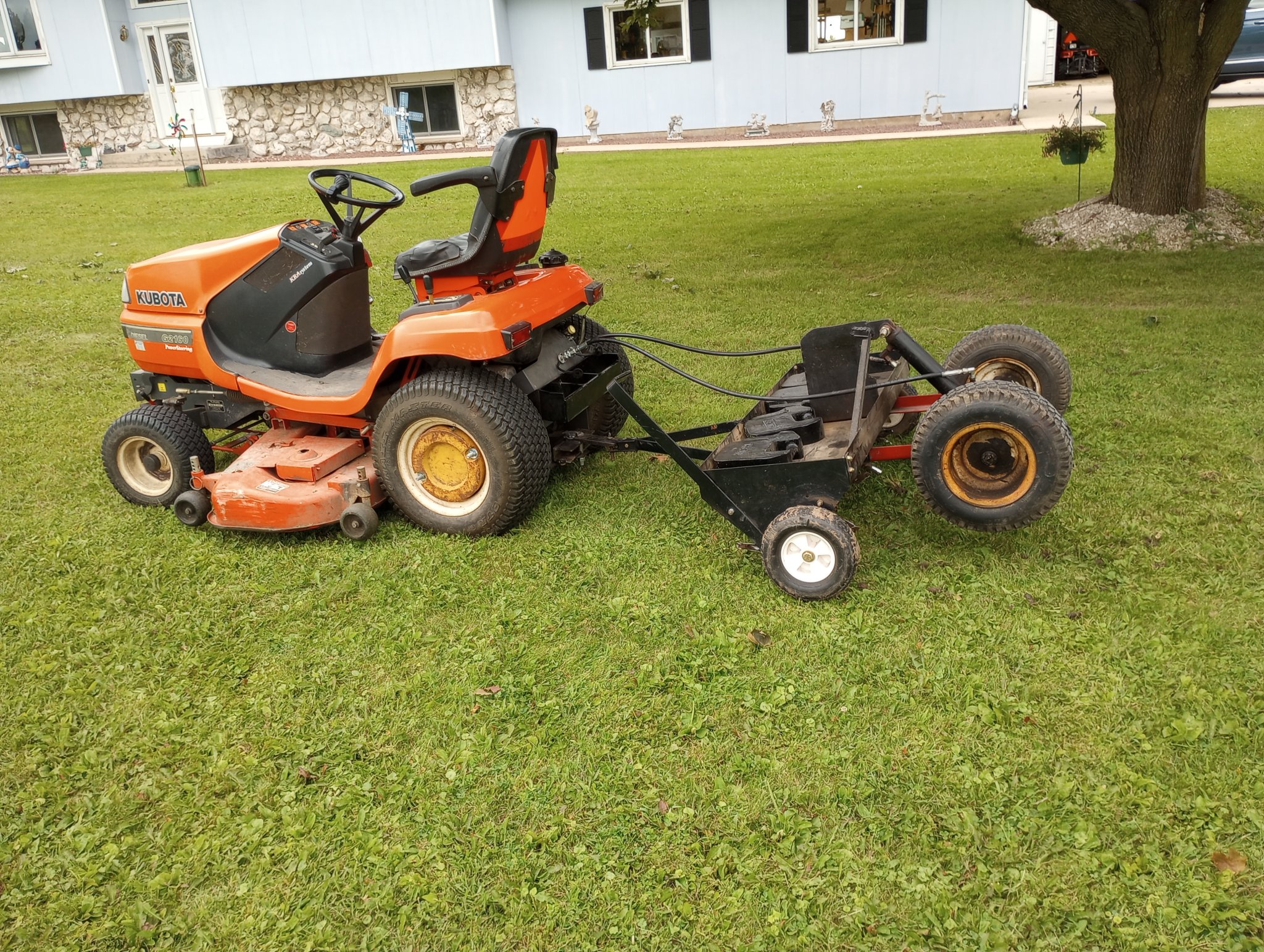

Well, I finally am able to use the 2nd valve for something on my G2160 that was the center discharge bagger. We have removed the bagger and got a regular 54" that works great. Had the valve for the dump of the bagger just looped. Well, now I can use my aerator on the G2160 as I have hydr lift on it. Got some couplers, a couple of longer hoses w/elbows and made a mount. It works great, looking forward to using this fall.

It was a G2160DS so it had the rear discharge deck w/the chute going up between the 2 rear wheels and the bagger that when you stroked the 2nd valve, it would dump the bagging system. We have taken that all off and replaced the deck (it was shot) w/a standard 54" side discharge deck, that is how this had the 2nd valve.
