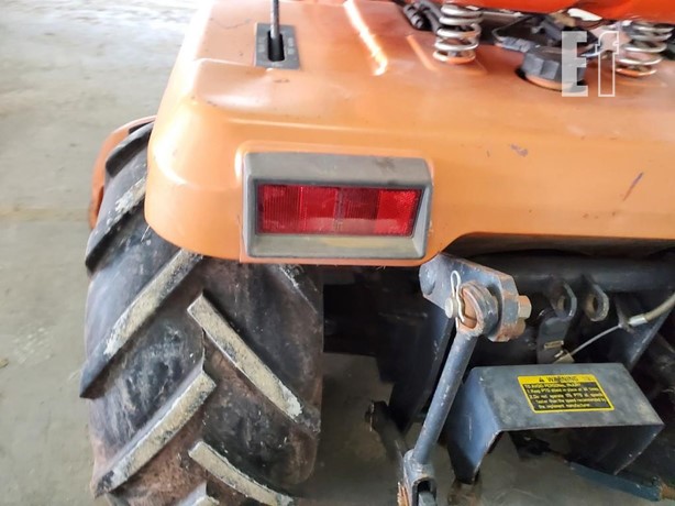

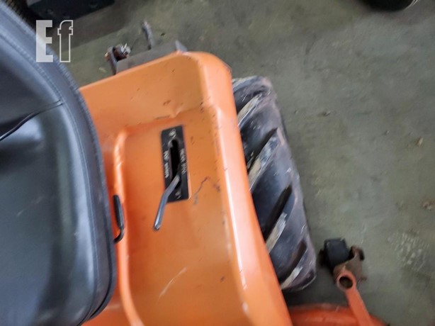

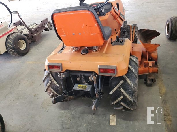

Can you post some pics of your rear PTO set up? Forgive me if you have already.
I have not installed it yet. But attached are pictures I found on the internet. The rear PTO must be rarer than the three point hitch, this is the only tractor I found on the internet that had it installed.
Rear PTO lever is actually on the left side of the seat, this was missing in the kit I bought, so have to make one myself. The engine drive shaft for the PTO comes out behind the auxiliary pump, there is a cover over it from the factory.
Problem with the Cat.0 PTO is that it runs at 2000rpm, whereas Cat.1 and above PTO speed is 540rpm. And the PTO spline is different to the other PTO drives on the tractor. There seem to be plenty of implements for Cat.0 available in the USA but in Europe it is virtually impossible to find anything. I still decided to stick to Cat.0 and the 2000rpm but that means I will have to do a lot of DIY.

Cool, Thanks for the pics. So is that driven from the front PTO or the small splines out of the rear of the tractor?
Hugo Habicht
G1900
Jun 24, 2024
536
706
Ireland
The rear PTO is a small gearbox bolted behind the differential that is driven from the splined shaft behind the auxiliary pump in the drive gearbox. This shaft is an extension of the wheel drive u-joint shaft coming from the engine. It has nothing to do with the mid or front PTO which are driven by the v-belts at the front of the engine.
