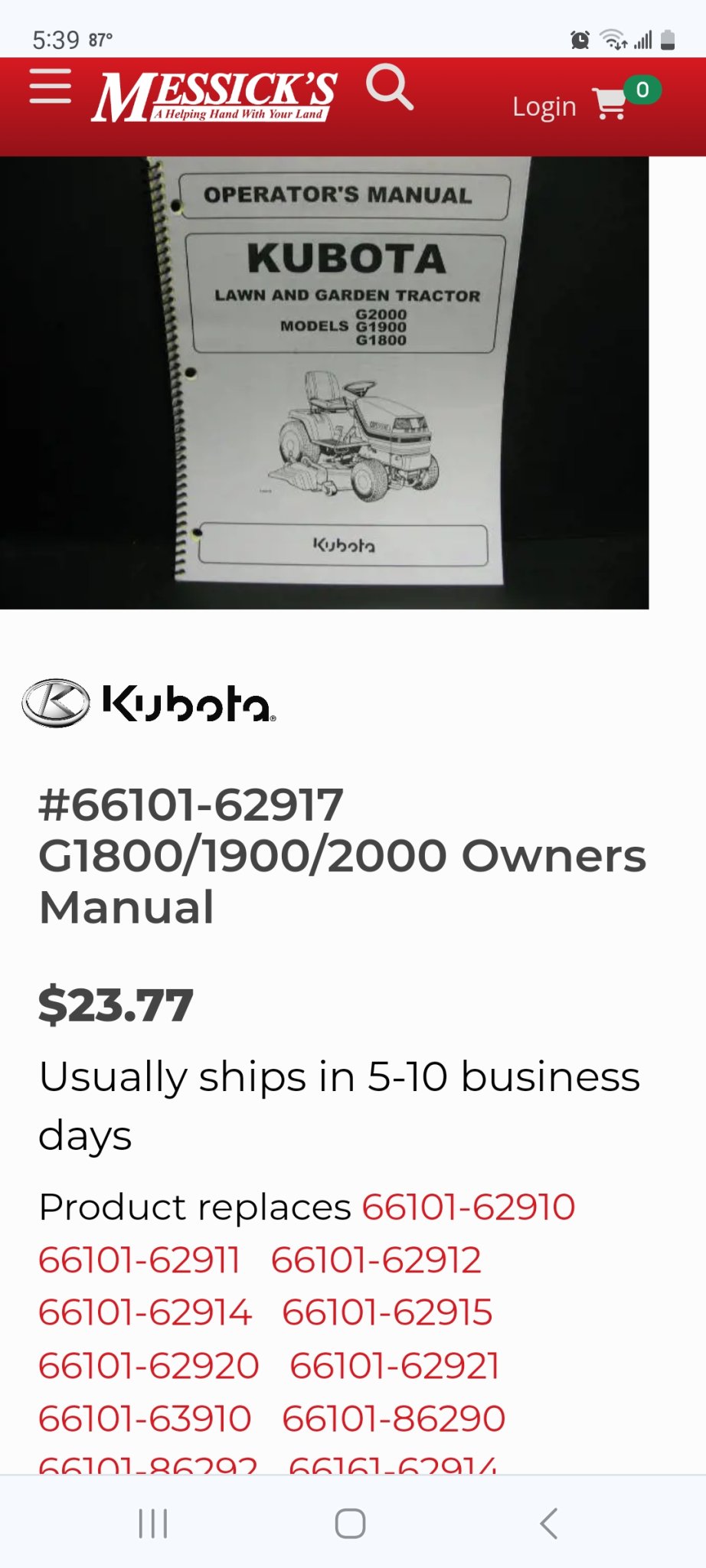

Start at kubota books. Com

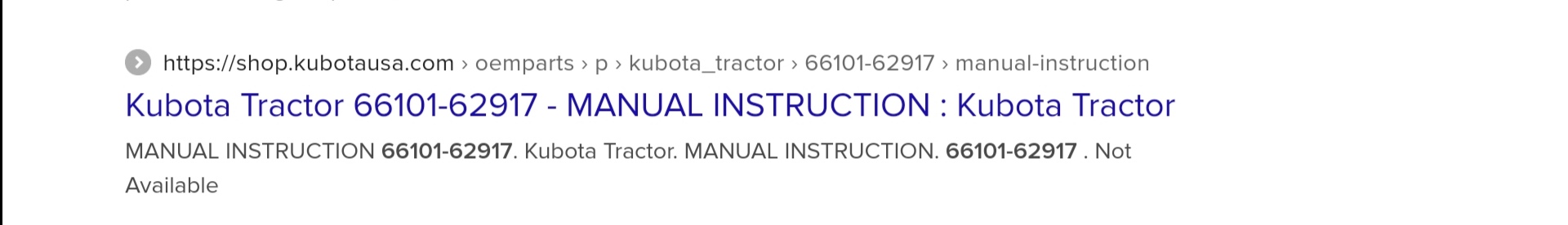

Hello Ktrim,
great, thank you very much, appreciated, really!
I came across Messick's looking for spare parts but it never dawned to me that they have the manual! Will order ot straight away.
Strangely enough their web site does not come up in an internet search, even using the right keywords. They probably do not pay protection money to Mr. Google :)

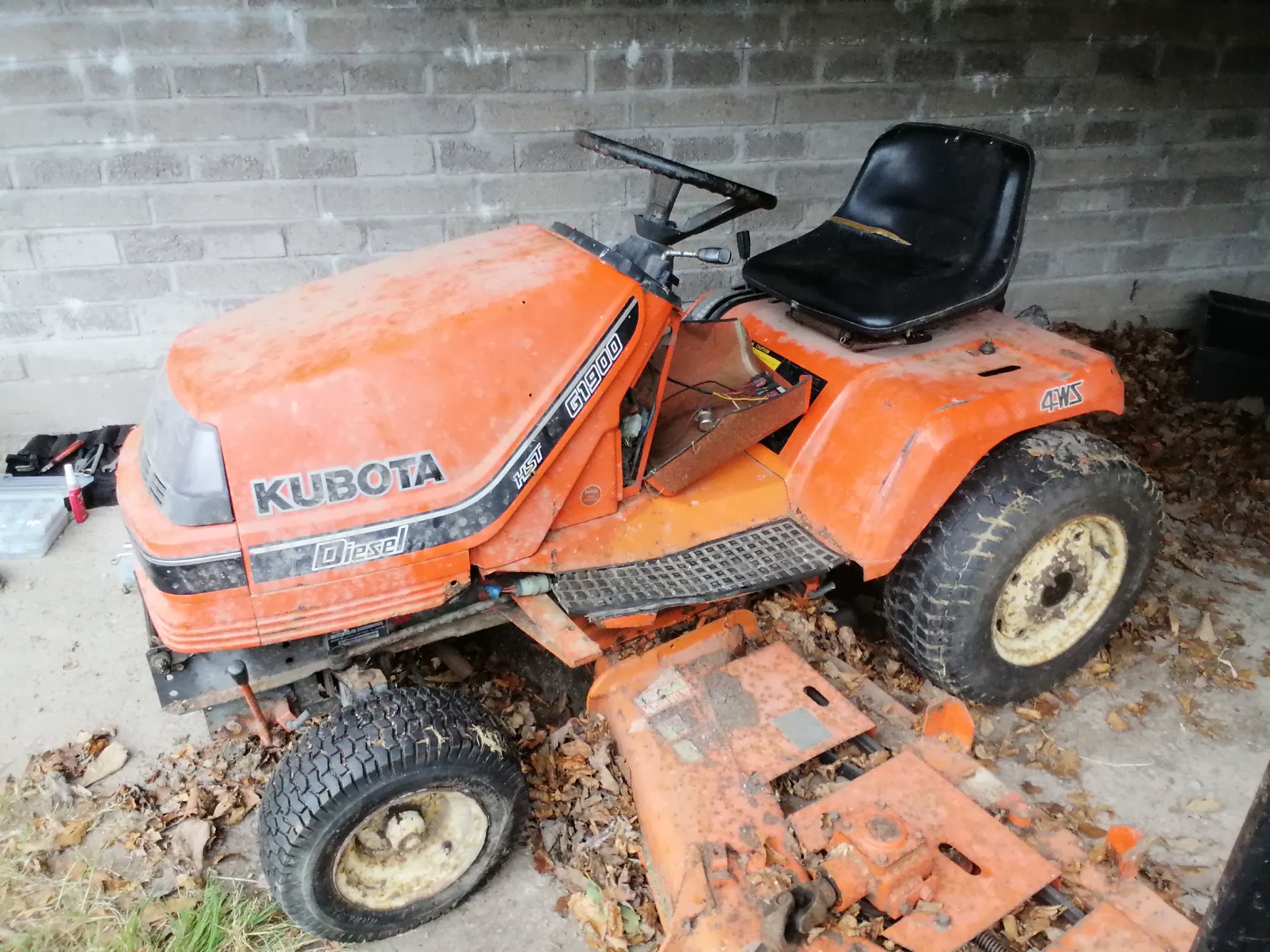

Hi 22R,
thank you very much for your offer. I'd say it is likely that I will take you up on it.
I have not had much time working on it but I got it running by short wiring the starter and it drives and it cuts the grass. The starter switch should arrive today, so hopefully I can tackle the electrics first.
Then the next obvious problem is the 360 degree (!) play in the steering. The ball joints are all lose, but not in the joint itself but the tapered seats are worn out beyond recognition. One rear wheel has 1/2 inch play when you push it sideways. It probably has not seen a grease gun for a while. I have never seen such a neglected machine and everybody says I should scrap it, which is, considering everything objectively, sound advice. That's why I started repairing it. :)
Kind regards,
Hugo

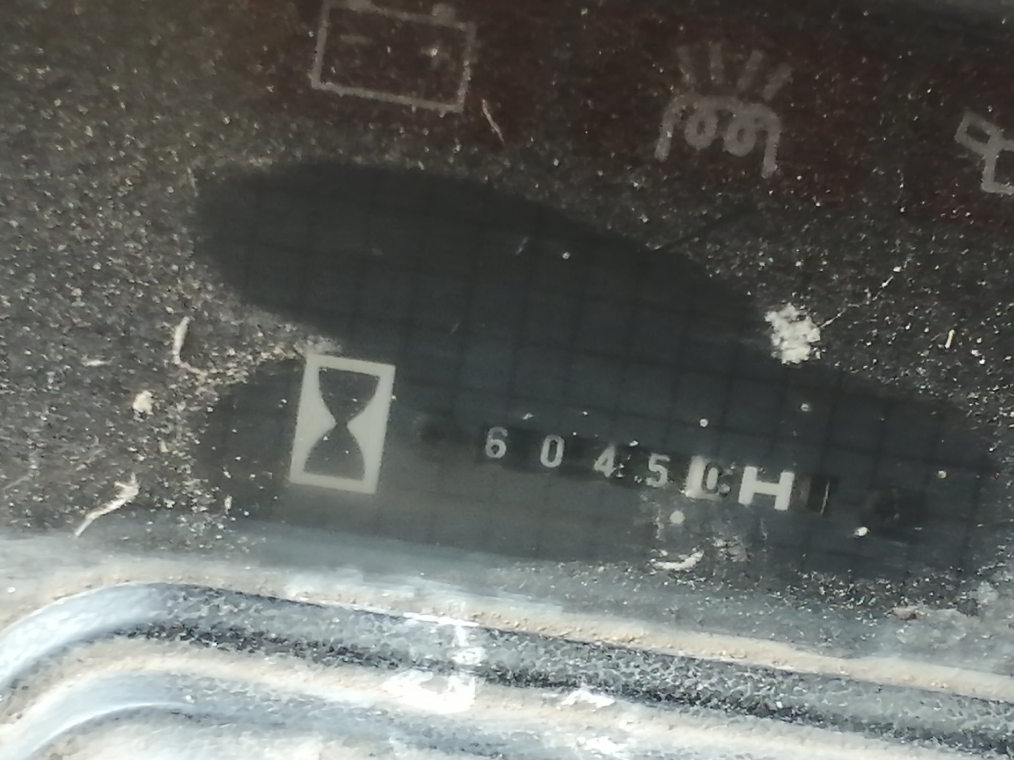

p.s.: mine has over 6000 hours :oops:
22R
Feb 29, 2020
81
25
GONZALES, La
Wow 6000 hrs. That is amazing. The good thing is you can still get a lot of Kubota parts for these machines the bad thing is Kubota parts are very expensive:(. Pace yourself and enjoy.
Post some pics when you can.
22R
Hugo Habicht
G1900
Jun 24, 2024
579
778
Ireland

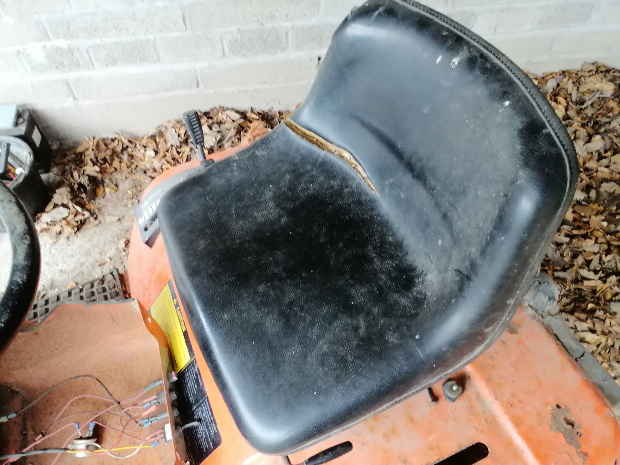

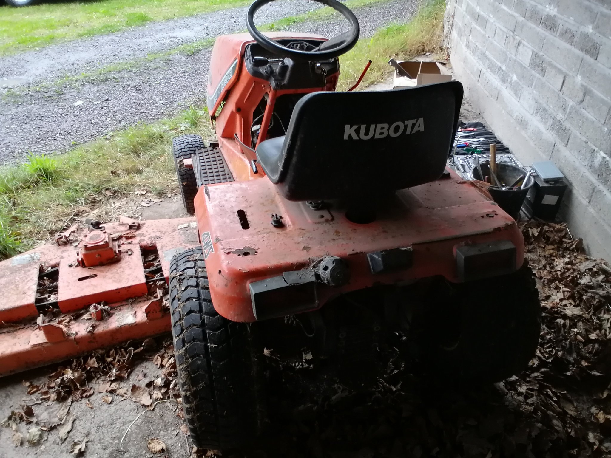

Soooo....

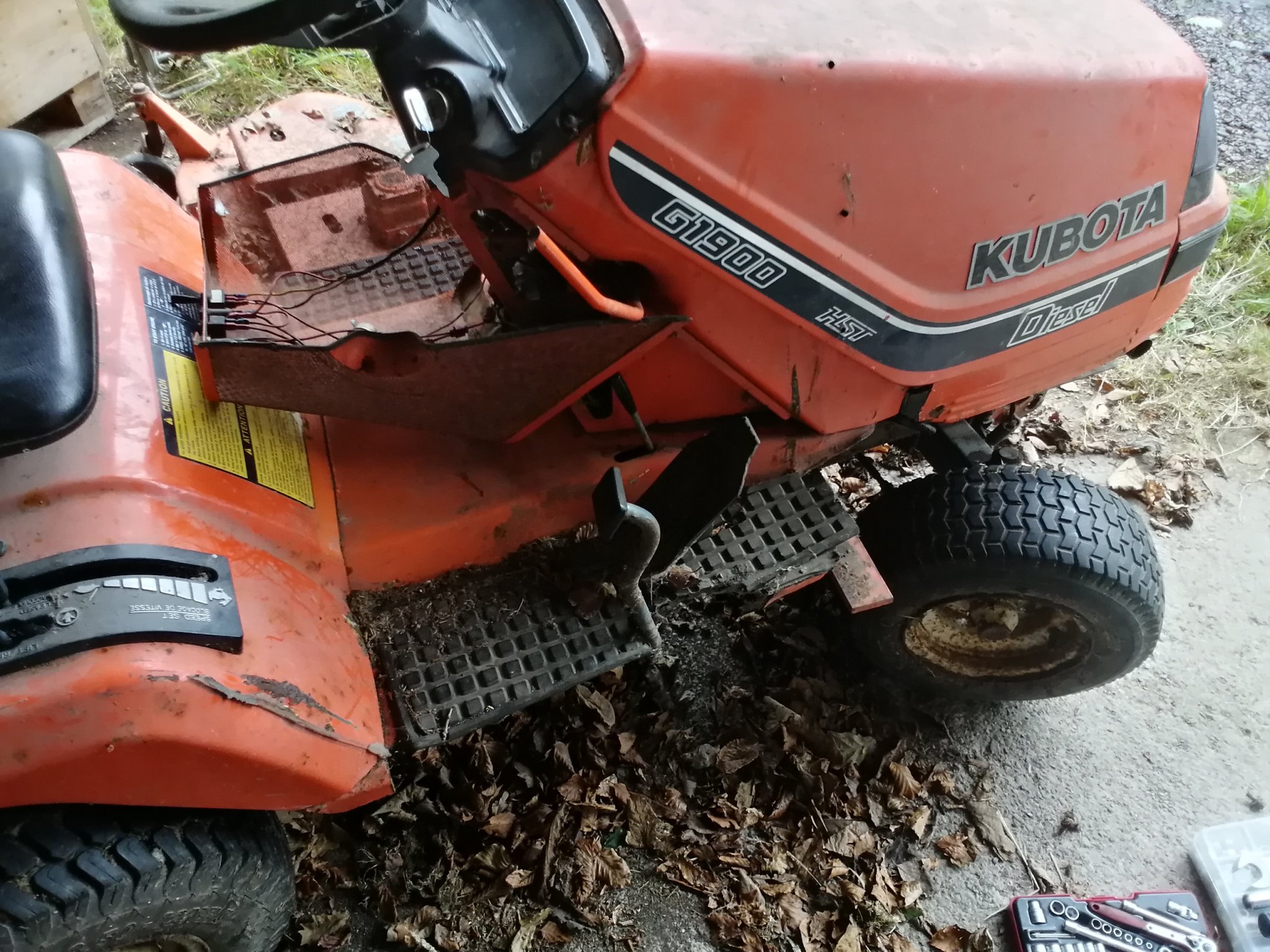

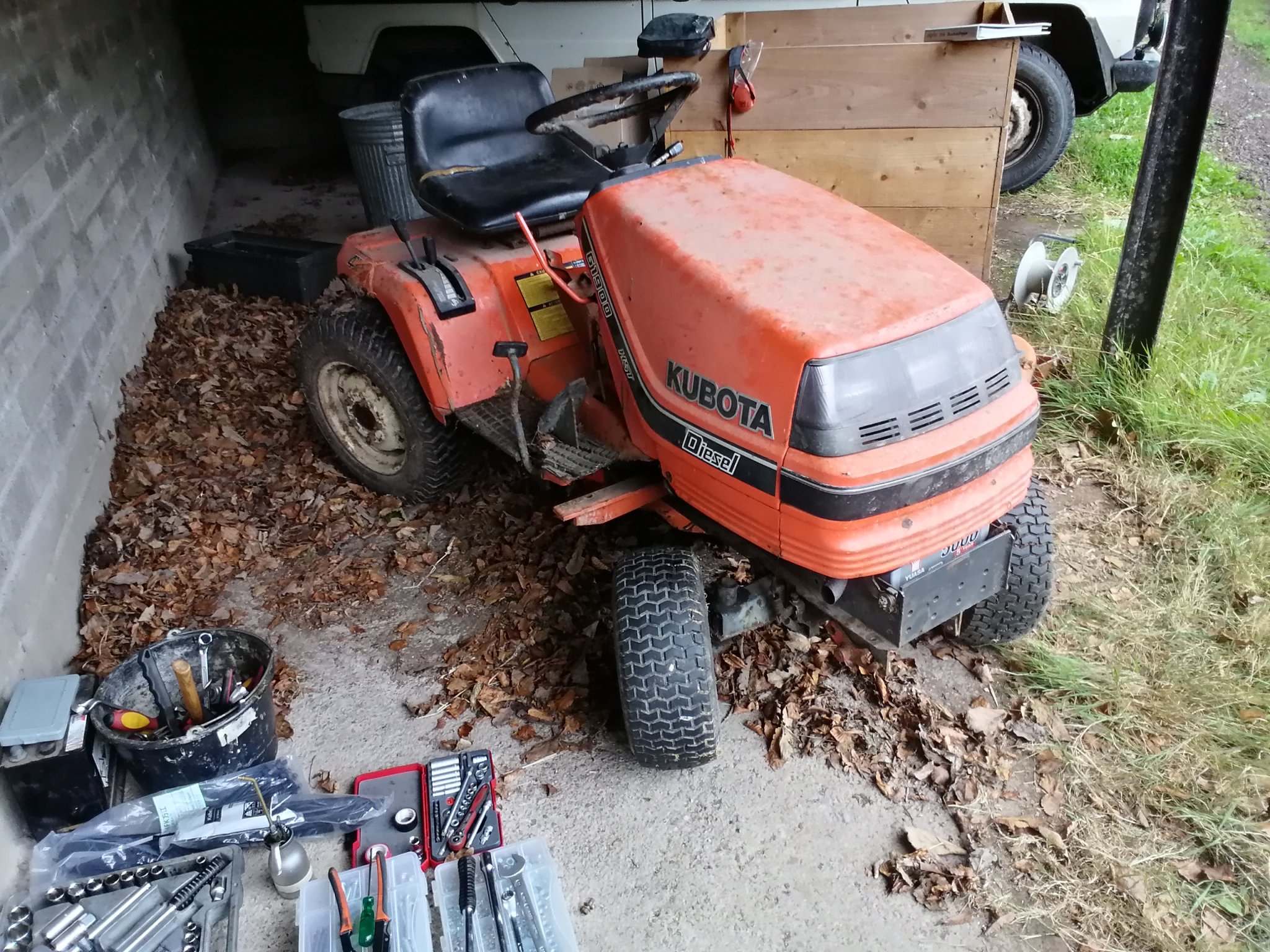

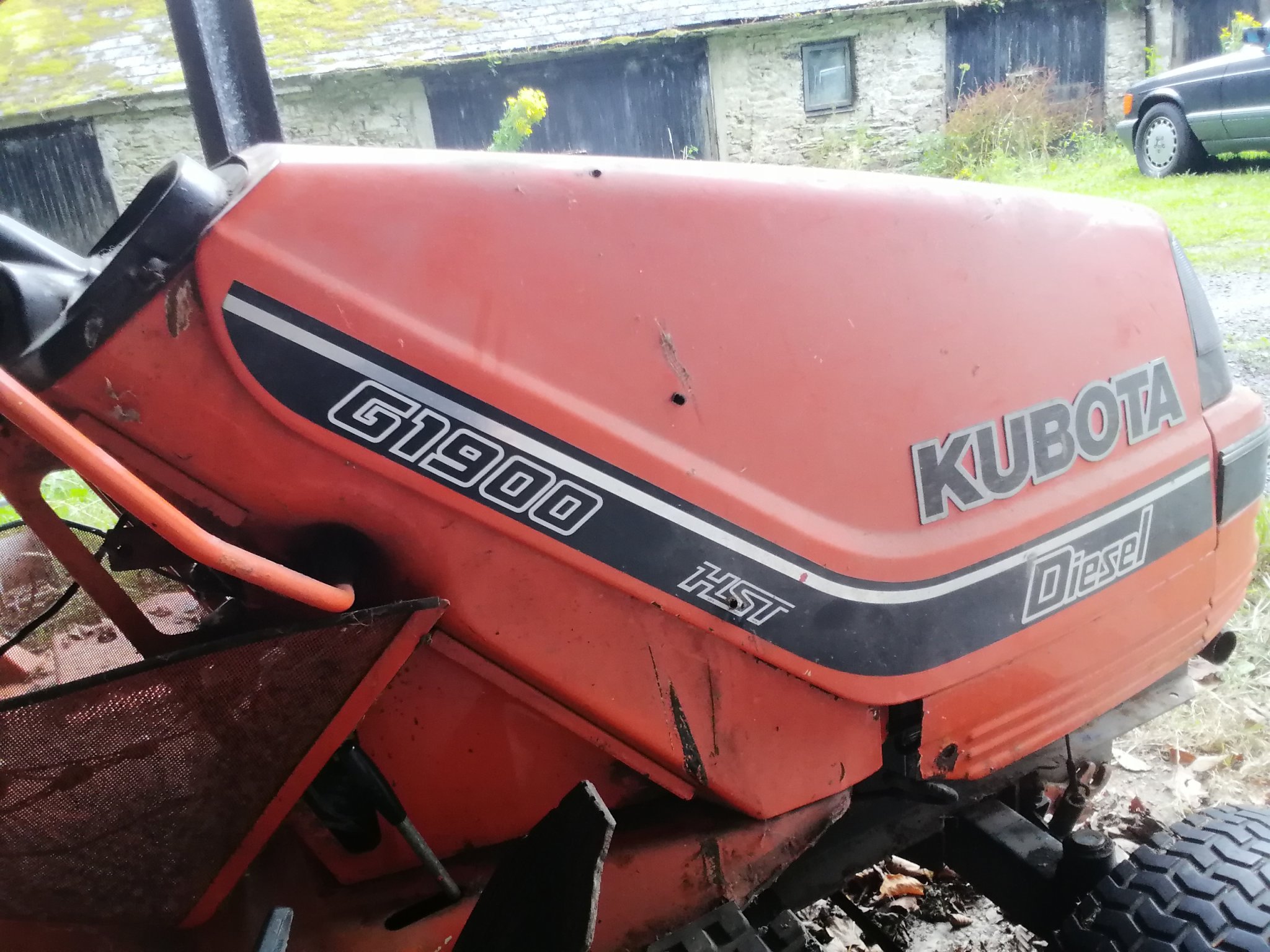

today I spent all day trying to fix the electrics so that I can drive it on a trailer to bring it home. The starter won't work. So I checked the usual switches and found the brake switch faulty. Shorting that did not change anything. It seems all switch signals are going to the combination box but this does not combine everything into a starter signal. All the electronics gunked up, of course, otherwise it would be easy to fix. Will have to build my own. So I ran a provisional wire from the starter switch to the solenoid and it started first turn. I had fixed one of the steering linkages reducing play in the steering from 360 degrees to about 90 degrees. Not great but I went for a spin. Loved it !

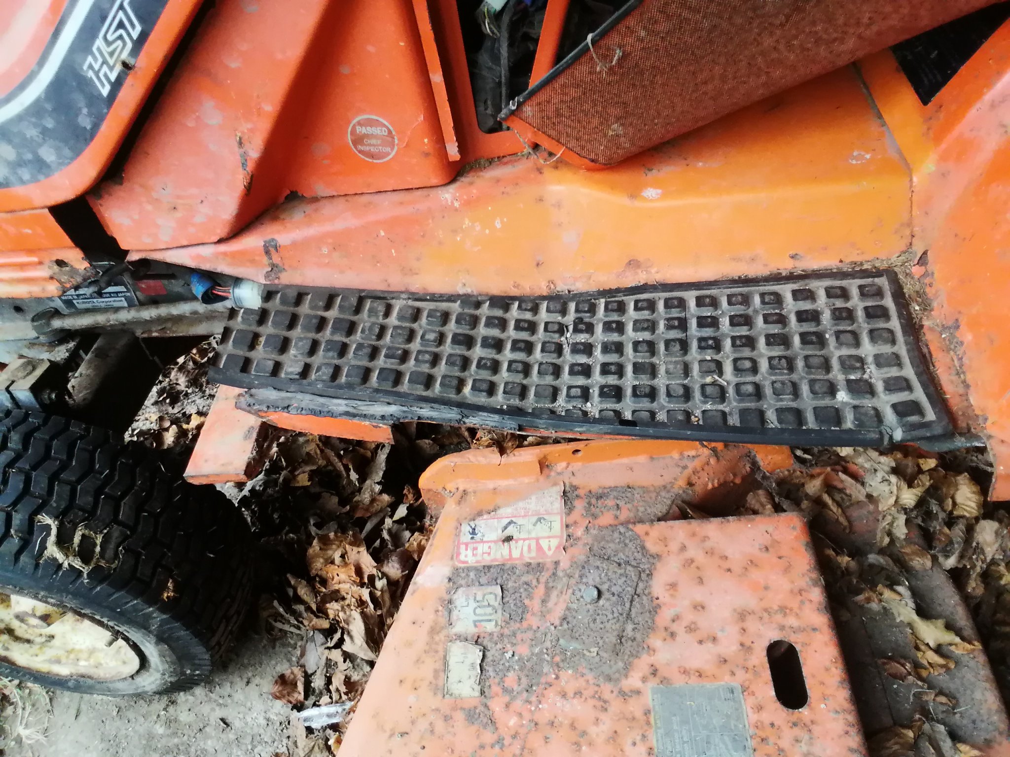

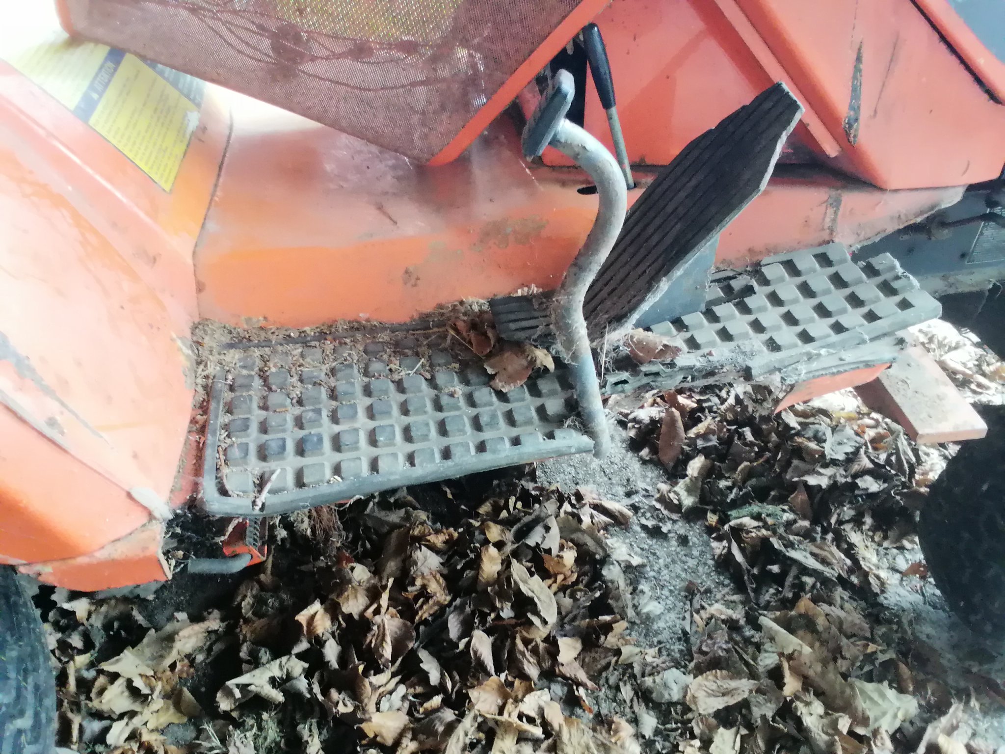

A lot of work to be done, I'm afraid. Some clowns from the local council must have decided in the past to put a cabin over the poor tractor and crudely cut big chunks out of the floor panel. That will be a lot of sheet metal bending and welding to get that back into shape.
I will start with the worst mechanical problems first, try to stop the corrosion for the moment and do cosmetics later. It has to cut my grass first.
Kind regards,
Hugo
