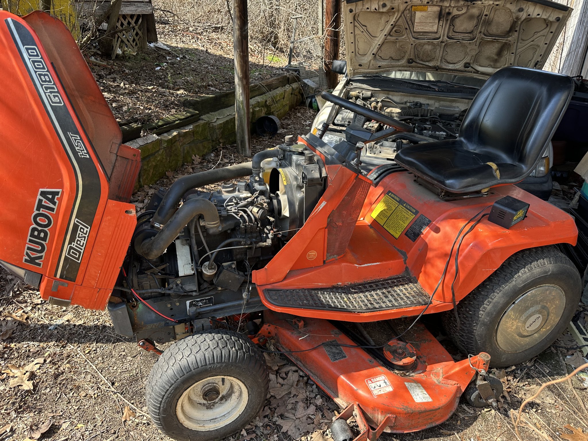

I’ve got a g1800 with 884 hours in it and it will not start. It used to be intermittent but it’s gotten a lot worse. I’ve not been able to start it all now in about 6 months. I just hear a rapid clicking but it will not turn over. I did try shunting the 12 volts straight into the starter bypass the starter selenoid and the starter spins but it still won’t turn over.
I’d really like to avoid a $500 something bill at the dealership…but I don’t know what to even look at. I did also short the safety switch on the seat with a wire but it made no difference.
I do know how to use a multimeter to check voltages and resistance ohms but I don’t know what to look at.
If anyone has any ideas to try explained very simply I’d really appreciate any help you folks could give.
