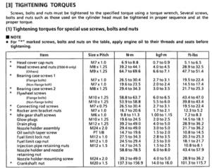

JerryC999
here are the tightening torques for the injector nozzles and fuel line nuts.
The source is the Kubota WSM Diesel Engines 70mm Series. The right most column is ft-lbs.
Wouldn't hurt to replace the fuel return lines and the clips that go there.
Good luck.
