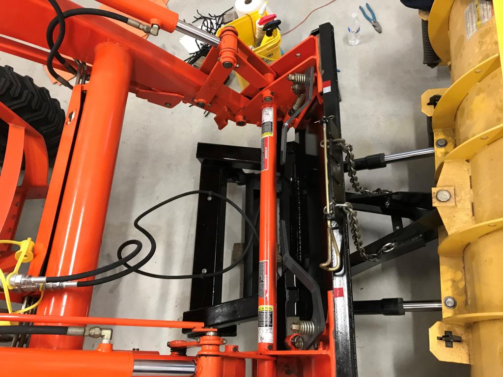

Mine is homebrew but illustrates the idea. Here are a couple shots taken when I was finishing the mount. The design was based on one posted by Gordon Gould that tucks the plow mount under the SSQA plate to lessen the distance the moldboard sticks out in front of the tractor. That helps shorten the overall length of the machine and more importantly keeps the plow from acting as a rudder when it's angled.
For normal operation, the plow itself is floated with the chain suspension. To apply more pressure for packed snow, the loader arms can be put into the float position and bear down on the plow frame. Never had to use that feature. If there ever were an extreme need for down pressure, the frame will handle down pressure sufficient to lift the front wheels off the ground.
That looks pretty slick. Do you have any more picture you could share? I would like to put something on the front vs a blade in the rear to avoid having to take of the BH just to plow.
