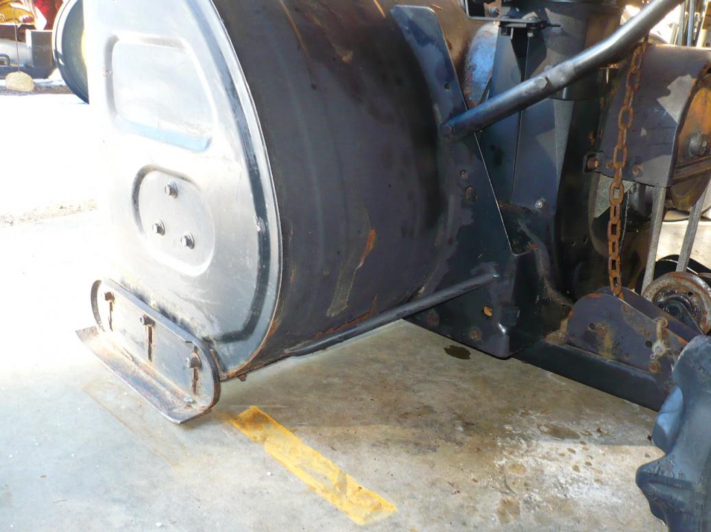

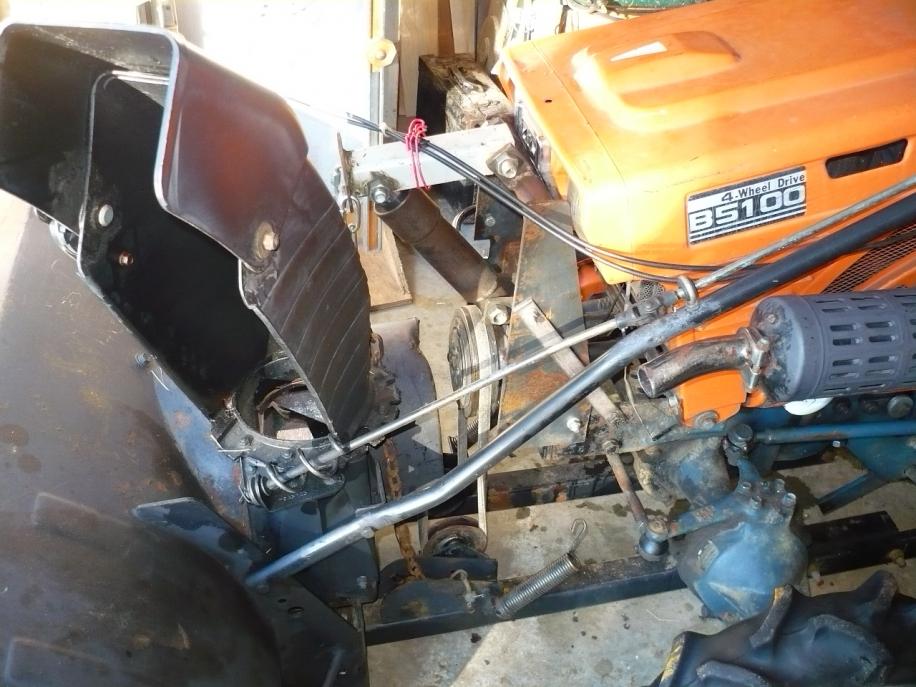

Here are the pictures of the front mounted assembly that lifts the sneux blower.
I used to use chains on both sides of the lift, but I found I could never get the blower quite level, so I used a turnbuckle to adjust the lift. I found I had to put a lock nut on the turnbuckle to prevent it from loosening while working. I guess the vibration made it come loose.
I've also shown the clearance below the edge of the blower .
