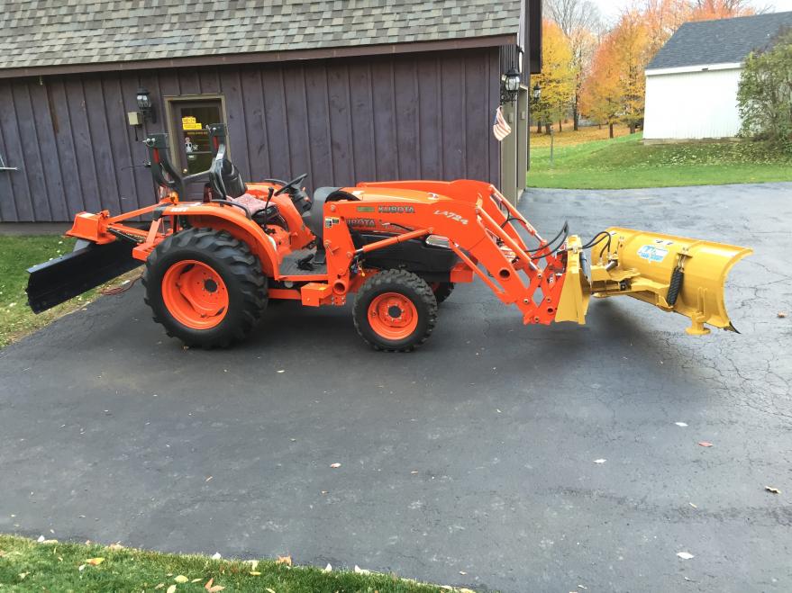

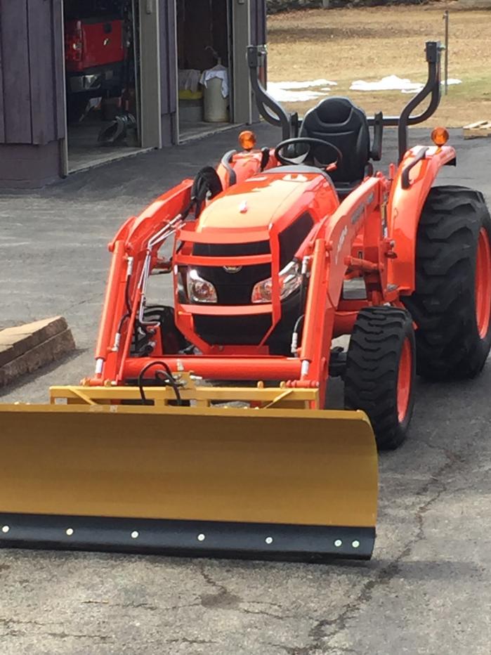

Technical Ted
L3560/cab LA805 loader LandPride RCF2060 rotary cutter, HLA hyd angle snow blade
Jul 2, 2016
105
Dansville NY
Thanks guys. How does the 3rd function work if there is only 4 valves to connect to on the tractor?
Obviously all 4 would already do the bucket arm up, down, tilt forward and tilt back.
Sorry, I'm a NOOB :)
The 3rd function adds another pair of hydraulic connections that can be used for the snow plow angle or anything else you might want to use. I've got one on my L3560 with a QA HLA snow plow.
