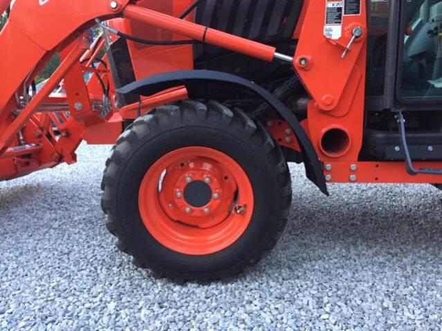

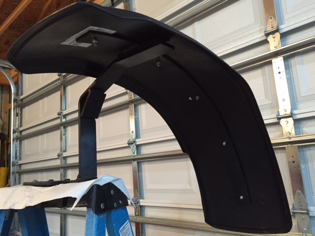

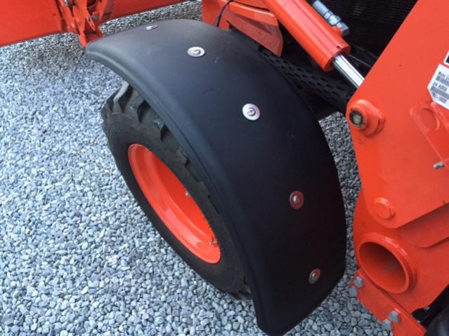

After many trails and errors finally have fenders mounted on tractor.
Good clearance between tire and fender.
Model of fender is 2500, same company and dealer as prior mentioned.
Did mount bracket to the top holes in the axle, the is a protective guard in front of the axle and used those holes.
Fenders should keep debris off the cab and most of tractor.

Very nice, keeping them low at rear of fender will keep a lot of the gooey stuff off cab. Looks like you opted for the axle mount, not hub mount. Non moving fender would be my choice,turning wheel throws mud away from cab anyway.
