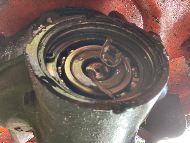

I parked the M4900 and saw that my front tire/wheel was covered with oil. Now that ain't right.
This is from the bottom of the axle looking up. Cover gone and the bearing was shot. I was 46 miles from the Kubota dealer but a call verified that he had everything in stock. I got a new bearing, shims, snap ring, cover, and a couple of jugs of 85-90. Hopefully I can get it back together tomorrow.

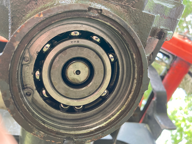

I don't think that what I wanted to do is possible, at least not a field repair. I removed the snap ring and shim but there was no way for me to remove the bearing.

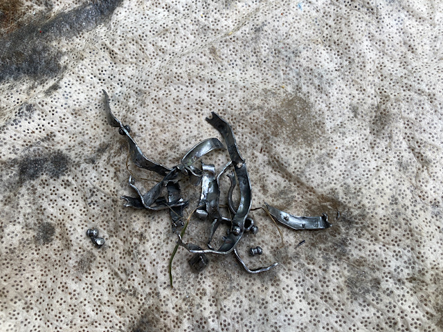

Then I pulled all of the mangled "caging" material out of the bearing.
After turning the wheel hub a few times the roller bearings sorta separated out so I made an executive combat decision.
I tapped the sealing plug into the axle housing, filled it with 85-90, and went to work.

You do know that the purists are going to beat you up on this one.
In a combat situation, you would earn a Medal for getting it working.
I'm no purist. But by the look of the bearings in your photos. You're going to do much more damage if you don't make it right.
Get it to a shop and pull that bearing when you can. Frankly, it's toast.
A bearing puller attachment on a slide hammer... Or better yet a factory manual with specs would be good. To determine whether the inner or outer race is pressed on.
Just sayin'

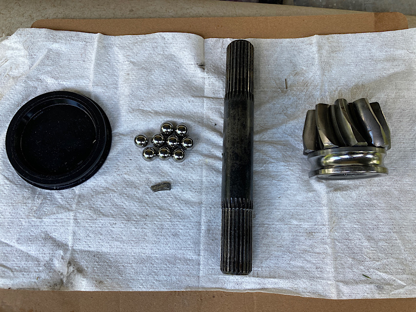

Yesterday I pressed the inner race from the gear on the right and pressed the new bearing on. Next I used a gear puller and removed the bearing outer race from the axle housing. Sorry I failed to take a picture of the gear/bearing & splined shaft before I installed it but it was a simple matter or tapping the bearing into the axle housing and installing the shim and snap ring. Add the seal plug on the bottom of the axle housing and then about 2 gallons of 80W90.
