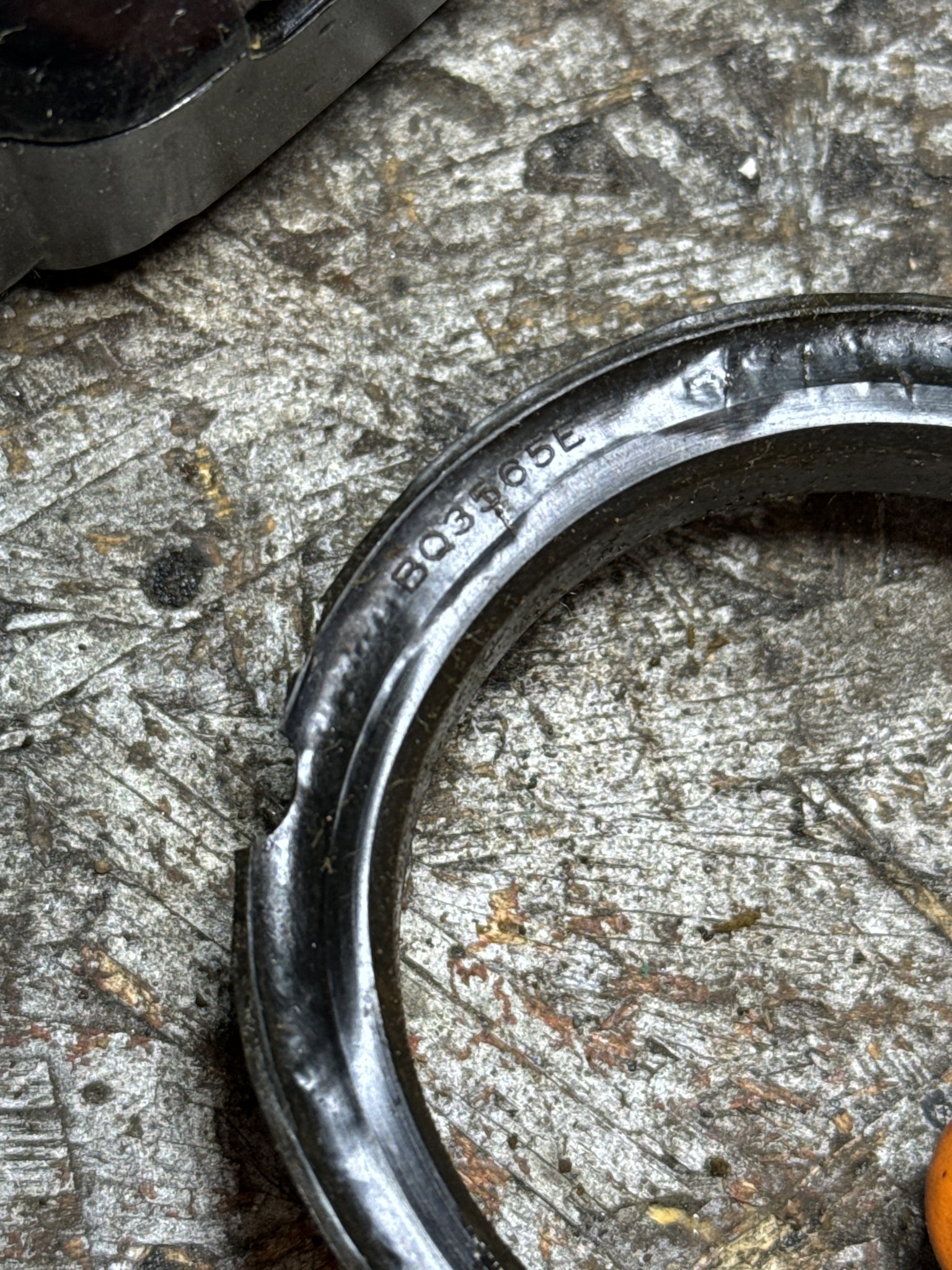

Hi guys,
We do not have a Kubota dealer in my country, I am trying to figure out what alternative is there for the NOK BQ3565E seal.
I can access SKF, FAE...
EDIT: It looks like this is the KUBOTA part nr. 5H746 16440

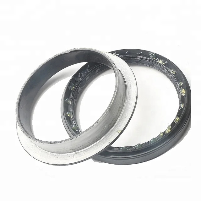

It looks like that seal is used on certain harvesters and is available from other sources online:

Thanks man, I finally sourced someone that would send these my way, a company in NL, purchased two for 124,- with shipping.

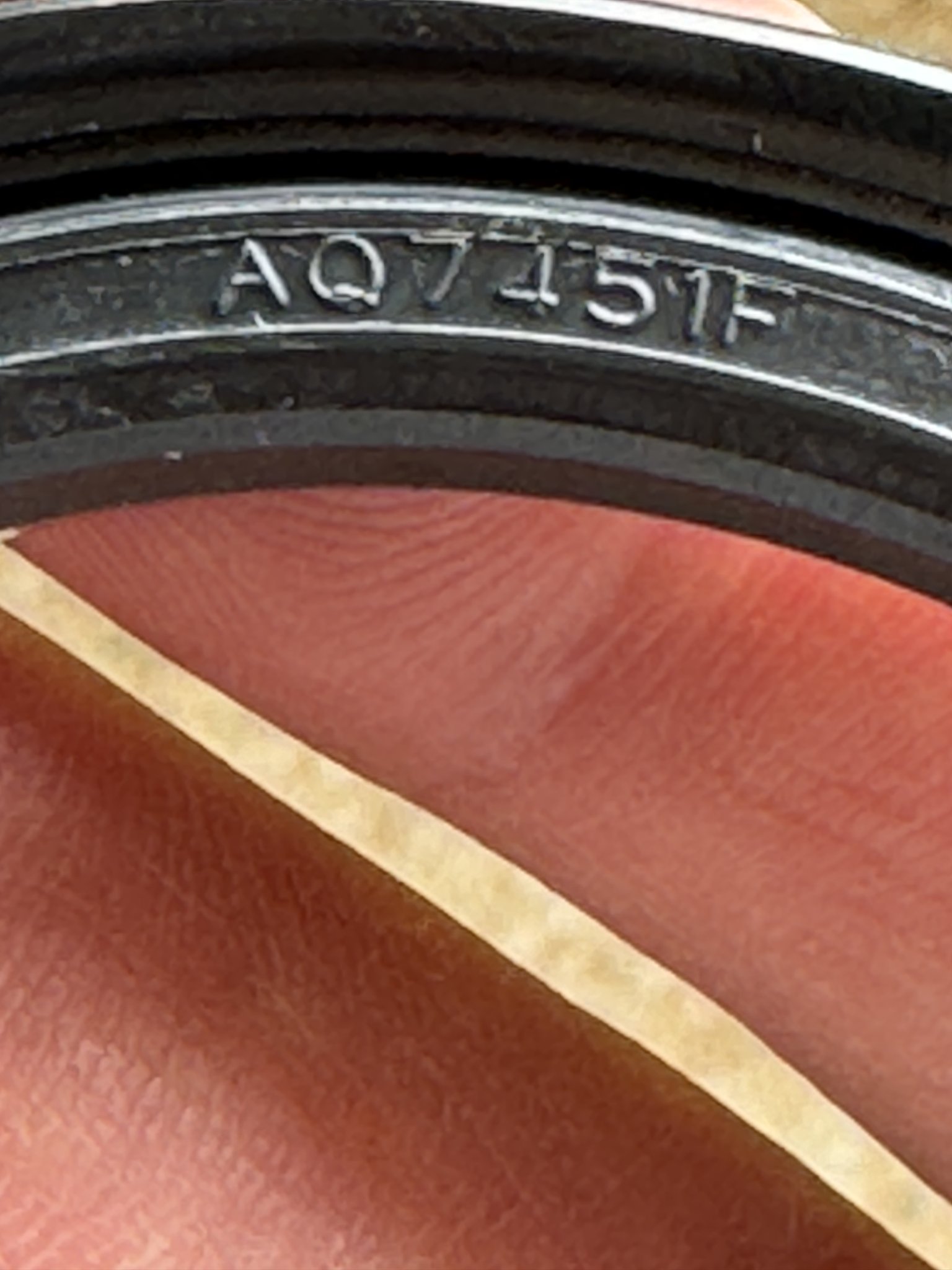

Just a short update, for those that might be interested, this is what arrived from NL, different NOK code:
i have replaced on side, the other side is also leaking, will do that side today, the bearing was a killer taking off and putting back on…
