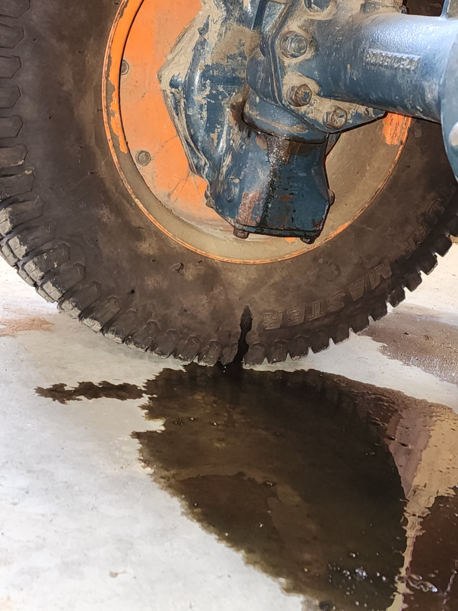

Geohorn, its not leaking at the cover or the main body. The leak is at the left front wheel from the point right under where, what the diagram in my manual calls the king pin. But, the picture in the manual is not the exact same as on the tractor. Its almost like a trunion cap of something, facing downward, where the lube ran out of. I'll try and go out and get a pic of it if I can manage.
michmike
B9200 HST D
Apr 18, 2020
7
71
Ionia, Mi USA
You can see where the lube came out of. My manual, although a bit different, does not show a closeup other than showing what appears to be a king pin assy. Imho, this looks like a 2wd front, not like my 4wd front.

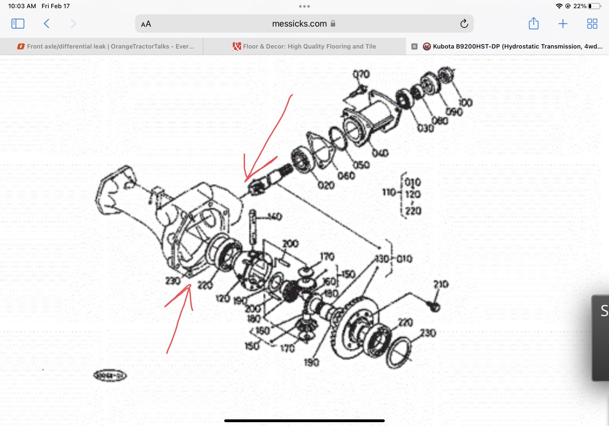

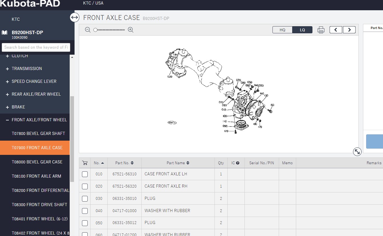

Its only showing diagrams for the transmission.
Try the other tabs on left side of screen. Expand Front Axle/Wheel. This is the Front axle case. Think bevel gear case might help too.
I haven't had one of these apart, but quite a few guys here have, and have documented them on OTT. Varies by model I'm sure, but might also help.
I tried to find a B9200HST 4WD WSM (workshop manual), but didn't come up with one in my quick search.
12,726
5,530

MichMike… I just did this repair on my M4700DT a couple months ago. It’s really not too difficult, even considering the first-time attempt that I screwed up. I’ll try to find a link to my post.
That’s called a “bevel gearcase” and that leak is due to a failed oil-seal which is replaceable with nothing more than hand-tools and a floor-jack. The only thing to worry about is to get ALL the old seal removed before trying to put it back together with the new seal. It’ll take you about 2 hours for the complete job once you have the new seal in-hand and ready to go.
You’ll also need 6-8 qts of gear oil to put into the front axle when finished. (It’s a great time to drain both front bevel gear-cases and do a complete oil-change on that axle. I used 80W90 gear oil.)

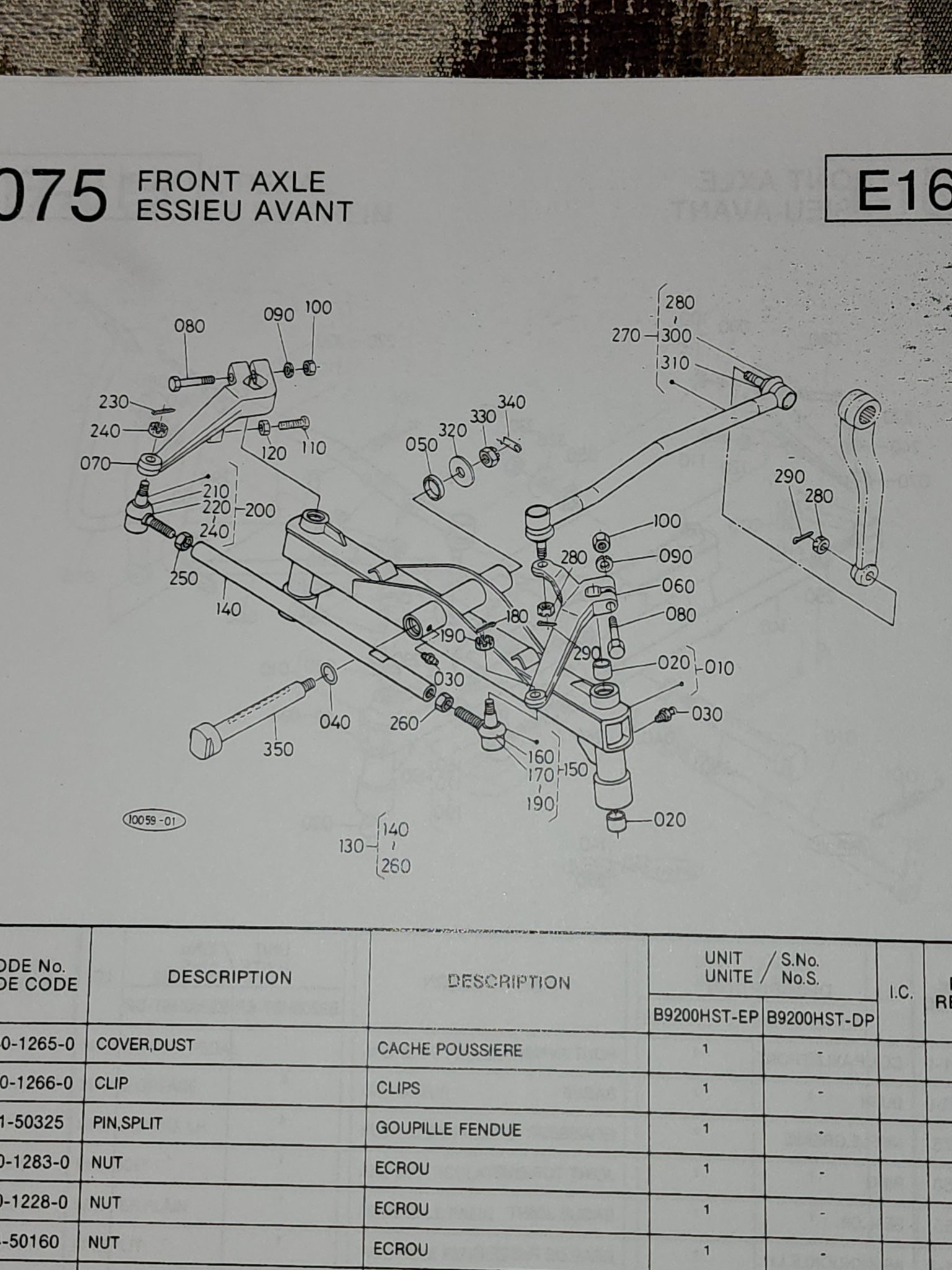

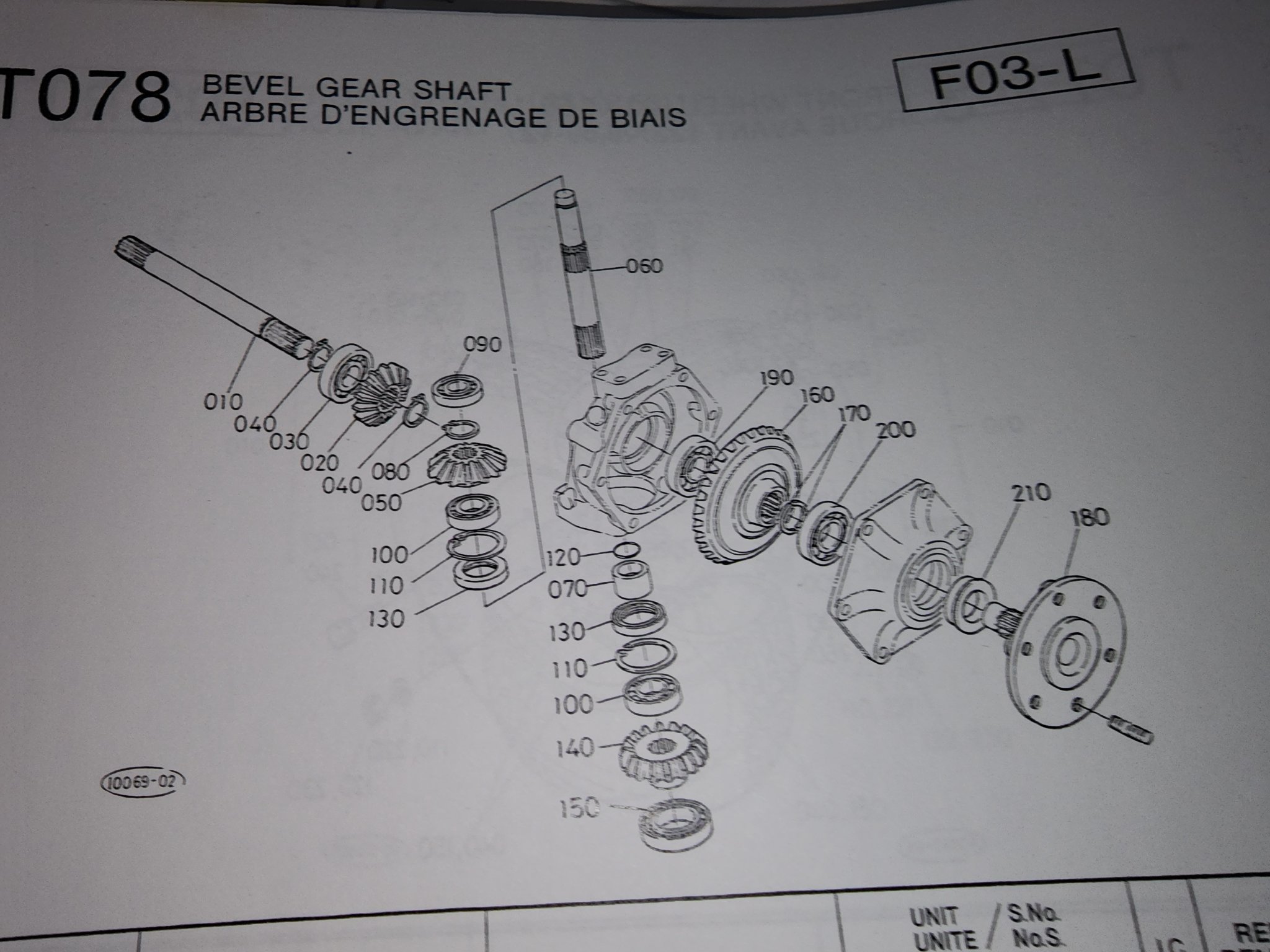

Found these in my manual in the transmission section....lol. Is either showing the assy I need to address, and if so which seal are we talking about.
6,041
3,322
MitchMike, putting the gearcase back together, I also used a bit of Permatex #2 at the seam to assure no seep at the case-split-line.
Looks like item 130 in the first pic and 110 in the second. (two different models? Pay attention to your serial number tractor when you look at parts catalogs/illustrations and when ordering parts.)
