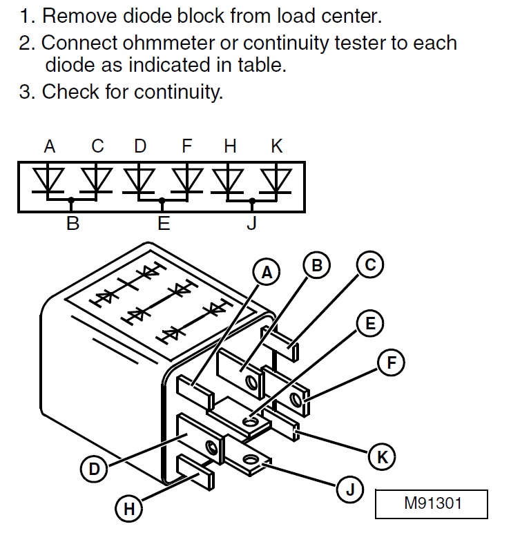

My post is just intended to provide info not to be of help to the owner with a serious issue!!!
It has been my experience studying Kubota and John Deere manuals that John Deere goes to a much greater length to protect against reverse polarity situations. They use special purpose relays called "Safety Relays" and up to 6 diodes combined in a block which is about the size of a relay.
The Safety Relay operation;
Safety Circuit:
A safety circuit consisting of the K3 safety relay 1, and the
V6 diode is installed in the circuit to protect the N1 voltage
regulator/rectifier from reverse battery polarity.
The above is just one description of several safety relays within the wiring harness.
Here is the schematic of the diode block.
Dave
