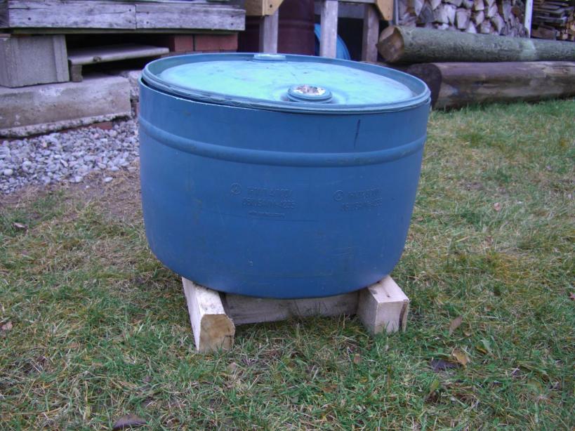

Well, as I'm not sure whether I will need any rear ballast when using my front mounted blower and electing not to load the rear wheels because of fear or being too heavy for grass cutting. I was offered the ballast box solution by the dealer.
They did not think I would need it and did not push me to buy it.
So just in case I do need ballast I looked around and thought an old RV anti-freeze blue barrel would do the trick. Having calculated volume to weight - thinking about 400lbs I cut down the tank, mounted it on a couple of sections of scrap pallet blocks and there you have it. Totally free, able to hold liquid, rocks , drit, salt whatever I had really. A small loader on the back.

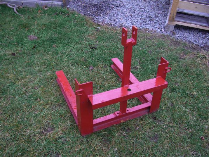

But now I hear you say how does that work on a 3 point hitch, no pins visible.

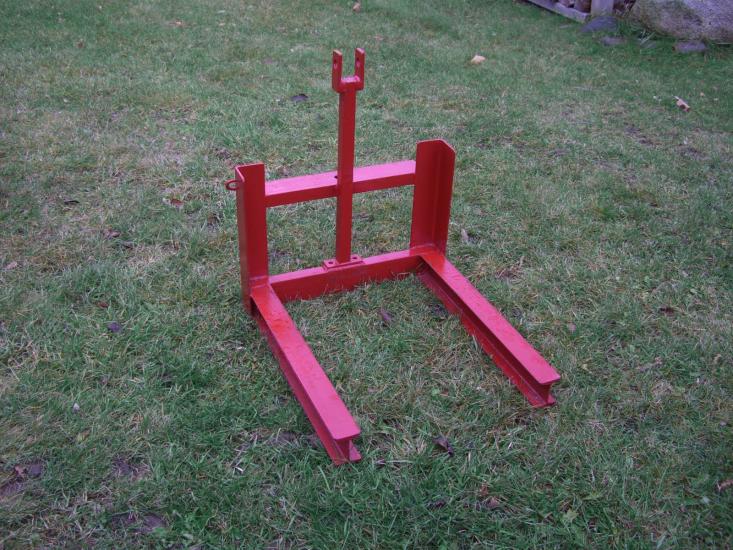

Well., I fabricated a set of rear forks to lift that, a firewood box and the base for mounting another drum that I will be making into a sprayer.
The forks work well, they hook over the spreader bar and pin on, connect to the top link and you are in business.
Again, comment, questions are always accepted. I can do a more detailed description of the forks if wanted.
