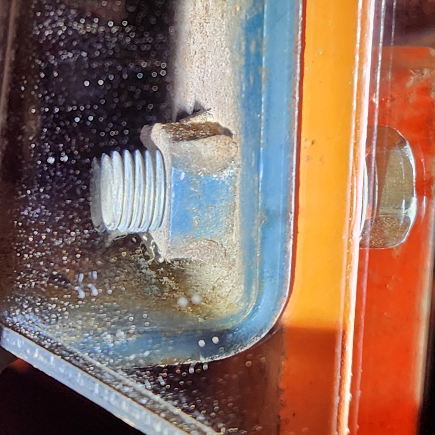

Here is a shot of one of these captive nuts taken with a mirror.
I tried loosening the bolt up and tapping on the bolt head with a hammer. I could not budge the nut. It does appear that they are welded to the frame and not pressed in. That narrows down the possible repair methods quite a bit.

Those are not captive nuts. They are welded on. Drill it out and helicoil it.
