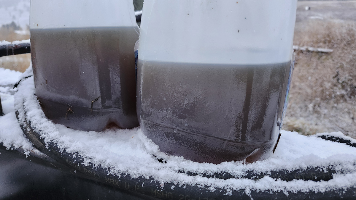

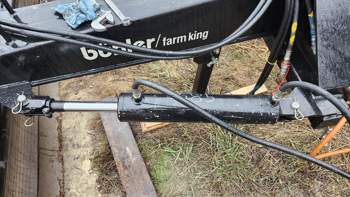

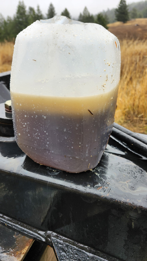

I bought a used rear blade with three-way hydraulics last year and wanted to get the oil out of all three cylinders. I simply removed the couplers from the ends of the six hoses and used enough compressed air to move the pistons back and forth, first one way, and then the other, while draining the oil into a container. I did this a number of times until I was satisfied that the old oil had been removed. I ended up with something like 1-1/2 gallons of oil.
I use UDT2 so had no desire to mix whatever was in the cylinders with the liquid gold in the tractor.
