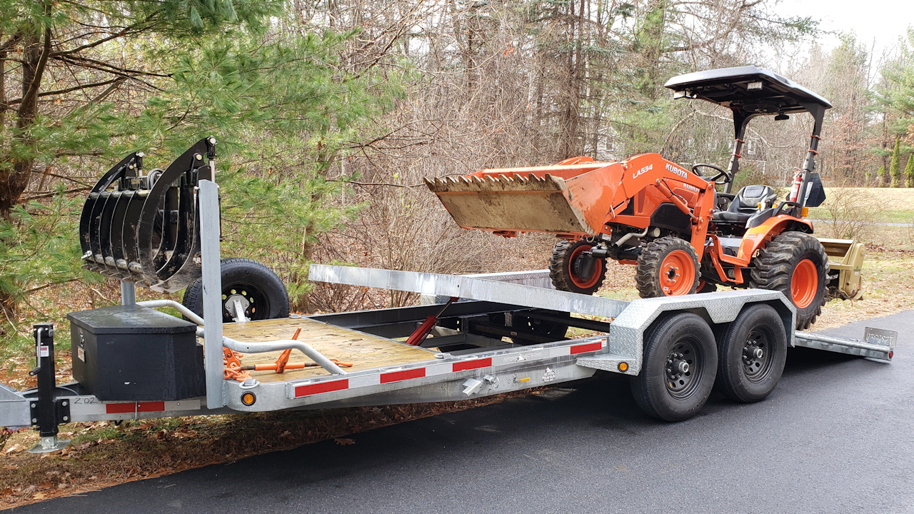

NHSleddog
B2650
Dec 19, 2019
2,144
1,837
Southern, NH
Worked for a cable laying company many years ago where we used tilt beds very similar. Nothing beats a tilt top for moving anything with wheels or tracks IMO.
If I had known how nice and fast it was, I would have had one years ago.
