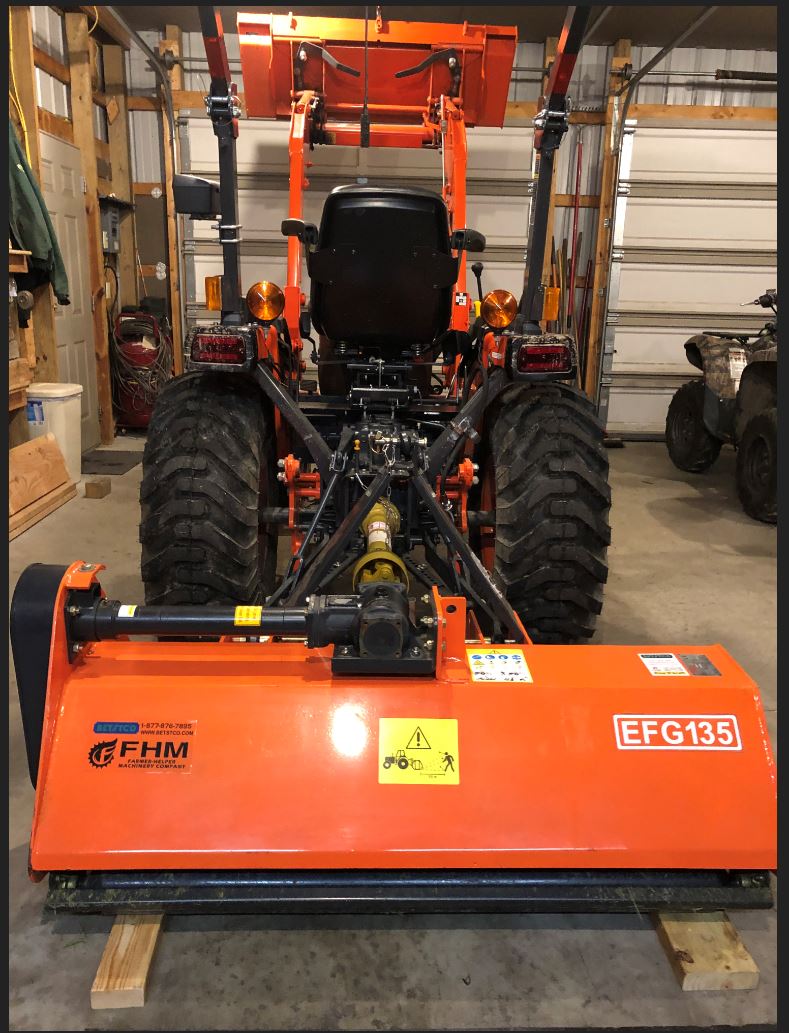

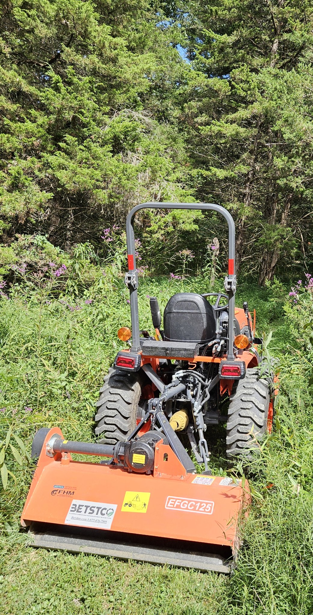

I've got the the Betsco heavy duty 48" with forged hammers. Been a good cost effective option. Very basic machine but does what I need. If not already aware the spacing on the 3 pnt is not quick hitch compatible.

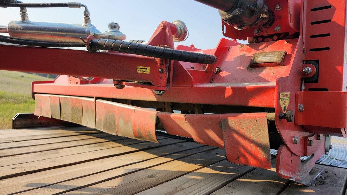

After three summers of heavy use with the Del Morino flail cutting many acres of tall, thick grass and weeds, as well as running over large objects hidden in the vegetation, they're definitely on my short list when I go looking for a larger model. I replaced the sealed bearing on the output shaft of the gear box earlier this summer once it started chirping. The bearing could have been defective, or perhaps I had too much tension on the three belts, time will tell. The bent guard rod was due to my running over large, solid objects such as logs and a block of wood that I didn't see, so I modified the guard system to reduce the need for more repairs in the future. Del Morino would price themselves out of the market if they designed their products for what amounts to abuse, so I don't fault them for the design.
I've used the flail to cut unfamiliar areas for money and when someone is paying you to cut you don't have the luxury of puttering around. There's little chance of my damaging the flail at my place since I'm familiar with what's out there, but some unknown property is a crap shoot and that's why I made a change to the guard.
Before: Guard rod is fixed and in the path of the exit chute which is fine for "normal" use. This damaged occurred when I was cutting a property for money where there was a lot of stuff hidden in the grass. The hammers were fine since it was stuff like logs or tree stumps rather than rocks.
After: Guards and rod hang from another rod that isn't in the path of the exit chute so the added hinge should allow the entire guard to swing up and absorb some or most of the energy.
