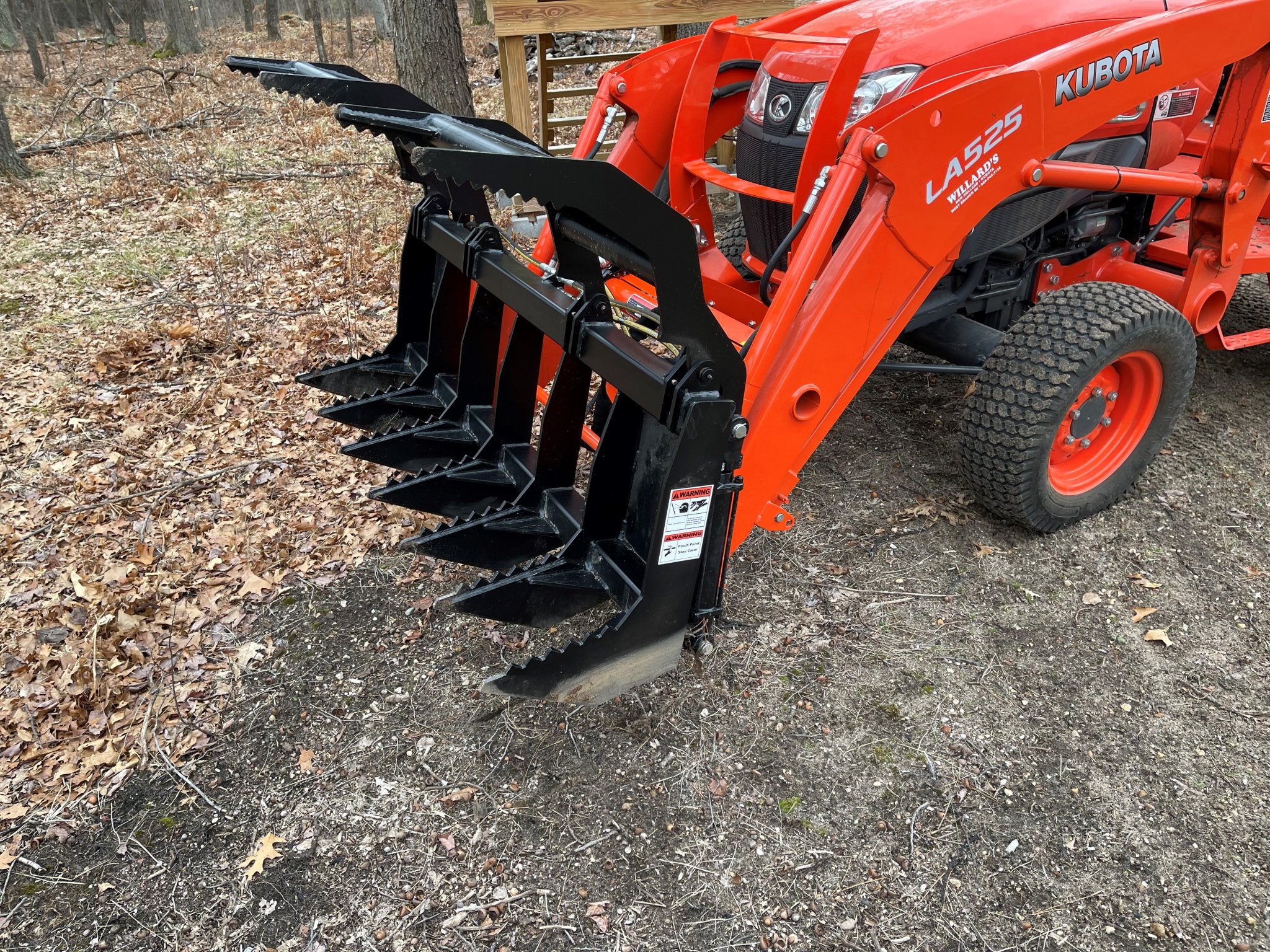

I have the EA 55" Wicked Root Grapple and they have taken everything I have thrown at them. I never realized how useful a grapple is until I got this one.
I would guess that any grapple is better than no grapple. The one thing I would watch is the weight of the grapple because that will take away from the load you can lift.
