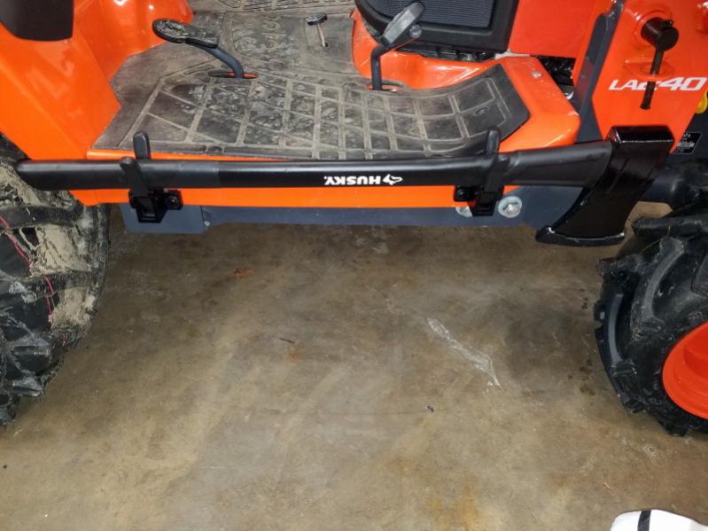

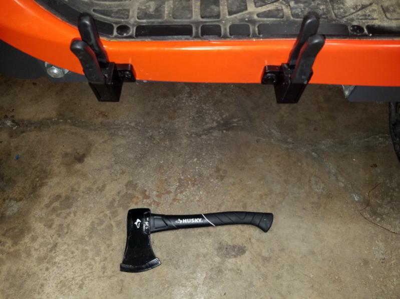

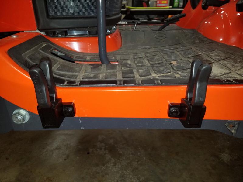

Weekend Mod 3a
This last one took a bit of planning. I got these utility hooks from eBay for $20. After running them through a wire-wheel to remove the chrome plating, I hit them with some etching primer and 10 coats of Satin Black Rustoleum. These would be perfect for mounting a hatchet to one side of my tractor and an ax to the other. I attached them with some grade 8 (5/8" X 2") bolts and Plasti-Dipped the pinch arms of the bracket.

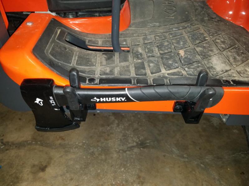

Weekend Mod 3b
The ax handle was 4" too long to fit on the side of the floor board without interfering with the tires/wheels so I cut 4-1/4" off with the miter saw to give it a nice, angled cut and then used Plasti-Dip to create a handle. I dipped the ax handle 9 times to get the desired thickness and had to cut the bottom out of one of the cans of dip, then couple them together to fit the entire length of the new handle including displacement.

Re: Weekend Mod 3b
I like this idea...:)

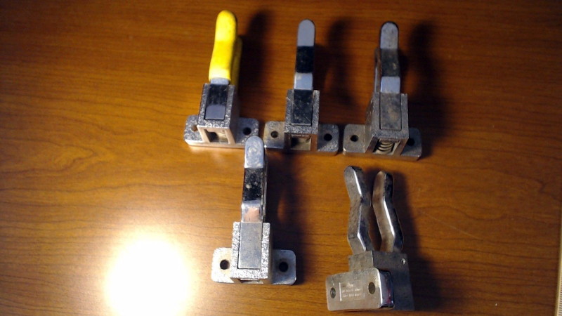

Re: Weekend Mod 3a
Do you have a link for these?

Re: Weekend Mod 3a
Sent from my SM-N920V using Tapatalk
I got 5 used ones from eBay for $20 delivered. They are called:
South Park Axe Handle Brackets - Side Mount
Here's a link: http://bit.ly/2nOd3ZE but they ain't cheap when they're new :eek:
