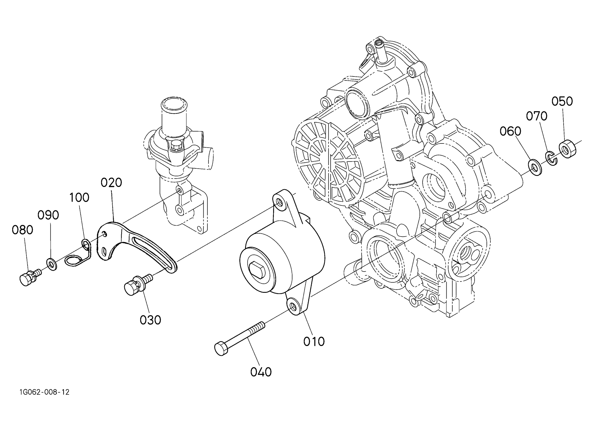

probably as simple as loosen bolt 030 and 040, push dynamo in, remove old belt, install new on, pull dynamo out, tighten bolt, check tension, run for an hour or two, recheck the tension, adjust if necessary
