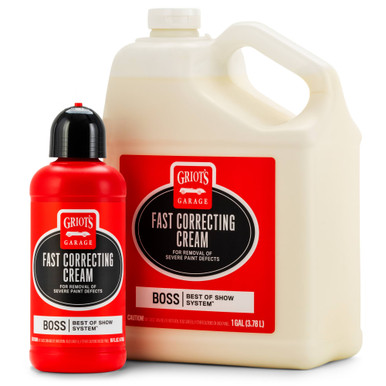

No experience with plastic tractor hoods, but the following is what a pro automotive detailer and I would use to revive plastic.
First, try to remove the oxidized layer with an automotive paint compound using a random orbital polisher.
If that does not work, use fine sandpaper with an orbital sander or RO polisher. Once you remove the oxidized layer, then go to step one to remove most of the scratch marks from the sandpaper.
Finally, polish the revived plastic with a plastic polish to make it shine. Suggested compounds below:
