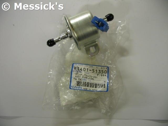

Your symptoms all fit a failed fuel lift pump when you keep in mind your F2560 is like a tractor in reverse.
A regular tractor with a failed lift pump has problems going up a hill whereas you have problems going down a hill.

Before replacing the pump check for power to the existing pump which should be present any time key is ON

Check the fuse feeding the fuel pump. Check for power at the fuel pump when the key is ON. Check for steady fuel discharge from the pump or filter by opening the line.
Replace pump if fuel delivery is suspect.
When the tractor starts acting up turn around and back up the hill. You will find it runs better if the cause is as i suspect.

I had contemplated the fact that going downhill half full of fuel causes a weak pump to underperform. And yes when I get turned uphill it cures itself. And as the tank gets lower, the problem escalates. I imagine I will start with a pump replacement.

Thanks, the other day I stuck a new fuel pump and filters on it. Tank was around a quarter full and it mowed up and down hills nicely. I also think it runs a little smoother, but that could just be me? The new pump is bigger than the old one also. plus this one I can hear when i turn the key on, very audible, the other one I could not unless I went next to it. Thanks again.
