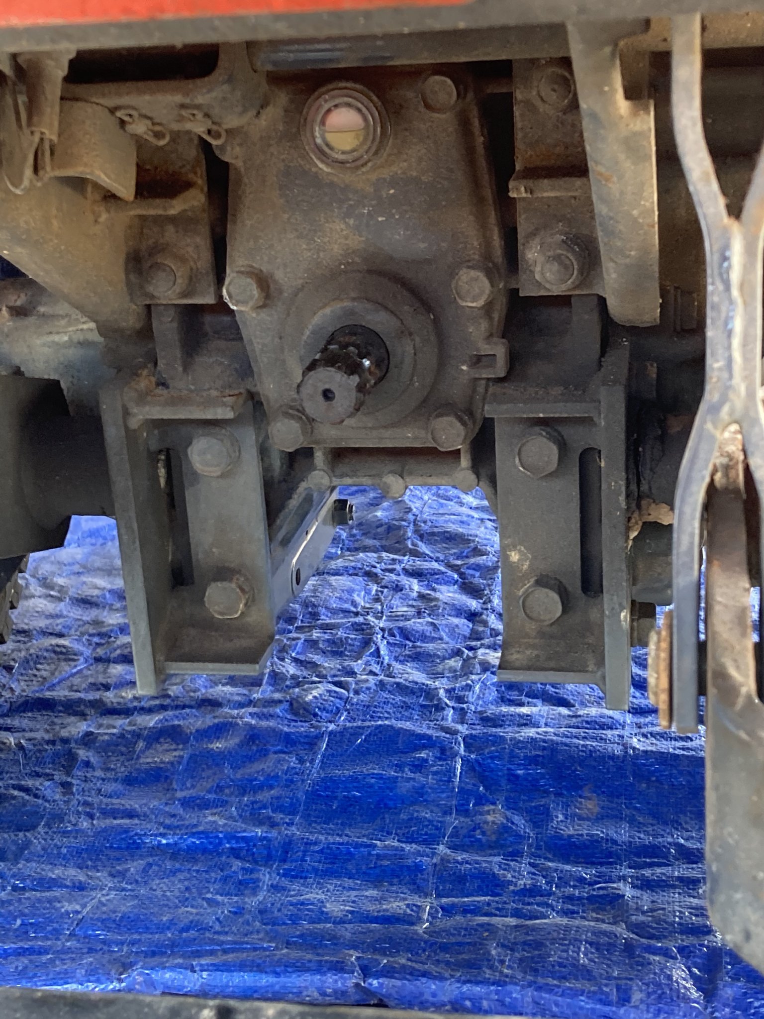

Those are with the quick hitch mounted, obviously. The main attachment points I see are at the end of the arms, and midway out the arms.

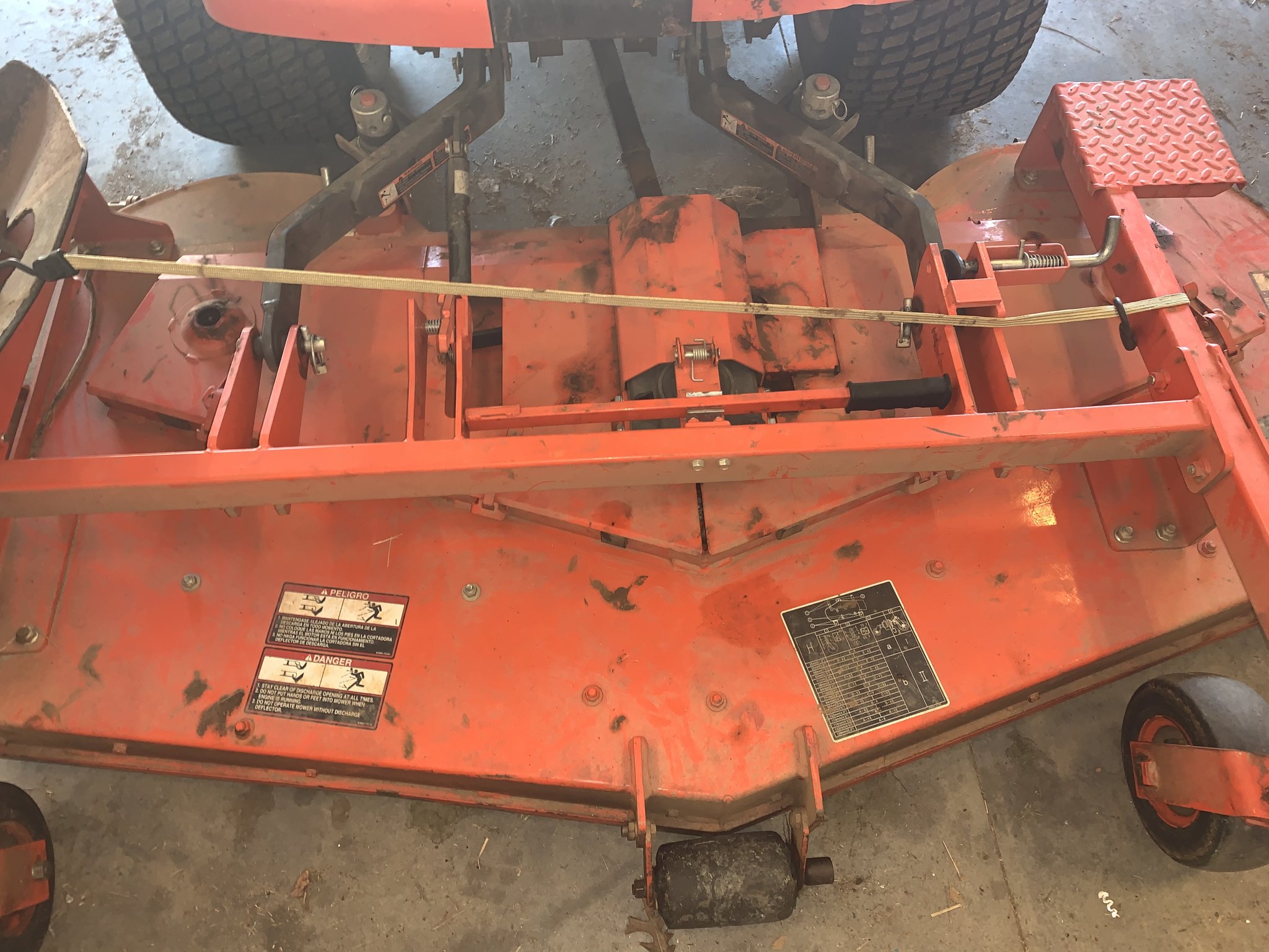

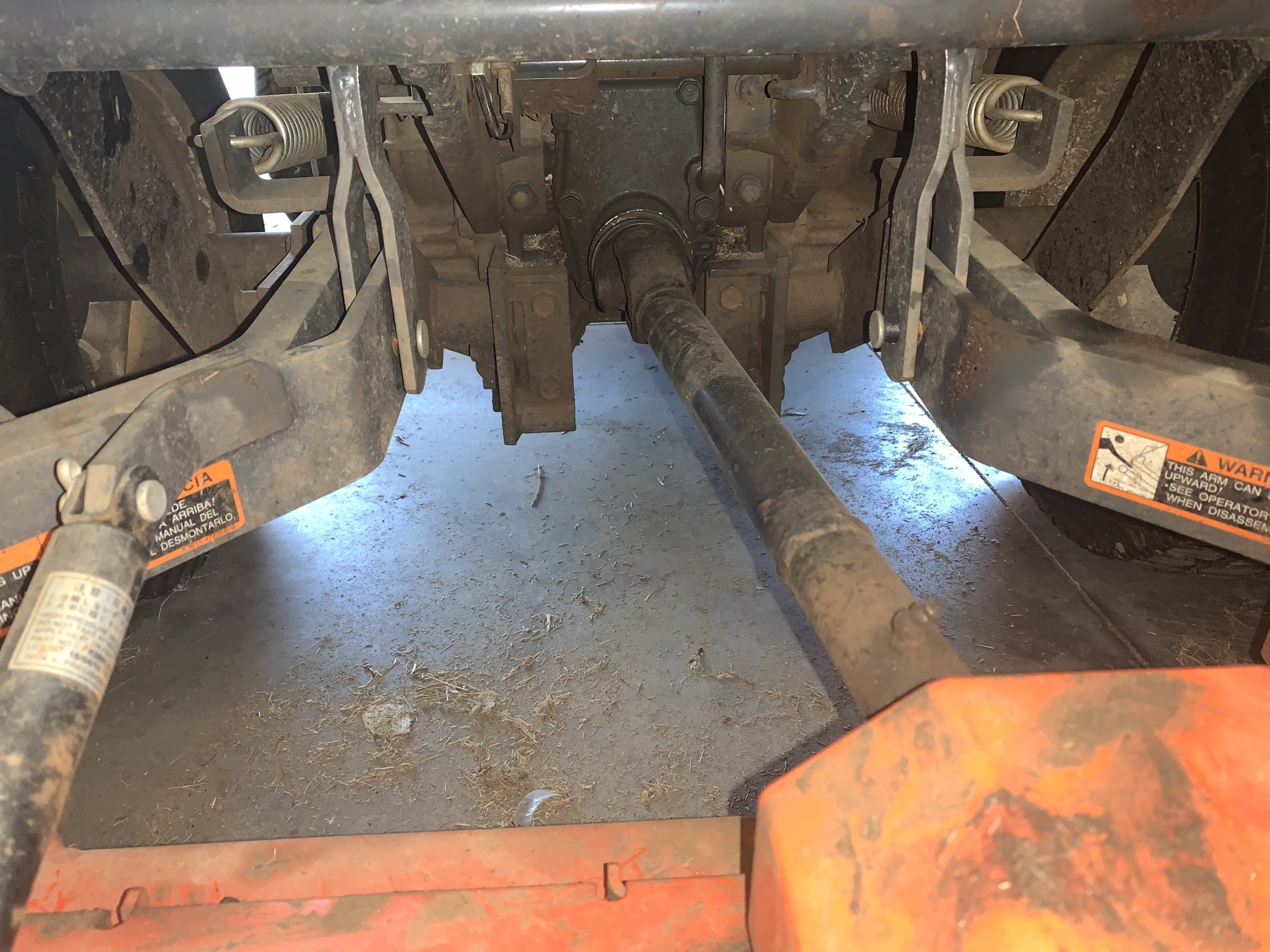

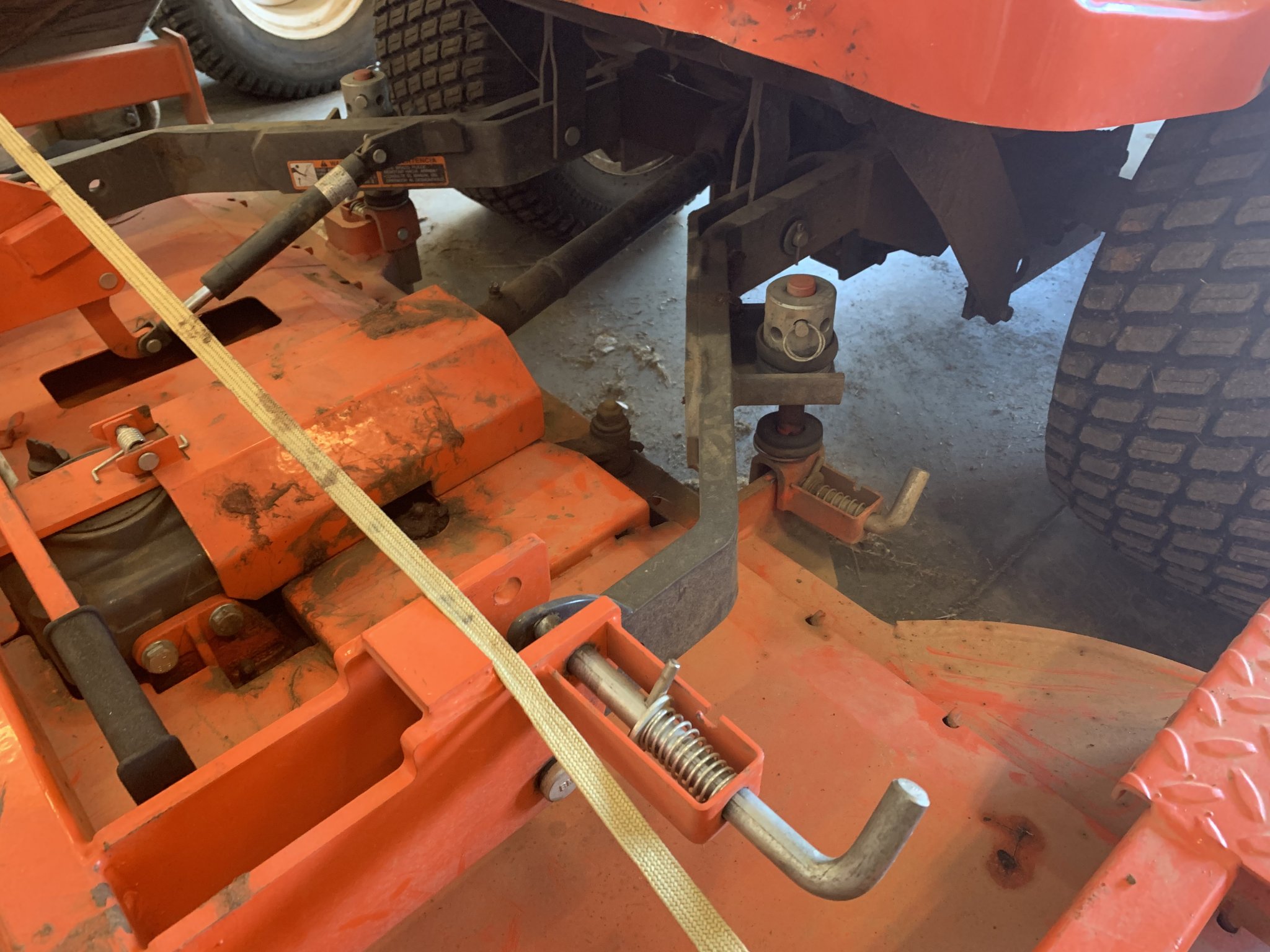

Looks like a very neat attachment. And I didn’t know they offered hydraulics up front. Pretty cool.
You are correct, the end of the links support the deck, while the mid points are part of the height adjustment along with the castors on the front of deck. I will take a picture of works F2690 tomorrow evening, but just looking at it, any F mower deck would work, with a PTO shaft of course!

That’s helpful - thanks! It looks like about the only difference is that I wouldn’t have a place to attach that gas shock, but I could probably just take it off. I assume it just assists with tilting the deck up.

I think it is to stop the deck from flopping around as much when lifted. You can remove the bar with black handle and disengage the piston, making it longer. I've gotten spoiled with my 2 post lift, I don't fold decks up anymore to change blades!
