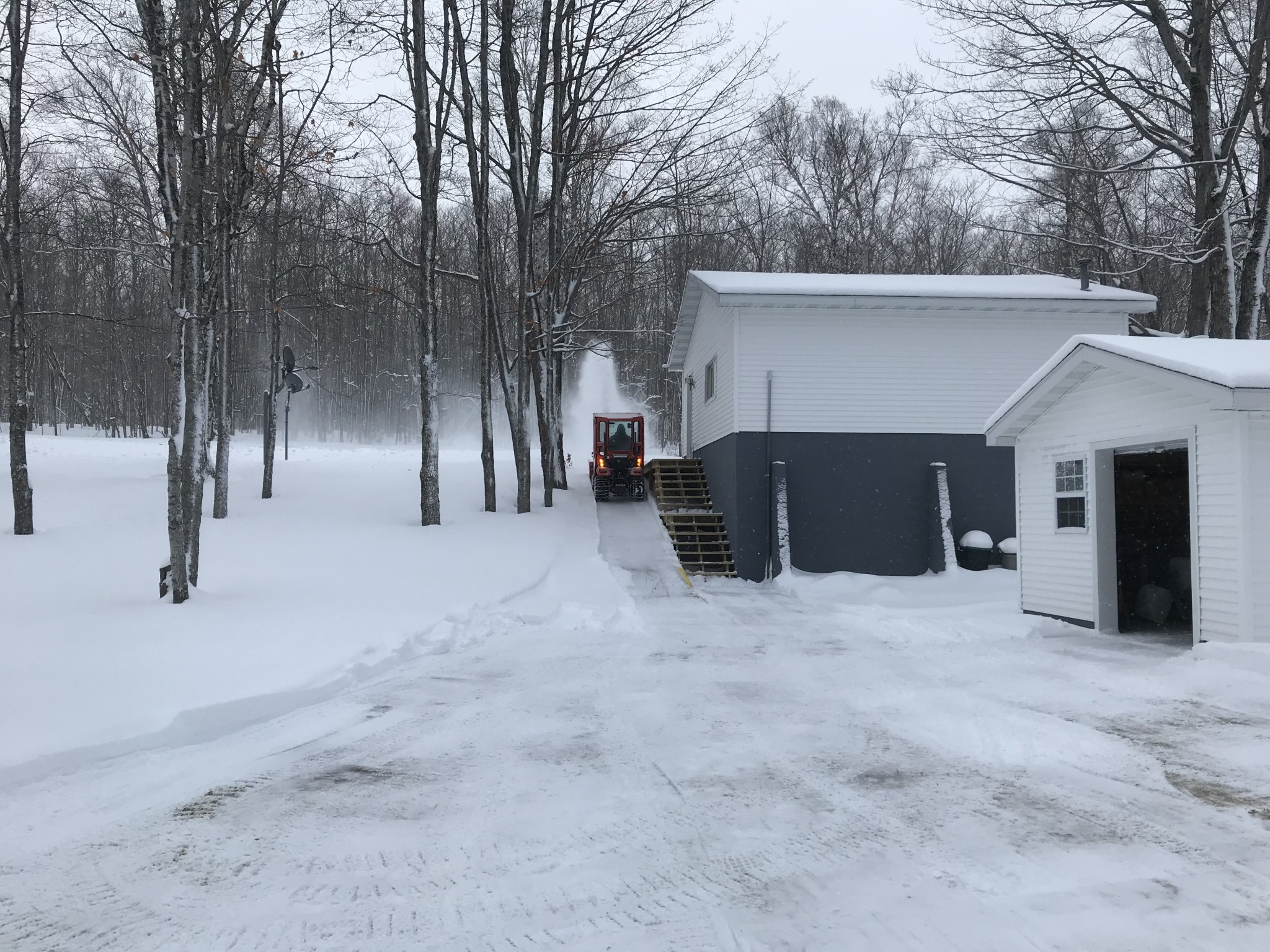

I have a BX 1880 with a 54” mower deck and a 48” HD front mount snow blower. One acre of grass to cut and a large area to snow blow in the winter. Also have to climb a steep hill when blowing snow. Never have I thought I needed more power it will blow snow 30 to 40 feet. We get anywhere from 200” to 400” of snowfall per year. It is a great little machine main reason I bought it is because of its size . Really don’t need a large tractor for such a small space.
