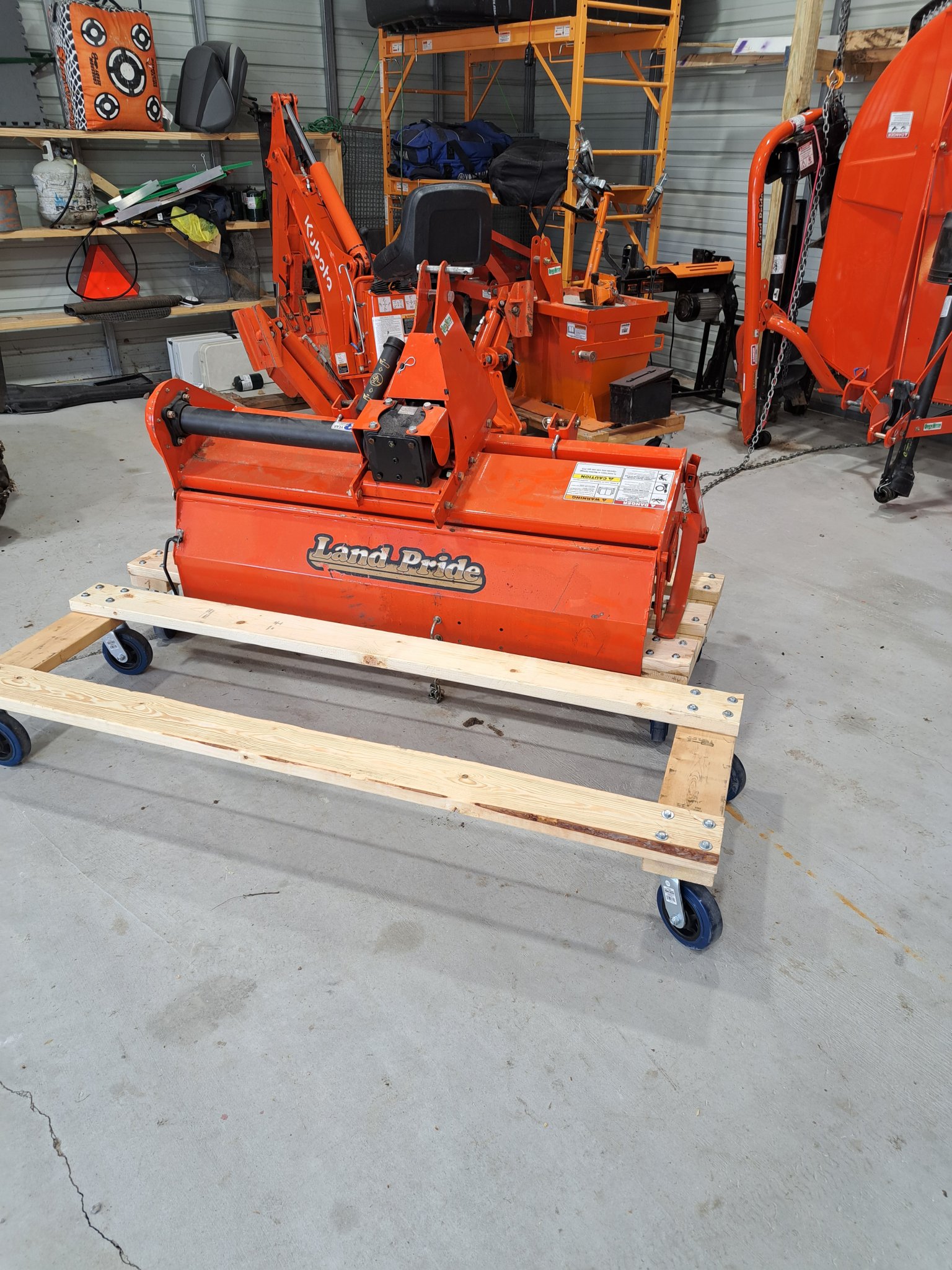

Well last week I decided to have at it, and build one for the roto-tiller.
Its a pretty simple/straightforward design, (if you can call a rectangular flat cart a "design"...hahahhaha)
I measured it up and 15 inchs wide would have been "just enough" so I decide to go a "smidge" bigger.

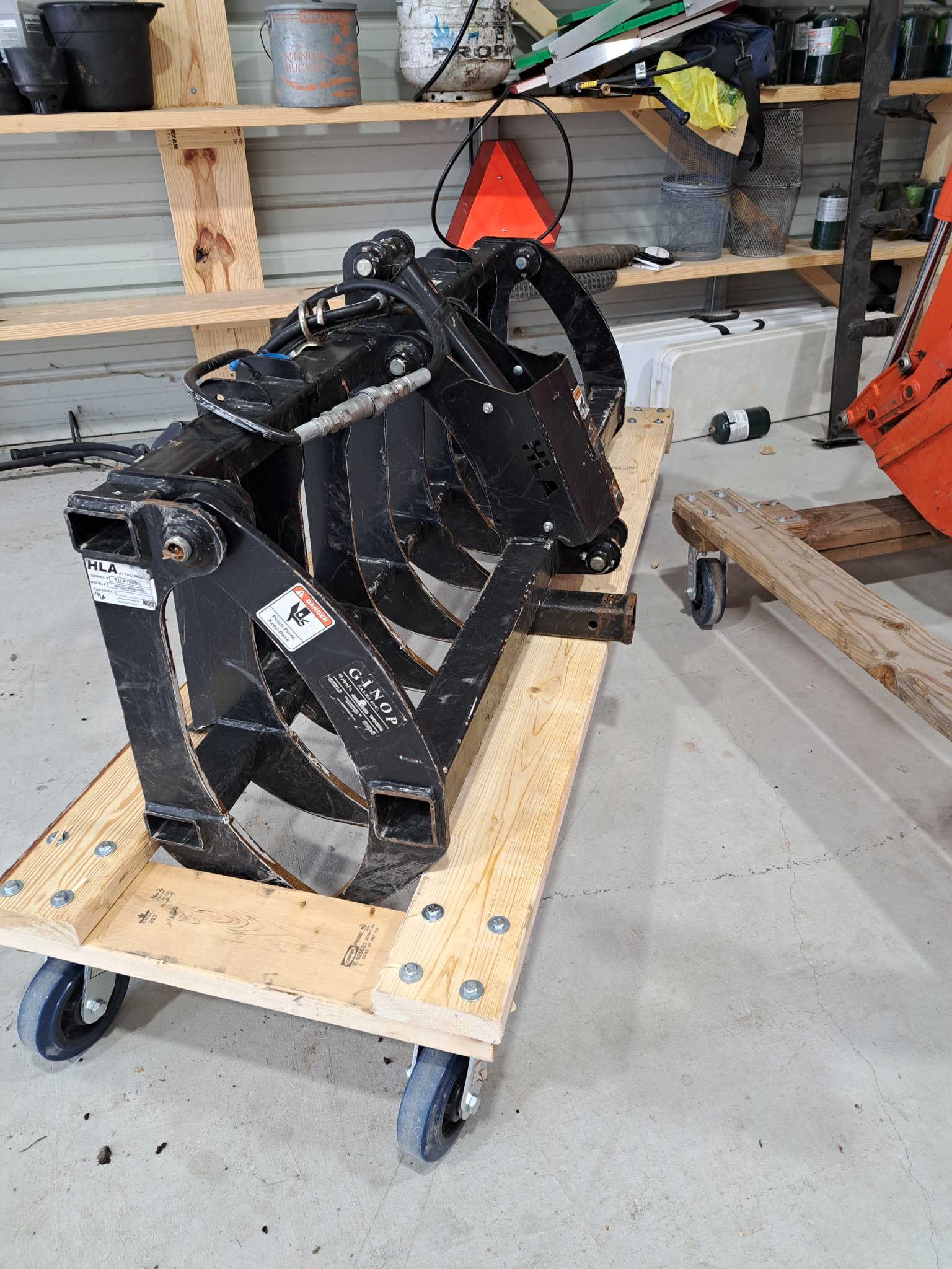

I don't like my current dolly/cart for my grapple. It has always "bugged me" that it always seemed too "top heavy" and just a bit "unstable"
It has never fallen off or anything, but it was always just ....ohhh I dunno..."clumsy"
Then for whatever reason, as I was rolling the tiller by the empty "grapple cart", ....
BAM!!!!!!......
It just hit me. I have no idea why it jumped to my consciousness, it just did.....It was as clear a bell.....kind of eerie actually....
A mental image of those "Russian nesting dolls" came front and center in my mind for some crazy reason.
I knew I had just solved my "clumsy'ness" problem.
To Home Depot!!!!!!!!!!!
I was off faster than a prom dress.

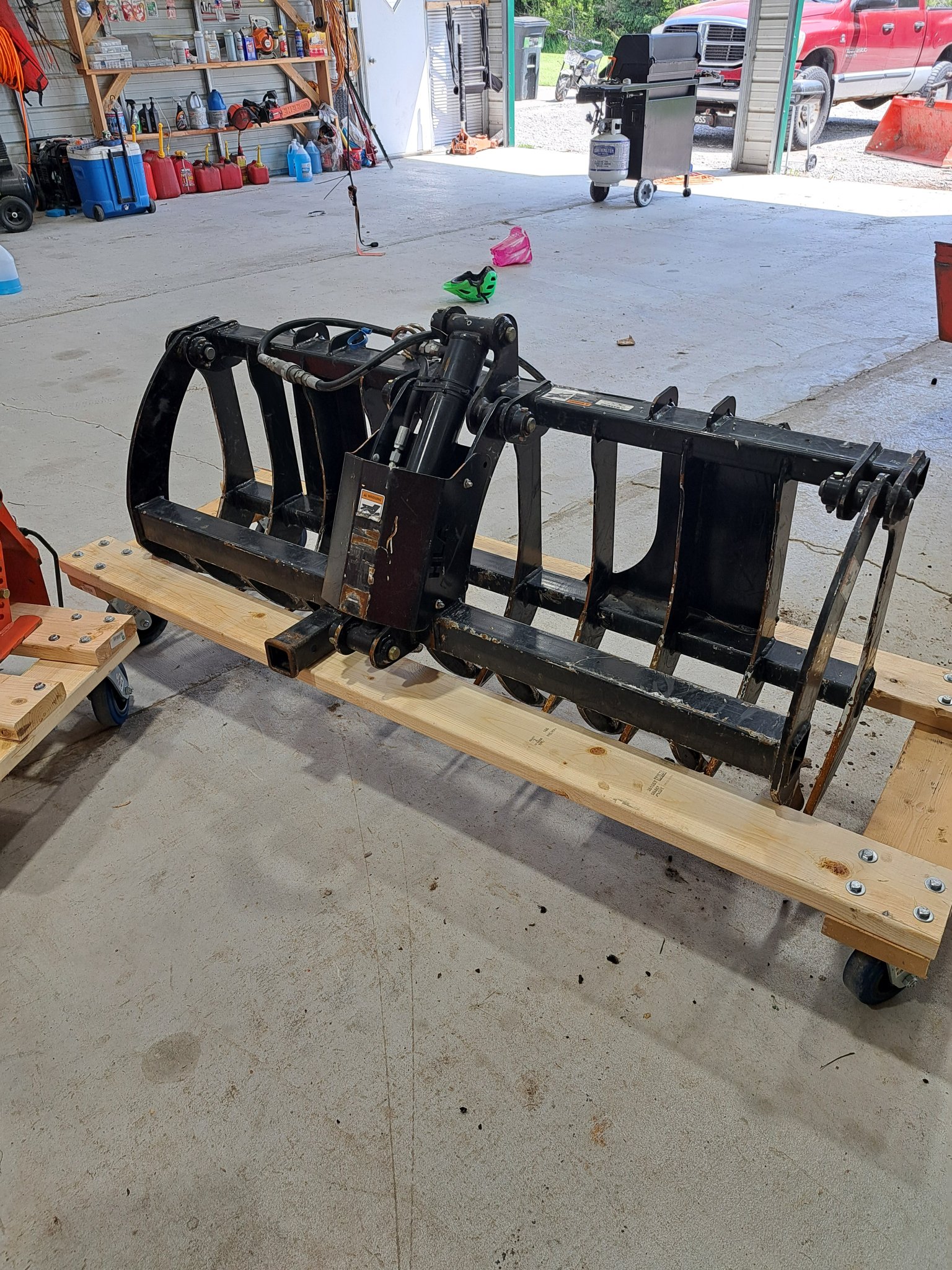

So the idea is to get the grapple to "nest" in the cart to keep the "Center of Gravity" low, which will make the cart/grapple combo super stable, and I want to keep it so the "back" of the grapple is vertical, so grabbing it with the SSQA plate is easy.
I also decided to make it a "wee bit" wider than absolutely necessary, just to have a little "fudge factor" when putting it in.
Her she is ........
a couple of "side boob" shots....
Here is a comparison of the " new width" vs the "old width"
Not a Yuge victory, but I'll take it.

Nice job. What keeps your tiller from rolling off the back Of the dolly? Mine rolls off the back of my skid if I put the skid shoes in blocks so not sitting on the tines. And to use the kickstand on the front it needs to be sitting down on the tines. Anyway I am curious how you keep it from rolling back any further?
3,362
4,286
I have the same problem.
That tiller is very cumbersome.
Right now it's just "balancing".
I don't have a solution for the tiller..........yet!
GrumpyFarmer
3,213
4,447
Same here…I get it set to balance and then If you bump it trying to step around it sort of scares the shit out of you when you remember in flip flops…then forget what came to the barn to grab real quick.
I hope to have a dolly made by fall that I make blocks that fit the skid shoes and then there will be another block to go under the kick stand. Right or wrong I am going to try to make it so the tiller sits at height where parallel PTO shaft…in mine it sure seems to help for the PTO shaft to be level for hook up. Anyway it’s on my list.

Maybe pull the center support off so the tiller sits in the hollow, then build a small brace on the hookup side of the tiller so when you roll the cart under the tiller from the side the brace is just below the hookup and supports the tiller so it doesn't rotate.
