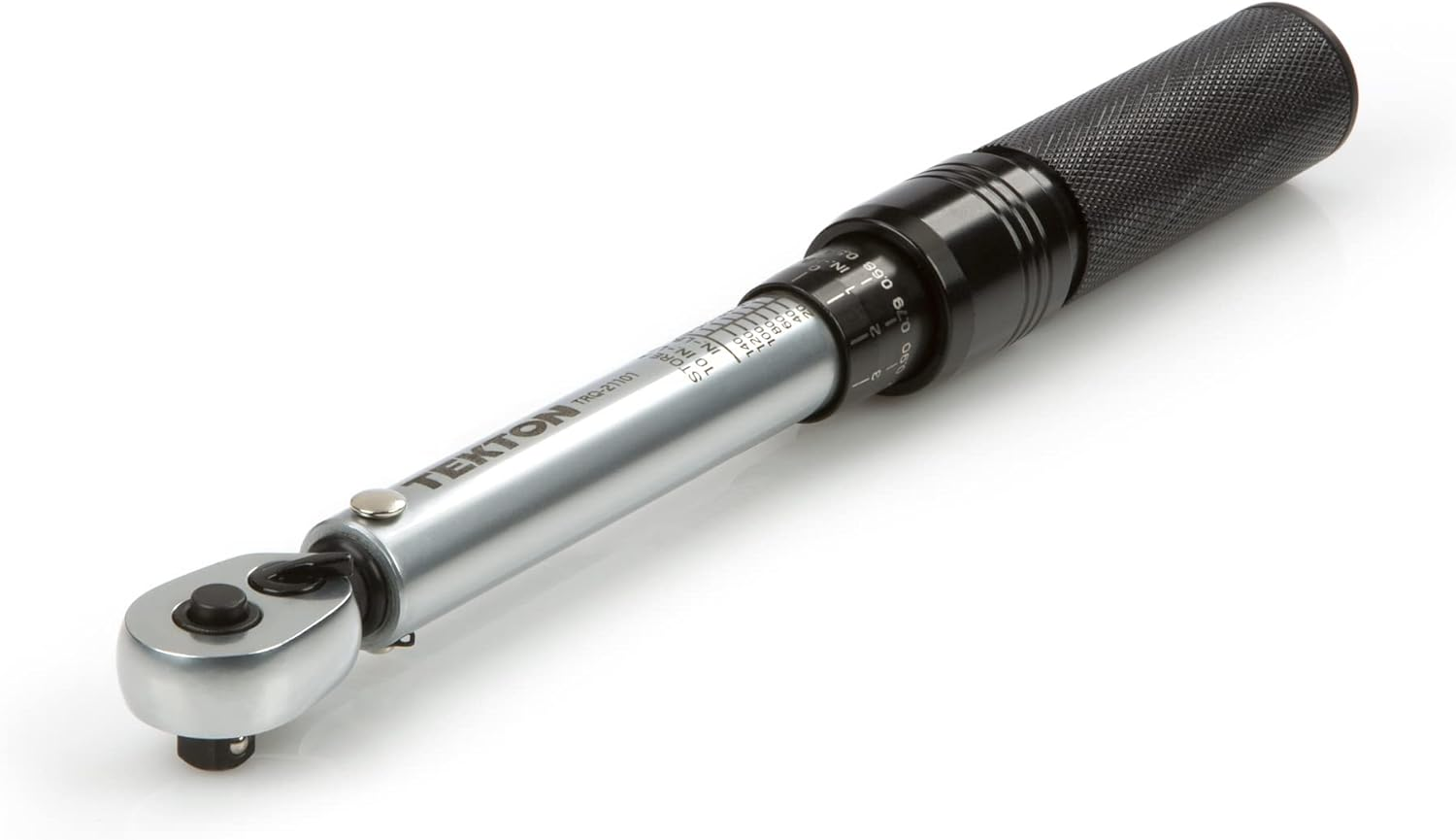

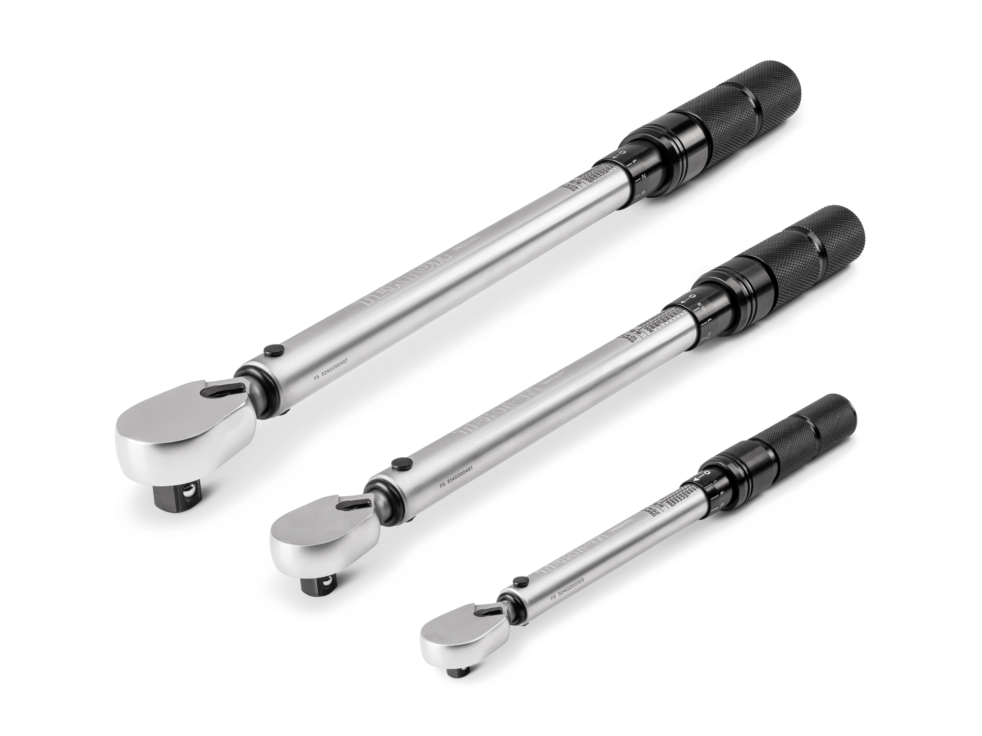

I think you're right. It's not about accuracy for me since most decent torque wrenches will be accurate enough for most of us not assembling aircraft, race cars, satellites and such. It's really about the convenience, and I thought about how often I need to use a torque wrench, and when using it, how often do I need to change torque values or torque a bolt to a value and then turn it 90° or similar. I had to torque 24 or so valve cover bolts on the F-250 recently, but that's a case of set the value, torque the bolts and done. It's lug nuts that I need to torque more than anything. With the Jeep, F-250 and F-450 their are a lot of lug nuts to deal with. The F-450 has 40 of them!
I've come to the conclusion that since I'm not using a torque wrench enough it's just not worth the cost for an electronic variant. As nice as they are, I don't really need to store presets, and rarely need to deal with angles that I couldn't accomplish by eye. I have no interest in cheap tools from places like Harbor Freight and will happily pay more for a quality tool made in the USA or a country like Taiwan, so a set of three TEKTON micrometer torque wrenches for $290 will do just fine.

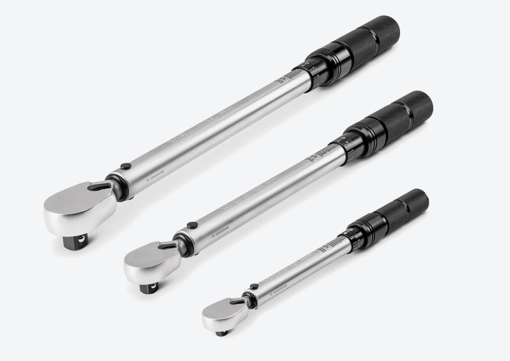

Perhaps later in the year I'll buy a fancy TEKTON electronic torque wrench, but for now I'll make do with these models that appear to be a nice upgrade over the Craftsman ones that I've been using for decades. The Craftsman wrenches all have plastic handles, and the 1/4" and 3/8" drive ones have plastic lock rings. Not exactly exuding quality. This set of TEKTON torque wrenches look like good quality, and based on the other TEKTON tools I have I doubt I'll be disappointed. I like that each one comes in a hard case too.

Tekton is fine as well as most name brand tools. CDI is also a great option as they actually build the torque wrenches for many big name brands.

Those double lever torque wrenches can be problematic due to the release mechanism used. Also release torque depends on where you hold it with your hand. A colleague of mine was calibrating torque wrenches in the army. He said this type was often out by over 30% after one year. The only ones that were accurate after one year (within spec.) were the Rahsol (now Gedore) Drehmometer type.
And no, I do not agree to the general statement that digital torque wrenches are not more accurate than mechanical ones. The manufacturers specification sheet will tell you about accuracy. You find poor and good accuracy in both designs.

I ordered the TEKTON 3-wrench set shown above since I do need some decent torque wrenches ASAP.

And no, I do not agree to the general statement that digital torque wrenches are not more accurate than mechanical ones. The manuafacturers specification sheet will tell you about accuracy. You find poor and good accuracy in both designs.
The TEKTON 1/2" drive electronic torque wrench claims an accuracy of ±2% CW/CCW, and both of the micrometer style 1/2" drive torque wrenches claim an accuracy of ±3% CW/CCW. So given the example of tightening the F-250 lug nuts which have a factory spec of 150 lb-ft to 165 lb-ft, if I set either wrench to 158 lb-ft, the resulting torque should in theory be:
Electronic torque wrench: 154.8 ~ 161.2 lb-ft
Micrometer torque wrench: 153.2 ~ 162.8 lb-ft
This assumes rounding up the 1% error (of 158 lb-ft) to 1.6 lb-ft, and both wrenches would provide a final torque value that falls within the factory spec.

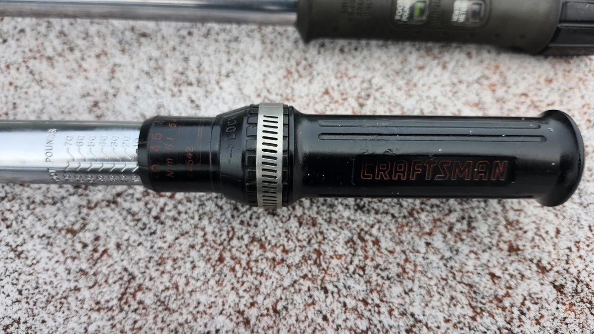

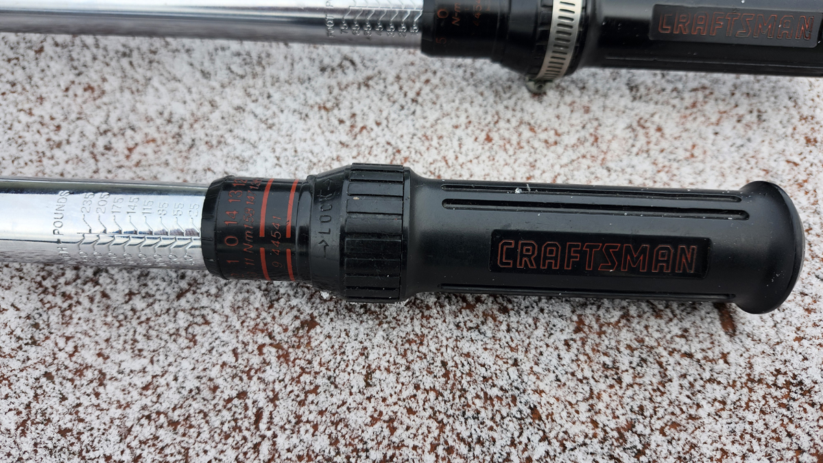

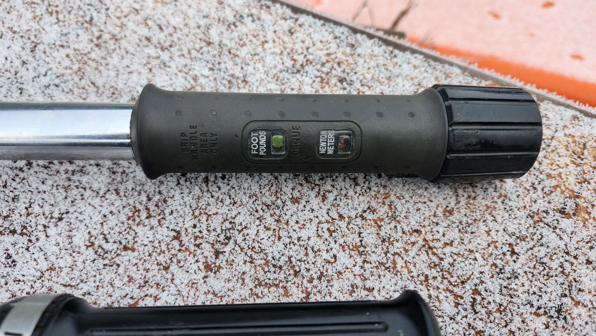

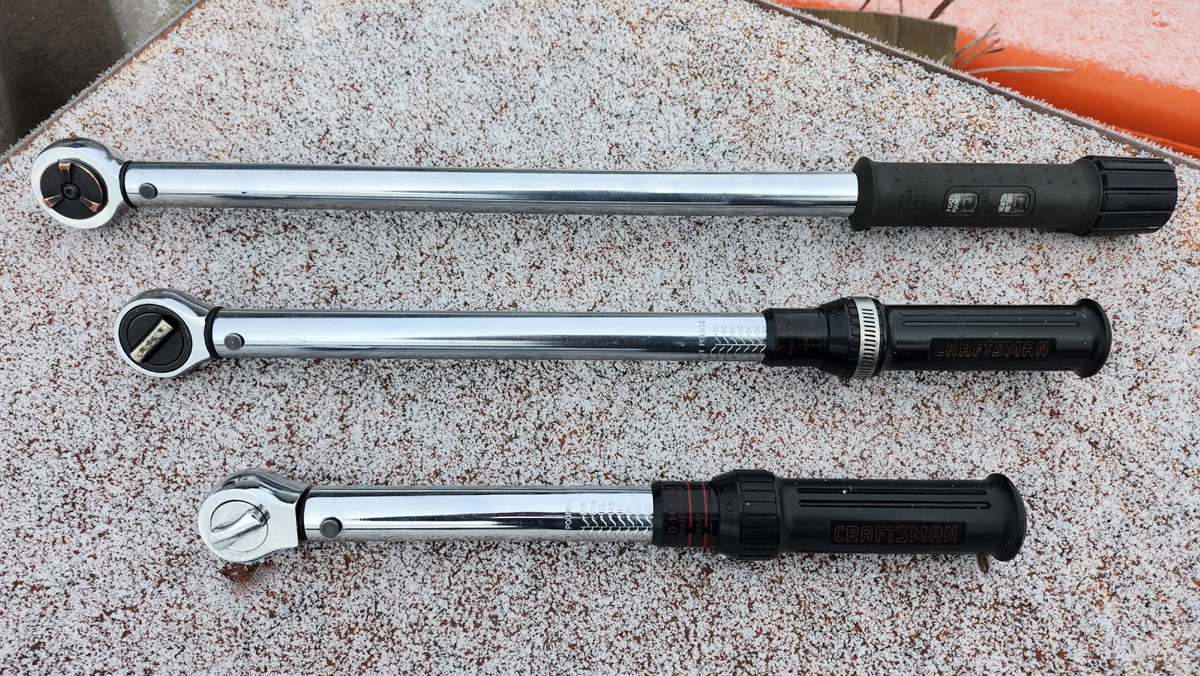

Here are some photos of the three torque wrenches that I've had for decades. I've taken care of them and am always diligent about backing them off to their storage settings. I don't use them to remove fasteners or use them as a hammer. I've got a lot of use out of them over the years so I'm not complaining.
From top to bottom: 1/2" drive (lb-ft), 3/8" drive (lb-ft) and 1/4" drive (lb-in).
My Craftsman wrenches like the one in your 2nd photo has been VERY accurate over the years. I check them occasionally using Olympic plates.
It's been a good torque wrench but the ratchet system broke. No doubt I can find a repair kit, and I have a number of other older Craftsman ratchet wrenches to fix too. The broken drawer is filling up fast.

I have that type of Craftsman 1/2" (with the windows for Socialist and Freedom units), and "highly dislike" it because the rubber grip moves and therefore so do the windows.
