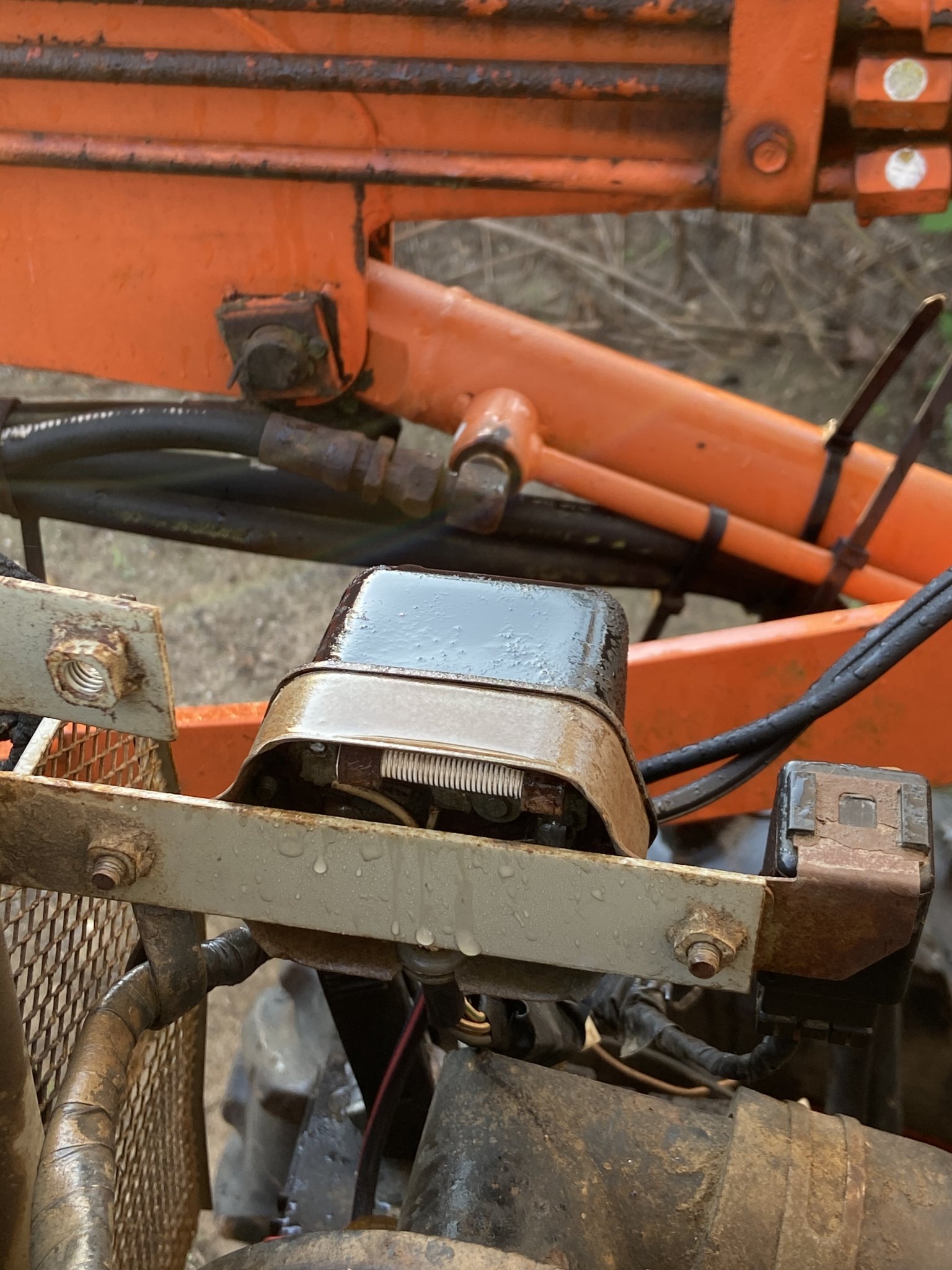

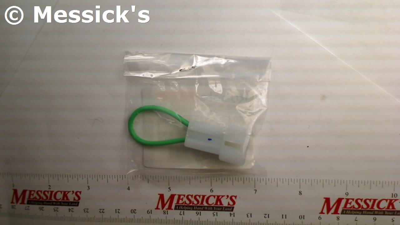

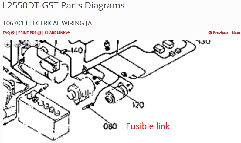

Your tractor has a 40 amp fusible link located near the starter. A fusible link is like a fuse. Blow it and all circuits are dead.

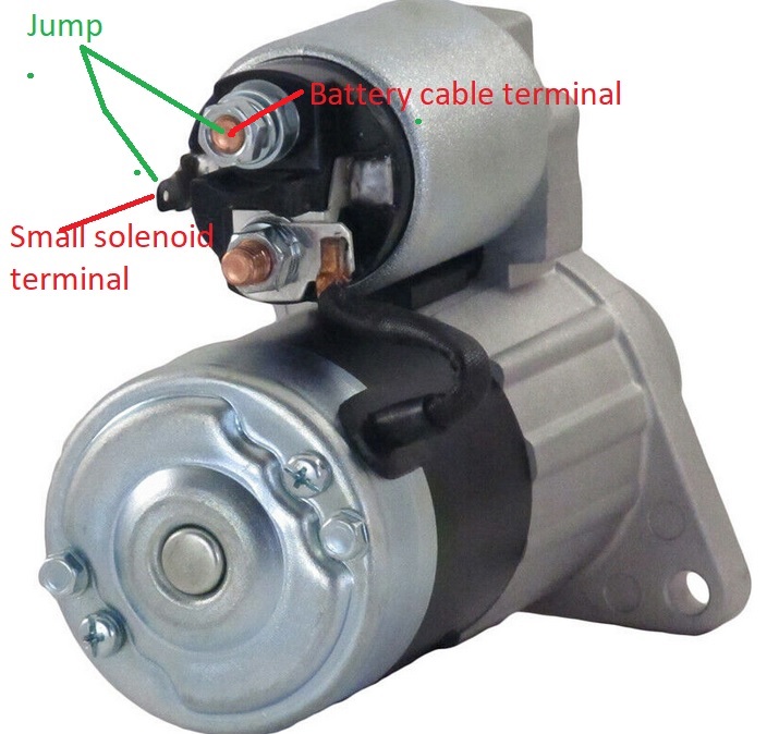

I suspect if you are jumping the starter and it just spins you are not jumping the proper terminals

Thank you Dave for the picture- yes I am jumping wrong terminals.

The link may not be blown but perhaps the connections surrounding it are so poor that there is no power going to the key switch.
Just to be certain you understand about these links. The loop of wire is not just any old wire but rather a small diameter wire surrounded by an insulation which will char but stay in place after the small wire burns through. The idea of the special insulation is to prevent the power end of the burned through wire from shorting against anything. Newer tractors utilize a SLOW BLOW fuse in the same location. The slow blow concept is for a fuse which can stand a momentary overload without blowing. The fusible link is just the old version of the same design need.
