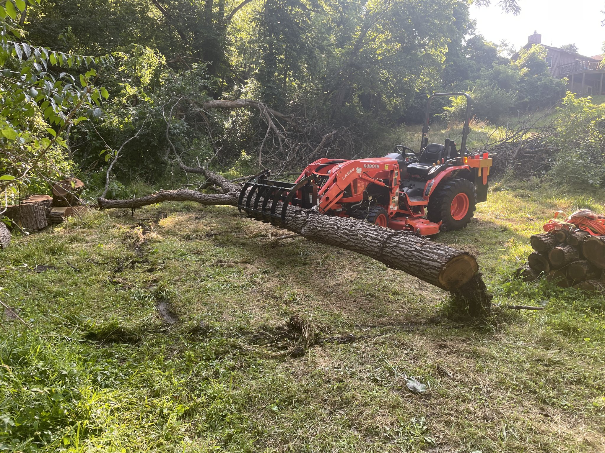

I'm not sure how much my rambling will help. My usage sounds similar to yours. Mostly, I'm carrying saplings I cut down to dump. The other day, I cut a couple of 8-10" pines that were encroaching on a trail and needed to clear them off the road. And the power company did ROW maintenance which left small trees and branches to clean up.
I have a Landpride SGC1060, which is a claw style. Landpride also makes the root style, as well as various other styles. They also make different grades, like they do with other implements. I was on the border between the 0660 and the 1060, which weighs just under 400 pounds. I think the 0660 would have been sufficient, but went heavier to make sure. One advantage it has is the tines are closer together so I think I could pick up and place rip-rap if I need to.
To use the claw style, I roll the grapple down and then start closing the lid. You really need to lower the grapple, roll it back and close the lid simultaneously. This would be easier with a button on the stick instead of my second stick (and with more practice).
I like that I can rake, forward or backwards, with it. But I could carry more saplings and logs with longer bottom tines.

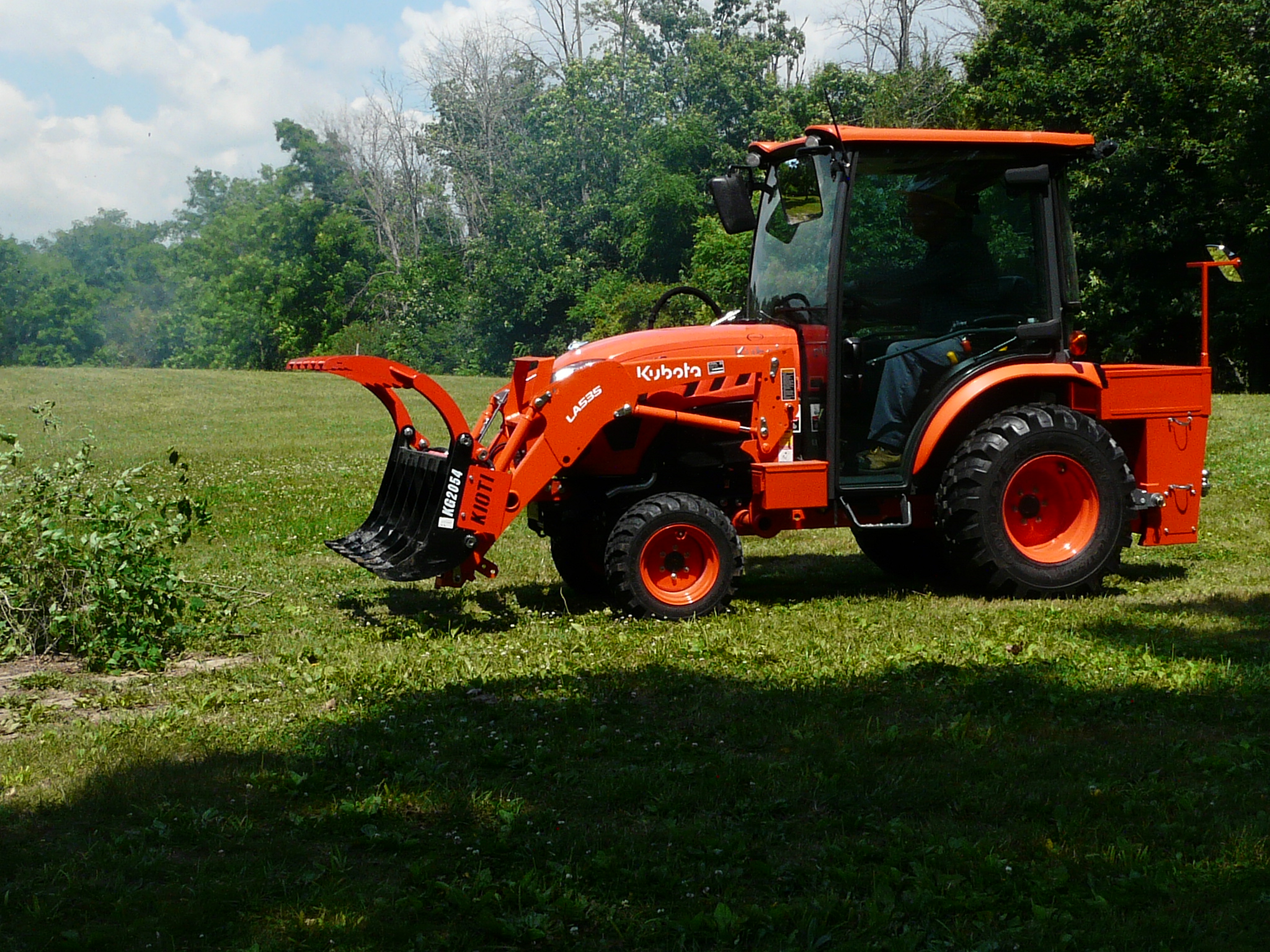

Love the grapple that I bought last year. Works great as a rake as well as picking up logs and brush. Kioti model KG2054. $2200 Canadian loonies up here. Considerably less than any other grapples that I looked at yet built very sturdy.

I have had no issues with it. Tines are properly gusseted and have even picked up heavy bolders.

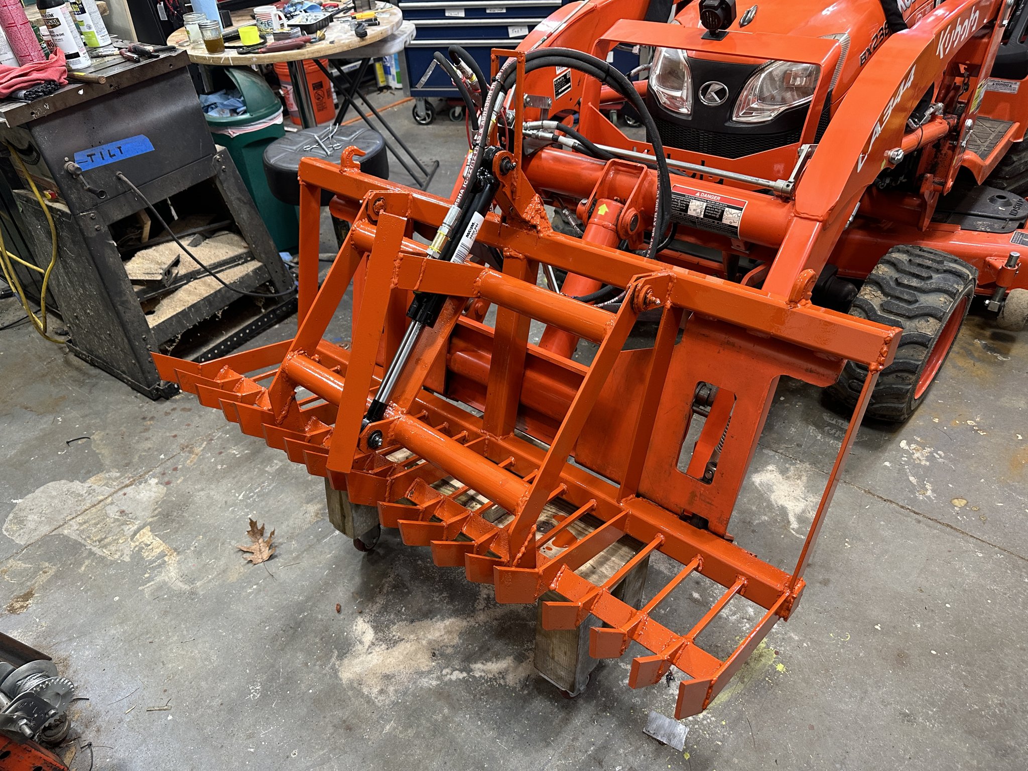

I have a BX, so needed lightweight. What I found was heavy, expensive and back ordered. So, I built this one out of 1/4” mild steel. It’s a bit of a rock bucket and grapple both. Bend it occasionally and 10# hammer fixes it up. Weighs 156#. Great for logs and brush without dismounting. A larger opening might be nice, but my hydraulic geometry prevented. I may shorten the top tynes as they overlap a litte. LP 3rd function is great. Hard to go wrong Whatever you pick.
