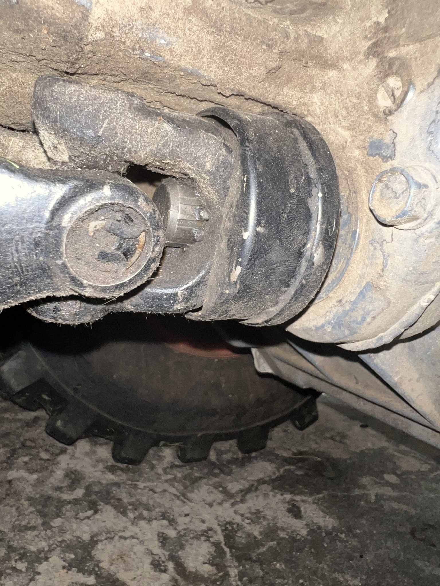

I can't tell if it's from the deck or the PTO. Mows OK but it is LOUD to the point of pain. Deck has fresh oil in the gear box all fittings are lubed. I did have a bad time installing the drive shaft, seems tight. Some of the PTO shaft spline is protruding out of the yoke, is that normal?

Some of the PTO shat spline is protruding out of the yoke, is that normal?

Are the splines showing on the tractor side (meaning yoke isn't on very far), or are the splines showing inside the U-Joint (meaning it could be on too far)?
I'm with hagrid, more likely a spindle, belt or belt pulley. But good to start here, as a problem here can be a major expense to fix and can cause major damage in a short time.....
This is my BX2360 mid-PTO connection. You can just see some spline inside the U-joint. Again, not likely same tractor or mower.

Yes, I just hooked the deck up, my spline protrusion looks about the same, perhaps a little shorter, could be the angle of the pic though.I did not hear any change in pitch lift high or low. Since I installed the DS, which was a pita, I've not been able to remove it...seems stuck.
I had to use a mallet to get it started. Aside from the awful noise of this whine, deck seems to cut very well. None of my other mowers are this LOUD!!! trust me, this is bad, my nearby neighbor 500 yards away
