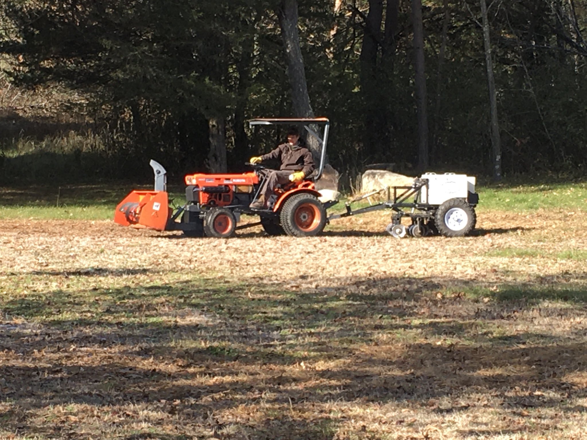

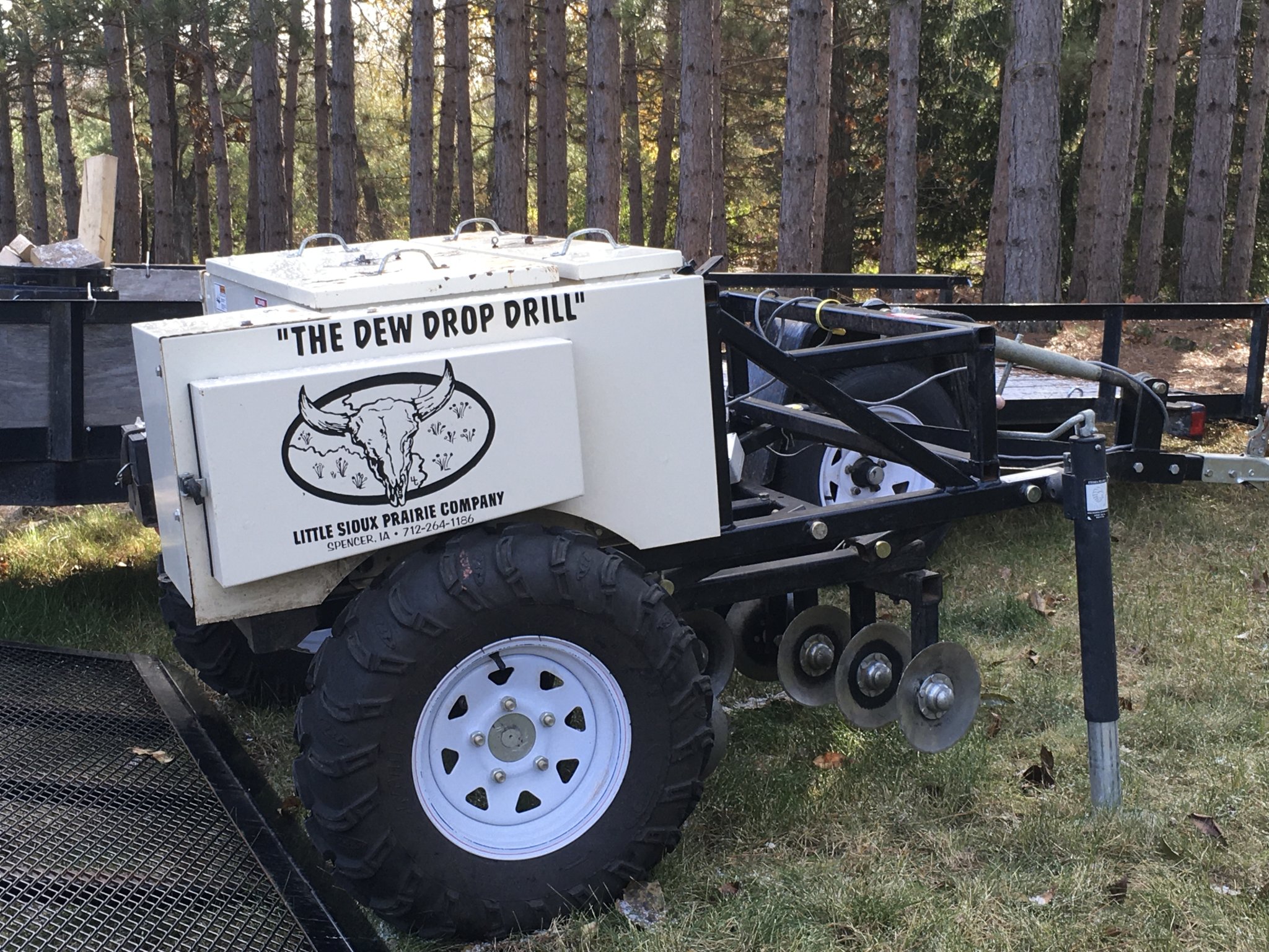

You might want to reach out to your local Pheasants forever, DU chapter or other local conservation type organization to see if they own a smaller seeder. My local Pheasants Forever owns a small 4 foot drill type seeder that could be pulled even with an ATV. Just a thought.
View attachment 94952 View attachment 94951
These are nice but at $8500 they are quite rich for my blood.

I was suggesting that perhaps one of the Op’s local habitat organizations may have one to lend. I used this one and made a small donation to the local Pheasants Forever chapter.
