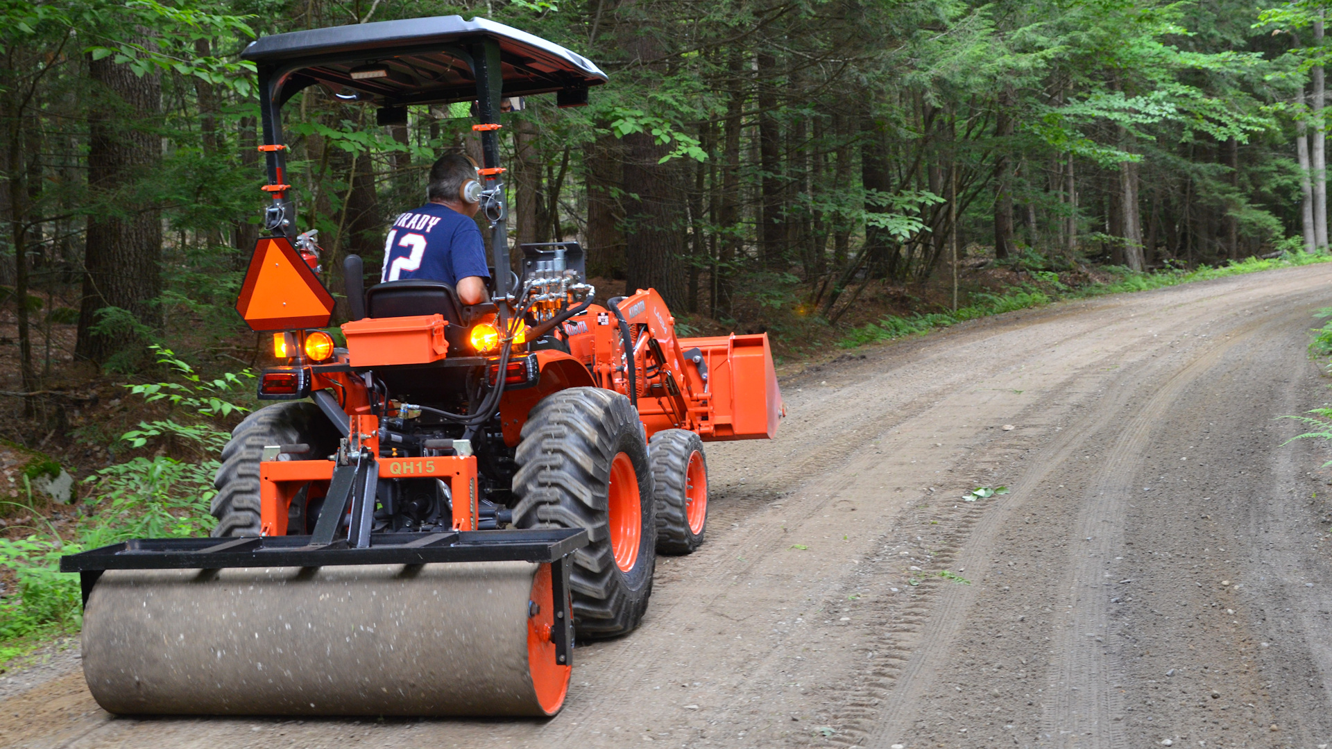

I grade a lot of roads and driveways and a roller will give an initial set to the surface. It is not compacting it down but nesting the loose surface together. I makes a big difference to how long the surface holds up. I know this from doing the same driveways year to year. It makes a big difference.
With the granular rake/blade finish, you never get a full flat surface, the same is true for compacting with your tires. Using the tires only does an ok job compacting but a terrible job for a flat graded surface, you will continue to add new ruts and tire marks.

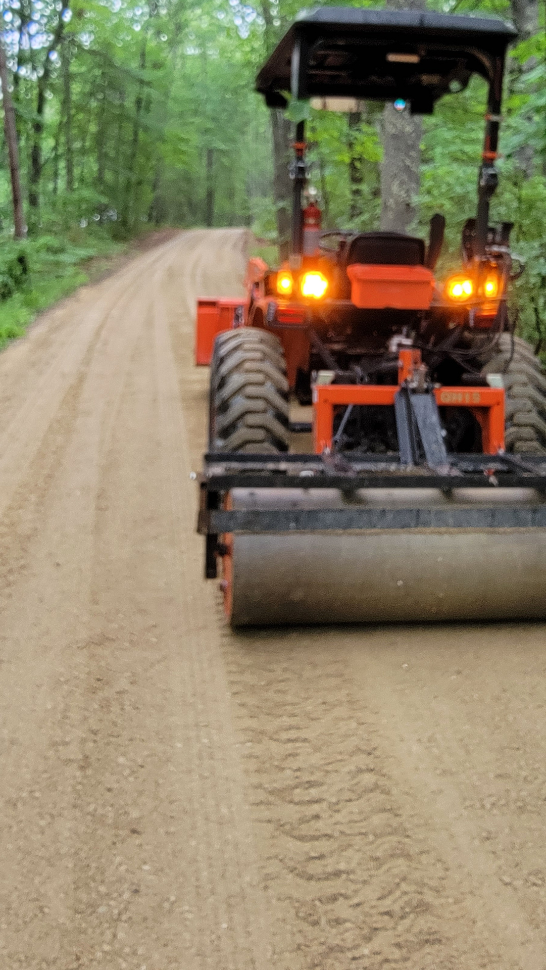

500 pounds empty, 1500 pounds full.
B737
LX3310
Jun 9, 2019
2,022
2,205
I begrudgingly purchased that roller. But I think it is a practical solution to set very soft material the rake leaves behind. Most boring attachment ever! ;)
