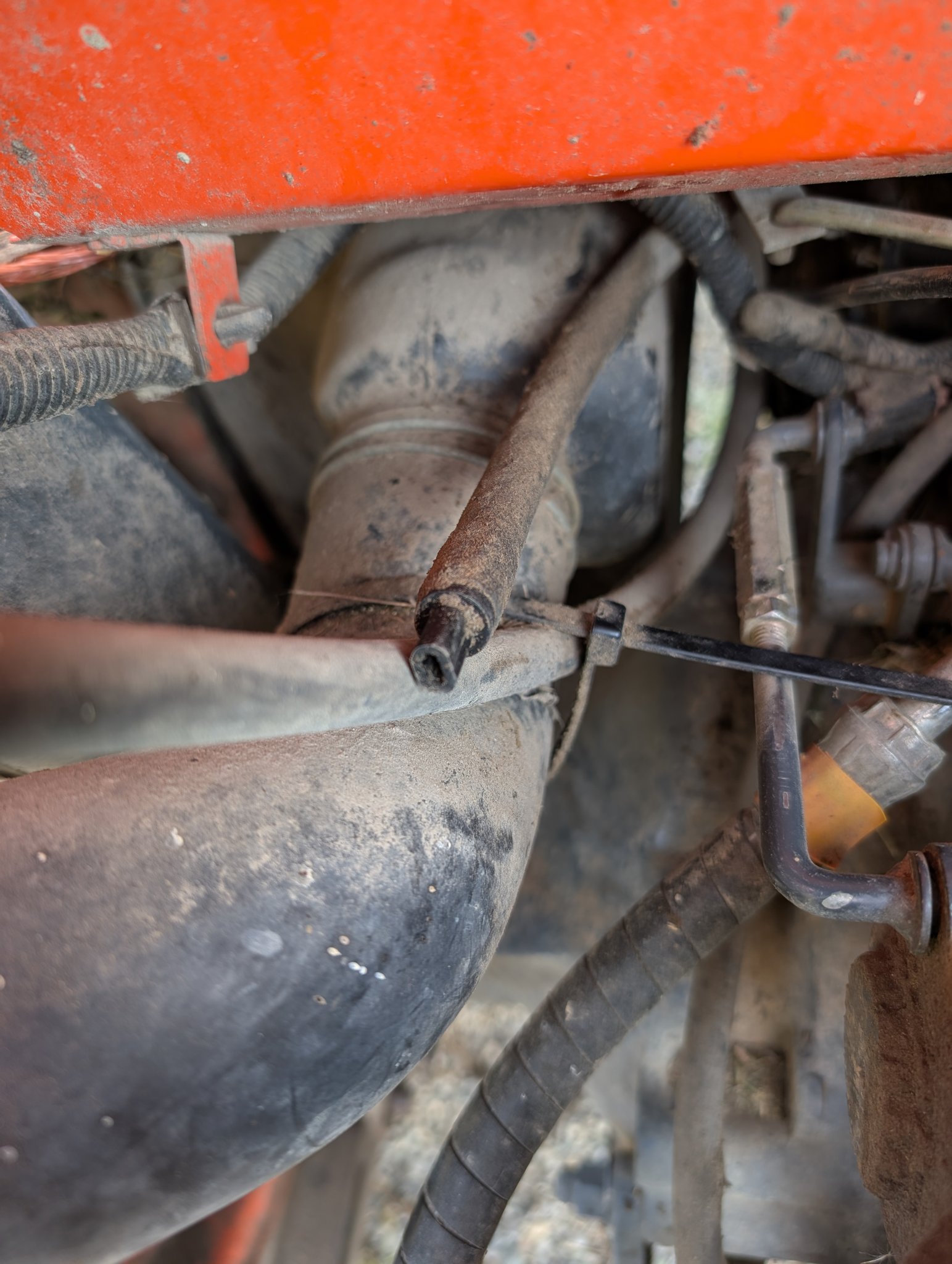

Does anyone recognize this tube that comes out from under the seat?

This tube comes out the back from the seat foundation, next to a tube that splits and goes to both the 3-point-hitch hydraulics.
This connector does not look like it is designed for that type of pressure, maybe but I would expect ribbed? It sort of looks electrical as it looks like it is designed to only be plugged in one way, but it is a liquid tube and no metal connectors on the end so IDK?
As far as we are aware everything is working, but not sure if this should be plugged in somewhere.

That looks like an axle or transmission vent. Maybe a condensate drain for A/C.

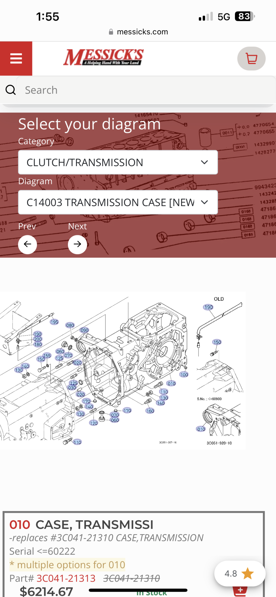

I believe it’s the vent tube from the top of the transmission. I’ll have to look at my M after I get off from work. The end looks exactly like your picture.
Edit. It’s Number 190
