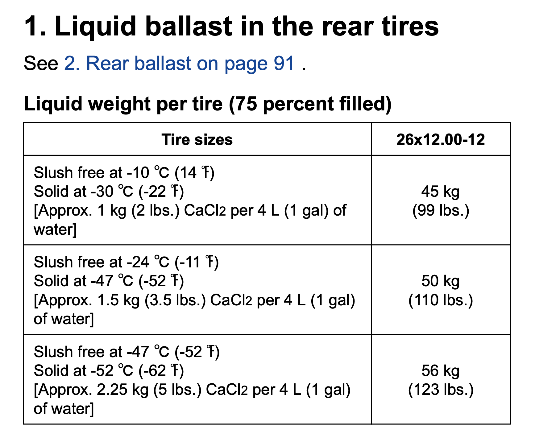

Found this on the BX23S Operator's Manual.

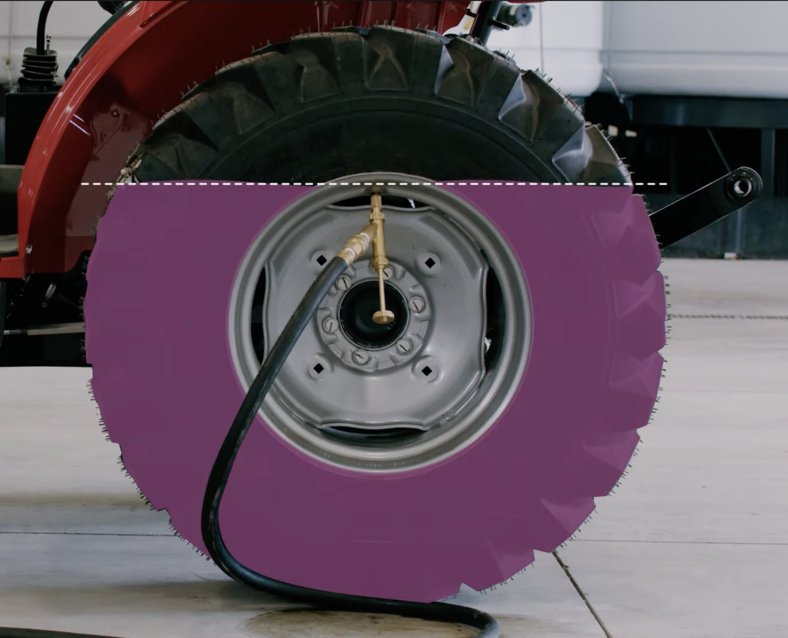

Put the valve stem at the 12 O'clock position, let a little bit of "air" out ... It's normal for a tiny bit of the liquid to come out, but if it continues out, it is "full", if only air comes out ... Roll the tire to the 1 O'clock position, try again until you get a steam of liquid ... Won't tell you how much it weighs, but will tell you where the fill line is ...
Also most "air" pressure gauges, don't like liquid in them ... There are such things as liquid pressure gauges ...
