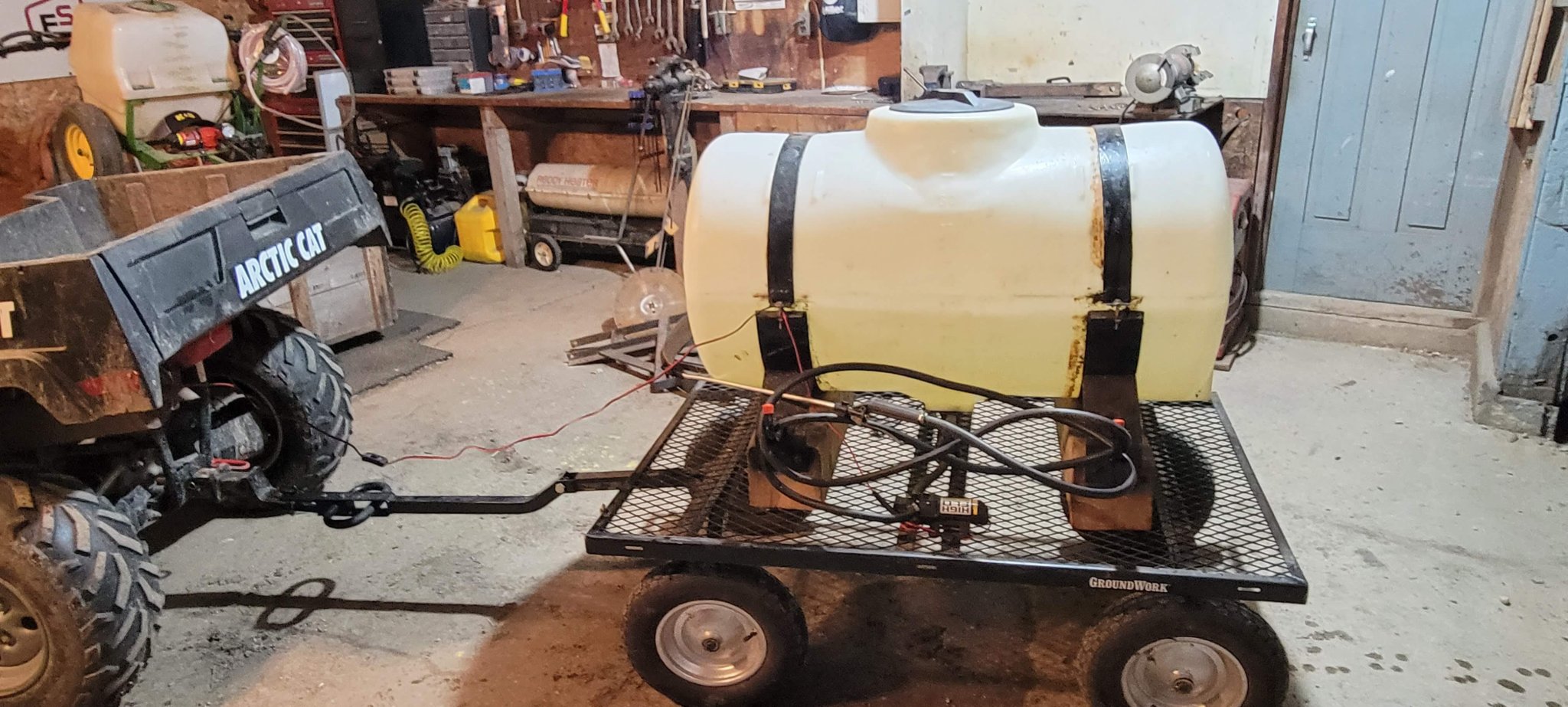

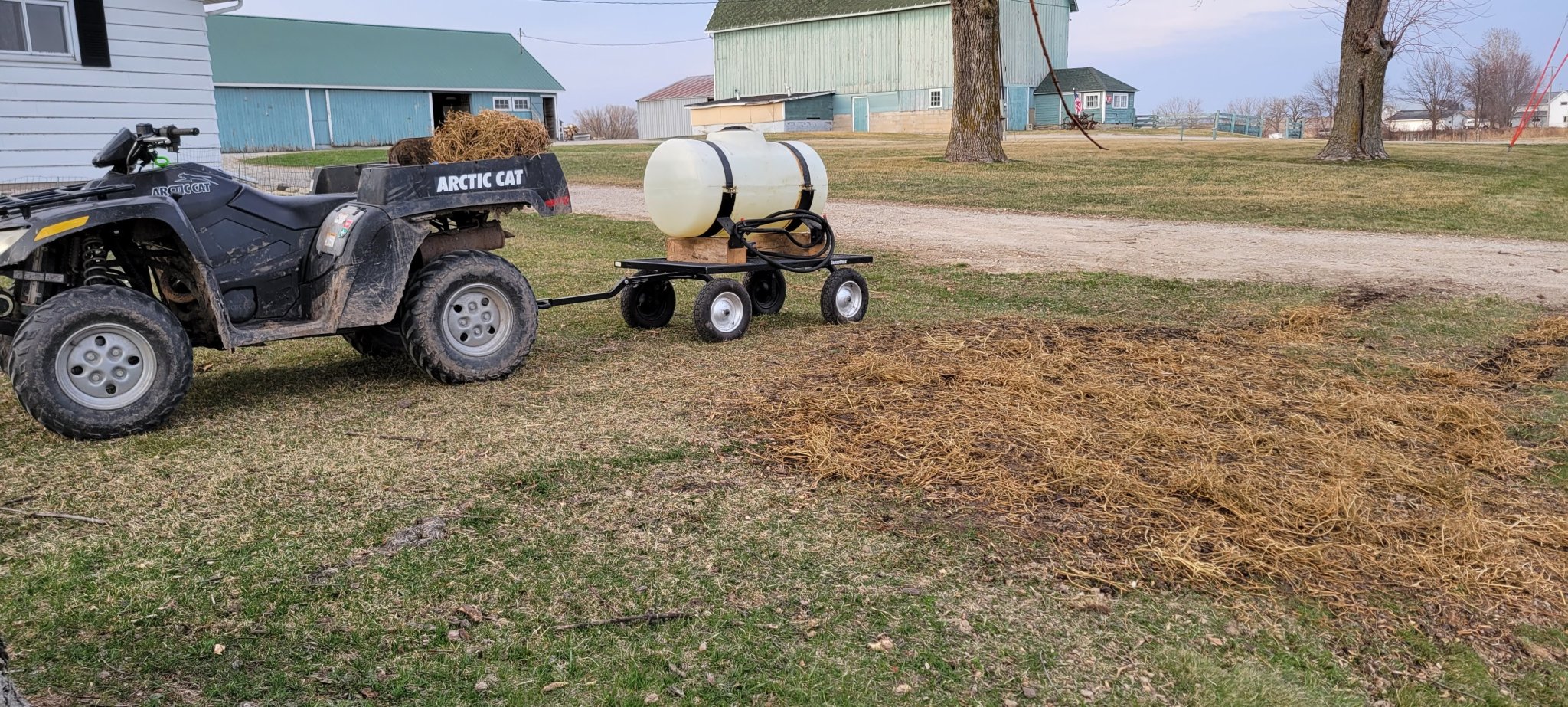

I made a portable water wagon with a spray gun, and a hose to full up a bucket to water grass seed or trees. I have a pump on it that hooks up to the atv battery but it is slooooooooow
For bigger and faster water projects I have a big tote on a hay wagon. Fills up a bucket in seconds.
I found my tank on a consignment auction. Paid 25.00 for 2 tanks with brackets. Sold the extra tank for 75.00 and the bracket for 50.00. I got my big tote from the grain elevator my dad works at.
I highly recommend checking out online consignment farm auctions or stopping to a grain elevator asking if they have any 55 gal drums or square totes.
Also speaking of auctions you can find an old 2 wheel farm sprayer for almost nothing probably won't have a pump and the booms will be twisted but you don't need any of that anyways.

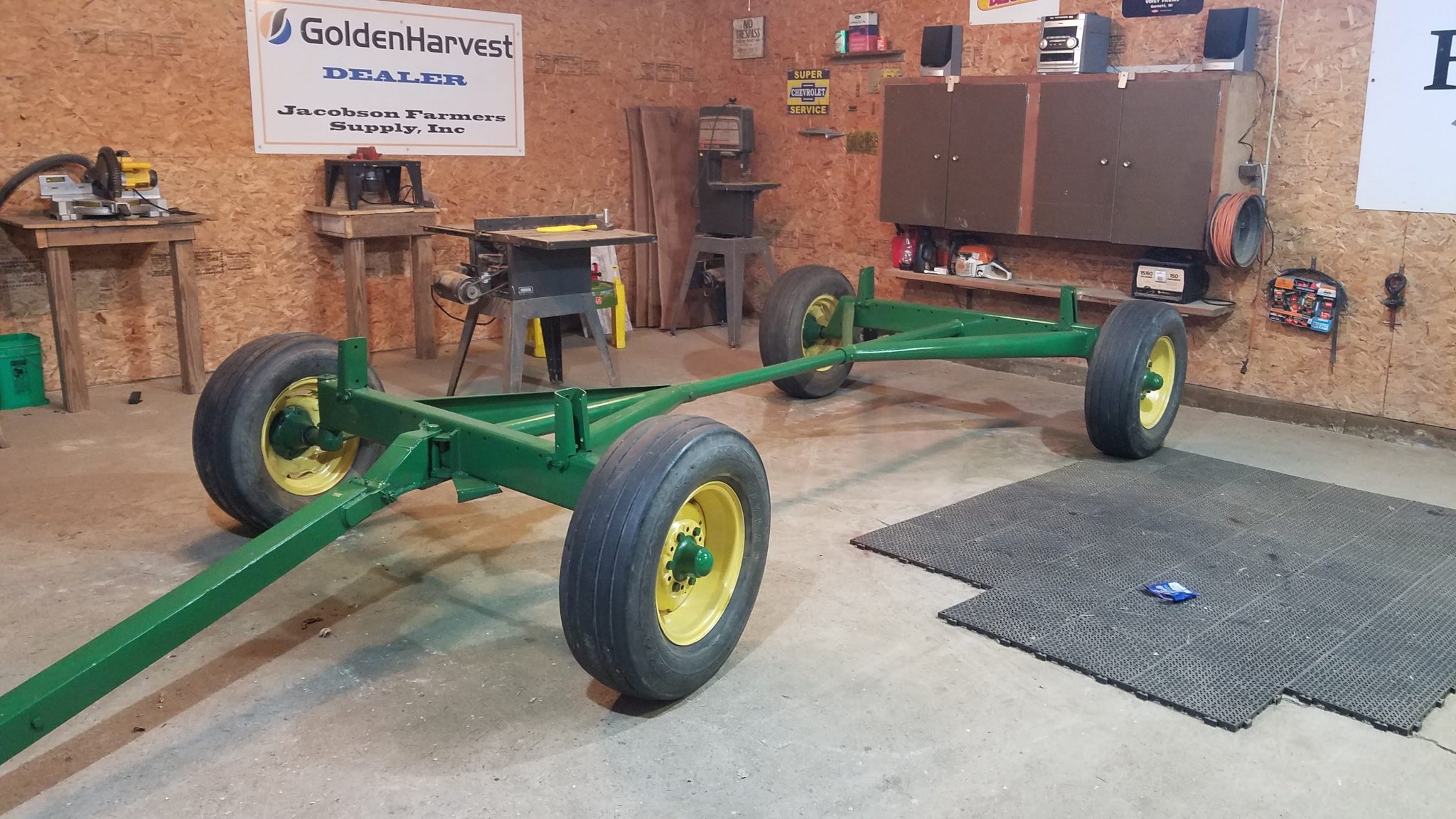

The 'mini farm wagon' chassis you see for $300 are a great deal..had 3 at one time.

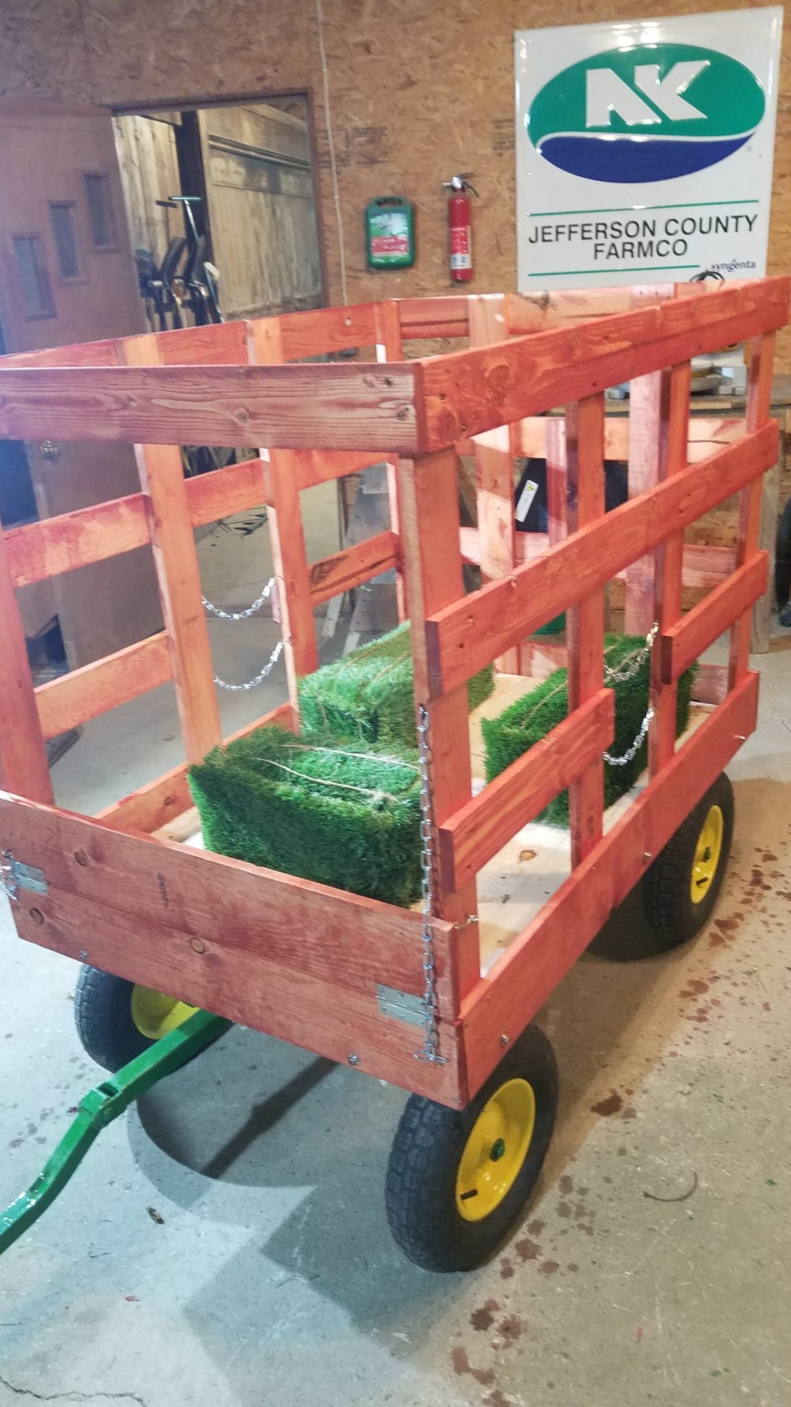

I have 2. 1 for the water tank and 1 I made a mini haywagon to haul the little family members around during get together.
Rated at 1500lbs. It's a pretty versatile wagon and many options to build off from.
I bought a farm tuff mini running gear. It too was rated for 1500 lbs. I. Beleive it was 400.00.Taking it out of the box the pieces were flimsy. When it was assembled I stood on it and was bending the frame at 180lbs.......either my scale is way off or the product name is completely opposite of what it actually is.
I returned it and bought a legit 10 ton running gear for 100.00 more.
You can find 5 ton to 8 ton running gears on auctions pretty cheap. I bought one for 100.00. Stopped to a tire shop and was given some low tried truck tires if I had them mounted on the rim. Down the road sold it for 600.00.
