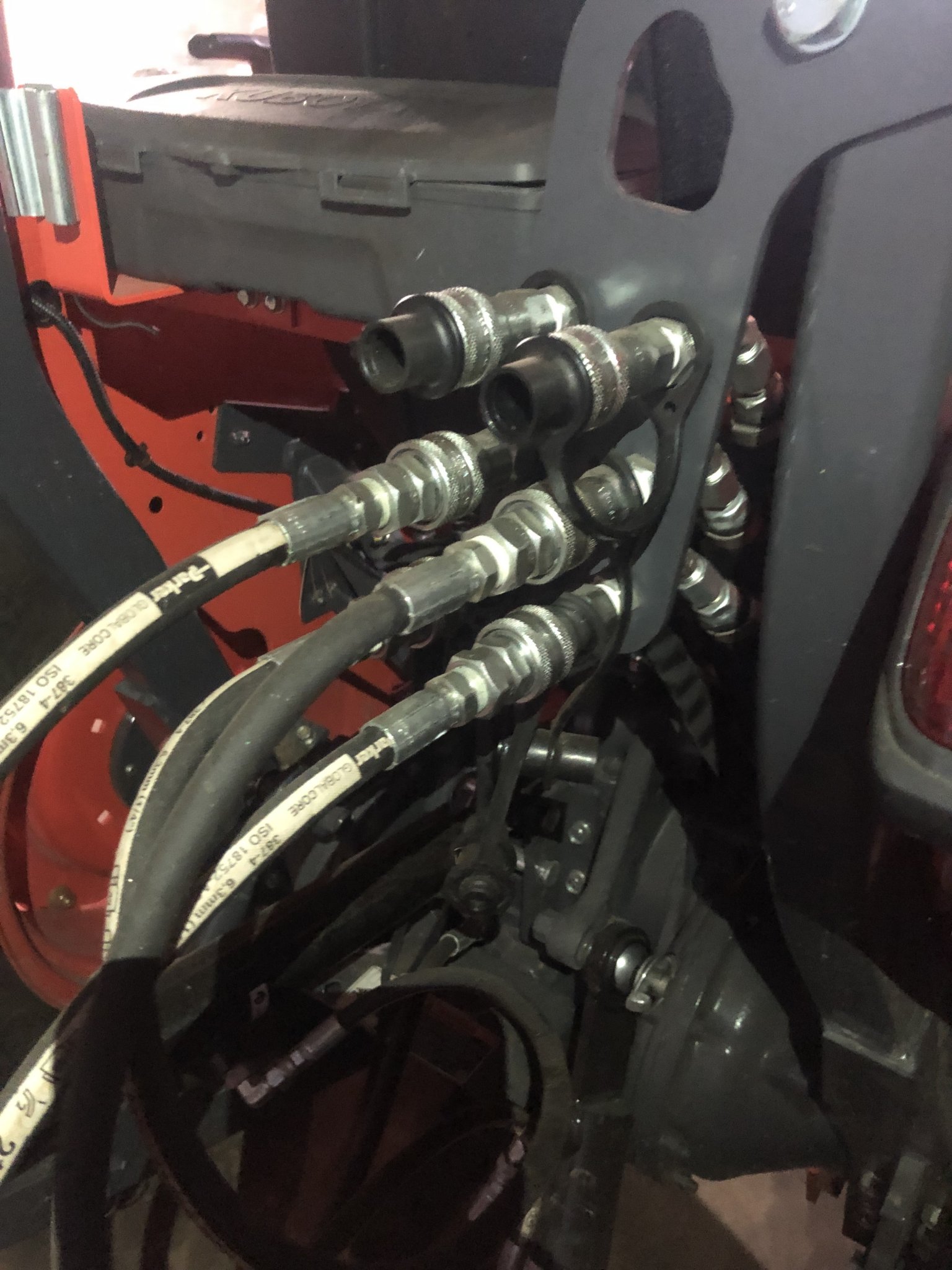

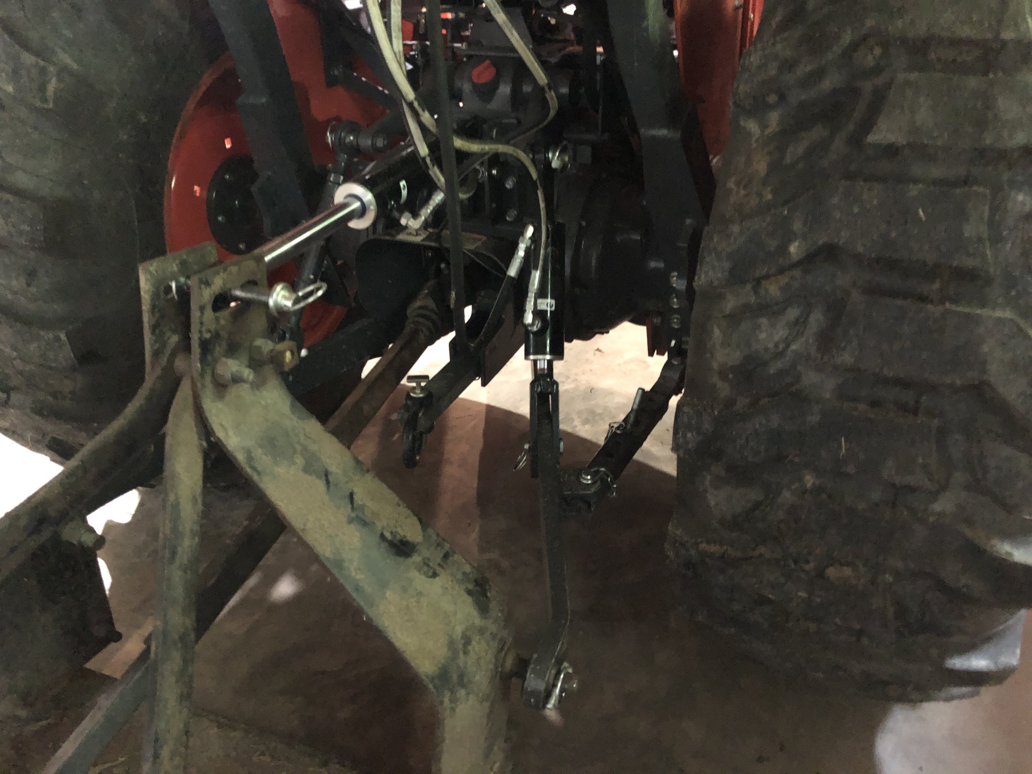

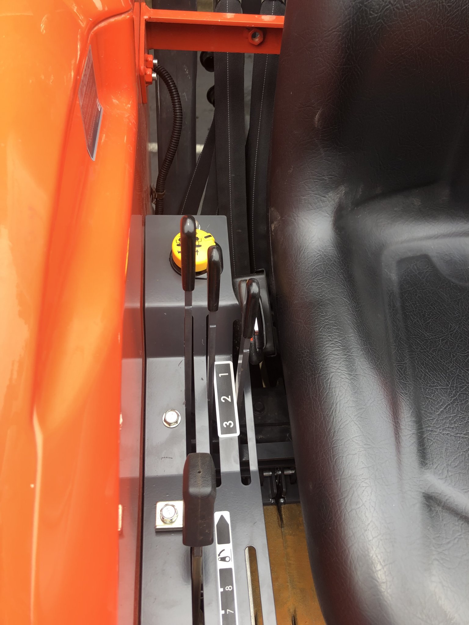

I know nothing useful specific to BX so feel free to stop reading now. I do know hydraulic top link and side link are quite useful for a variety of operations. I also know one of the OEM valves on my L has a float detent. First position had to be center return due to space restrictions. The other two could be center return, float detent, or continuous flow detent. Float and continuous flow were more expensive options. If you go with aftermarket rather than OEM the valves probably won’t mount in the factory slots (assuming you have those on a BX) but you also don’t have the same limits in quantity of remotes or type of remotes available. Hopefully some of those with significant hydraulic expertise will weigh in on viable options.
I find the toplink and sidelink extremely useful for grading work. Angle and tilt changes are a quick wrist flick without leaving the seat and can be done while moving. It’s also helpful for some of the rough area bush hogging I do. Used to crank the toplink all the way in to cross the creek cuts without binding, then crank it back down and remove so it would flex sufficiently, reinstall to mow a few ledges without scalping, crank in again to go home, crank back out to park/disconnect. Even more painful and lengthy to do than it is to read. Now, about 1 second to flip it up for transport, a couple more to gently set it down and push it past the detent to float, pull it back past the detent to hold it up to prevent scalping when the tail wheel is hanging over the ledge, flip it back up to go home. All without leaving the seat or shutting down the tractor. Toplink is also quite useful for loading on a trailer without dragging the rear implement. For grading I’ll often swap the lines to put the float on the sidelink instead of toplink. If you do any significant grading or other 3 point work it’s definitely worth the cost to get the top/tilt setup.
Something like running the chipper or generator, makes no difference whatsoever.

I find the toplink and sidelink extremely useful for grading work. Angle and tilt changes are a quick wrist flick without leaving the seat and can be done while moving. It’s also helpful for some of the rough area bush hogging I do. Used to crank the toplink all the way in to cross the creek cuts without binding, then crank it back down and remove so it would flex sufficiently, reinstall to mow a few ledges without scalping, crank in again to go home, crank back out to park/disconnect. Even more painful and lengthy to do than it is to read. Now, about 1 second to flip it up for transport, a couple more to gently set it down and push it past the detent to float, pull it back past the detent to hold it up to prevent scalping when the tail wheel is hanging over the ledge, flip it back up to go home. All without leaving the seat or shutting down the tractor. Toplink is also quite useful for loading on a trailer without dragging the rear implement. If you do any significant grading or other 3 point work it’s definitely worth the cost to get the top/tilt setup.
Thank you for the pictures and detailed explanation. I am just soaking up as much information right now as I can.
I had been running tractors in various ag, landscaping, firewood production operations for a few decades before getting the Kubota. I didn’t get rear remotes with the initial purchase because: 1) they’re not exactly cheap; 2) I had never run a tractor with hydraulic top/tilt and had no other specific use for rear remotes; 3) when I asked the dealer about cost, it wasn’t any more to do it later than it was to do it with the purchase, so there was no cost benefit doing it up front.
I knew I had some grading projects immediately but thought once those were done, I’d be doing little grading long term. As time went on I realized I was doing touch ups on our roads and trails quite often so I got the remotes and hydraulics for the 3 point about a year after buying the tractor. I had the third remote installed despite not having a specific use for it because the labor was no additional, just part price. Top/tilt would have been awesome for the first push of grading our roads so in that sense I somewhat regret not having it out of the gate. On the other hand, the float detent is useful for me, maybe not so much for others, and I might not have been so insistent on float had I not had some experience grading and bush hogging our place with the turnbuckles for a while.
Point of all that is I love the rear remotes/ top & tilt for what I do now. What I did mostly growing up: plowing, discing, post hole digging, trailer pulling, general carryall; I probably wouldn’t spend the money on them. To me both the remotes and top/tilt are too expensive to get unless you have a use for them and you can add them later if you find a need for them.
If you know you’re going to be boxblading, backblading, landscape raking a good bit I would get them out of the gate. And I would get a float detent again. You can use a float detent like a center return by just never pushing it past the detent, you can make a center return full flow by tying the handle, but you can’t float a center return. If you don’t know what you’ll be using them for, I’d wait on it until you have a reason to do it. Just an opinion…
