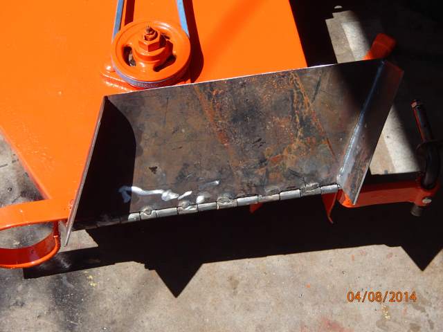

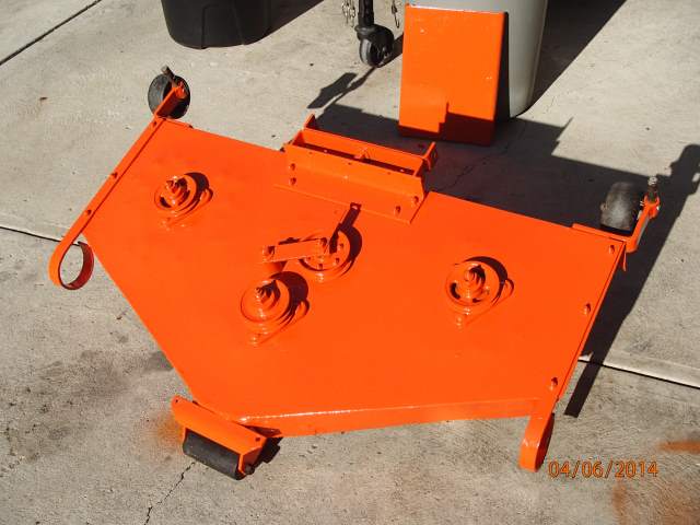

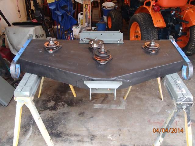

About a year ago I started looking for a older smaller Kubota tractor to mow my small city yard. I found tractors meeting my requirements all had bad mower decks and I resigned myself that I would have to rebuild the the deck. An ad on Craiges list yeilded a B5100 sound but needing lots of TLS and a shot mower deck. These pictures are not intended to walk you thorugh building a new deck just to show what can be done.

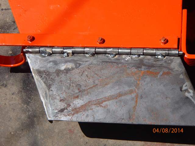

Here's part 2, Notice the output deflector was added after I painted the deck. I tried it out yesterday and other than needing some adjusting of the lift mechanism it worked perfectly. I used 1/8" steel for the deck that I bought and 1.5"x.250" steel cut from some angle iron I had for the skids. The deck is a Kubota B445. I looked at one with a Woods brand deck that looked very similiar.
Next project is the belt guard. Sorry I have not taken pictures of the deck on the tractor yet.
thanks for looking

If I were to have changed the size it would have been smaller. With my folding chute it just fits through the side gate in my yard. I chose the B5100 because of it's smaller size.
Yes I laid the old one on top of the new material to mark all the hole locations:D
